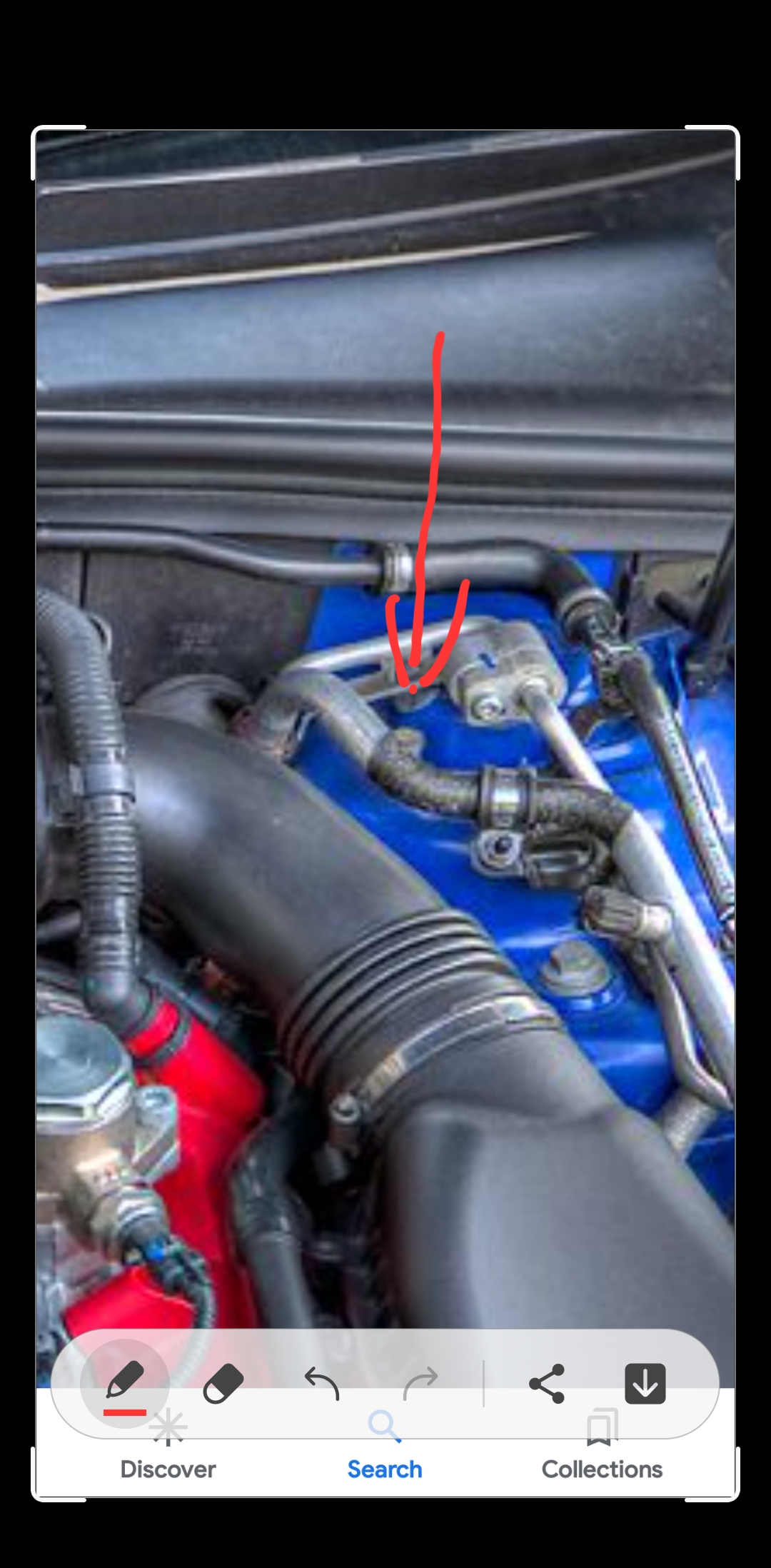

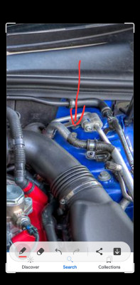

Any chance you can post a picture identifying the negative post on the suspension turret please?

Hope this helps. If you need a clearer picture I'll take a different angle tomorrow.

That’s ideal, thanks. I wasn’t sure if it was the bolt just further south of that.

Any substantial earth point will do such as the strut top mount bolts, but you might as well use the specific post intended for the job!

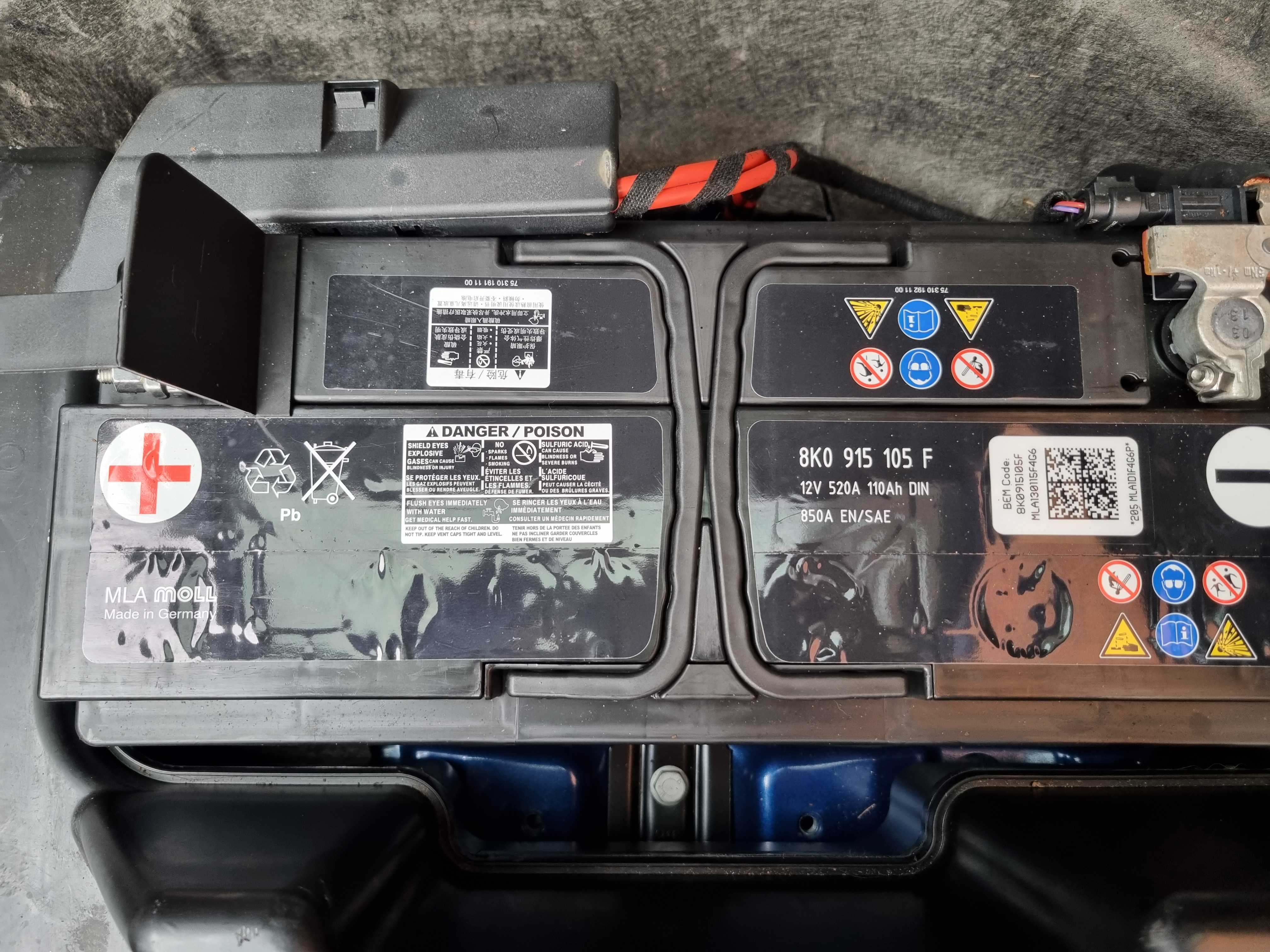

This is my battery. Would you say that AGM? It states lead on it. As far as I can tell the only difference in charging AGM than normal lead is AGM goes to 14.7 volts and lead is 14.2 so doesn't do any harm anyway.

The Ctek MXS 7.0 charger I use on mine has a frost setting for charging in colder temperatures, which is the same setting for AGM batteries, so all in all it probably won't really matter which is used between the standard or AGM setting relative to the amount of the charge rate applied.

AGM batteries are lead acid batteries - its just their construction is different. They don't leak if tipped over, delivery higher power in comparison to standard batteries and can withstand being left in a lower state of charge better, although this is not recommended for any battery. They often state the battery type on the label, such as AGM or EFB.
