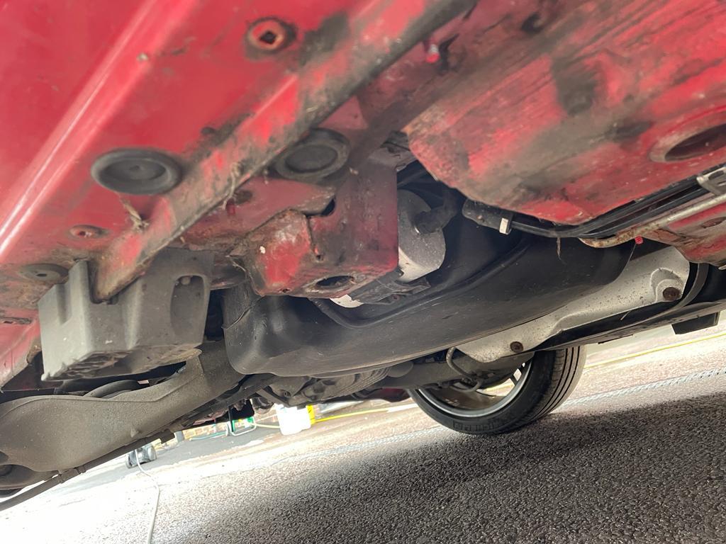

So I've had a look under my car on a few occasions and there's quite a lot of surface corrosion particularly on the subframes and other areas, decided to get my car treated here
https://preserveprotect.co.uk
Dropped it off this morning and hope to get it back Thursday Friday at latest. They send around 60 images of all works carried out, certainly from what I've seen the workshops are well equipped and modern. They steam clean underneath, strip wheels and all plastic panels off the underside and arches, remove all the rust manually, treat it with inhibitor, treat all the welded joints, then do the channels and finally the whole underside of the car.
I've opted for Bronze on the subframes and arches and clear on the base panels. I took some images when I was there a few weeks ago.
Will update as they go.. told him I wanted stage by stage pics, won't be accepting starter images then images of panels covered in body schutz, I can be quite intense when it comes to giving someone money.. so he's under no illusion lol..

https://photos.app.goo.gl/MfGmY75AqBn4M5Zg9
Pretty scruffy underneath

Re: Rustproofing..
I don't think it looks too bad underneath, good to get it done though for added protection.

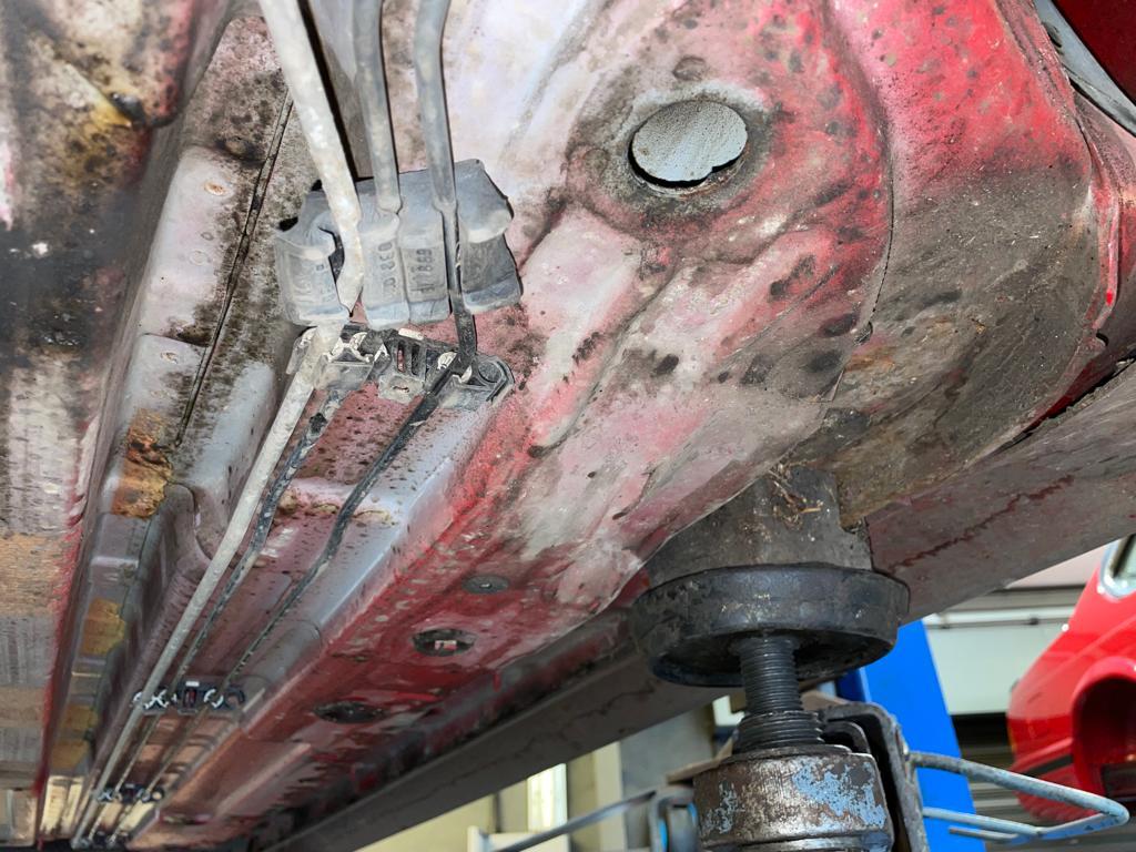

interesting. look s like the b8 is as bad as the b7.
i've got an b7 with lowish miles, but i've used it in all weathers and underneath it was starting to suffer. a year or 3 along from what your seeing, but it looks like the same sort of tradjectory
the work sort of escalated and ended up dropping the suspension, fuel tank to get at the areas where the paint was starting to fail and basically respaying the underside !! of the car. and a lot of the pipework for drc and brakes at the same time.
i wasn't expecting a modern audi to go rusty, but seems they do. and not just in the obvious places like the wheelarches where there is a lot of exposure, but above the fuel tank and so on.
upshot was that no structural work was required, it was caught in time, but a couple more winters and there would of been welding involved.

yes it did look surprisingly ugly.
apparently most cars of this era are suffering like this, when the manufacturers moved from primer/undercoat to a single layer paint. much cheaper but not as long lived.
we'll see a lot of bmw/porsche/audi rotting out, perhaps not as dramatically as merc's did. but still a surprise to me.
i grew up with metros and fords which fizzed in front of you and thought was done with this nonsense.

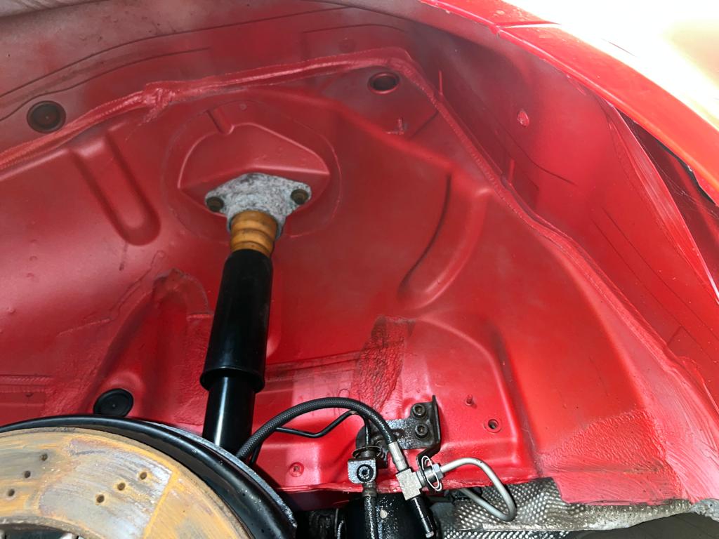

Yes, I'm quite pleased at how it's progressing, I think they are quite thorough.. here's some more images https://photos.app.goo.gl/imxEAB54JFKvdC5u9
And an update today with some of the coating, I have opted for Bronze and Clear https://photos.app.goo.gl/uFpqDj2P5dPoSdeC8
They do a lot of Classics and have a high lift bay for the big campers and tall stuff, pretty organised place if I'm honest, It was way more professional looking than I had anticipated when i booked it online, was pleasantly surprised when I pulled up in my car.. Thant Bronze looks really good actually, what you reckon ?
