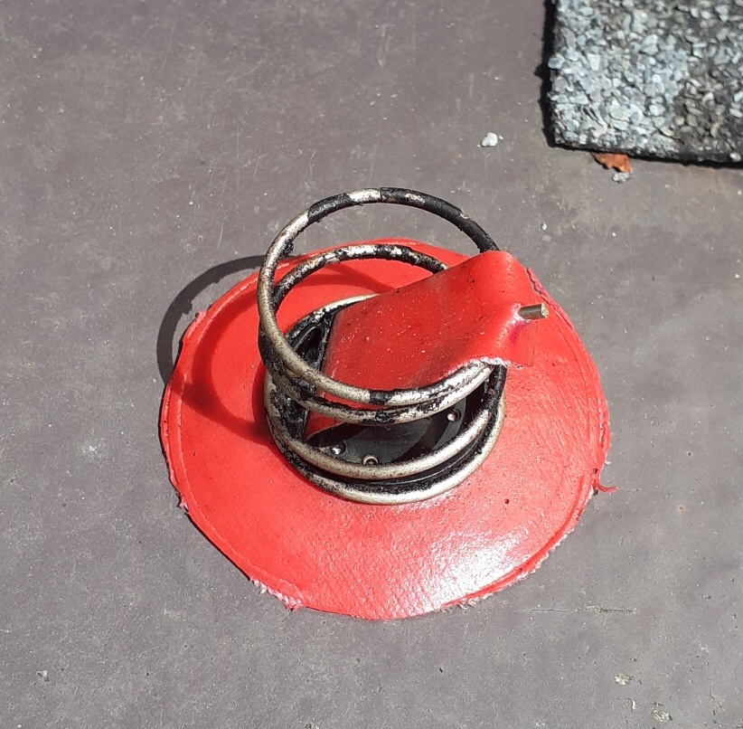

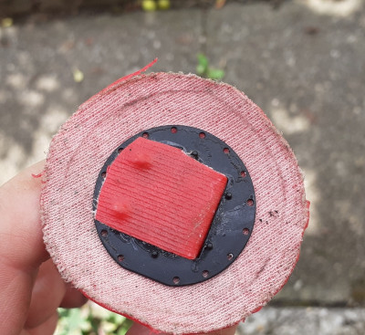

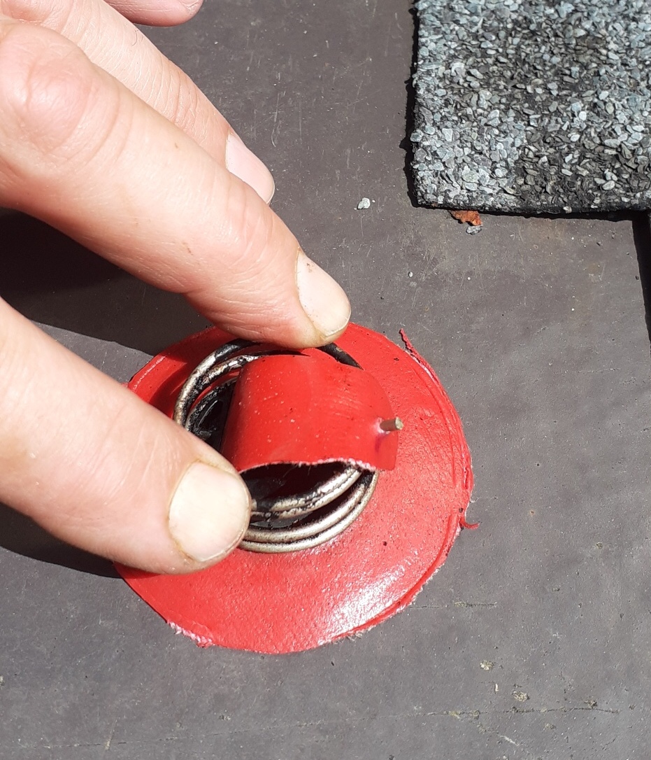

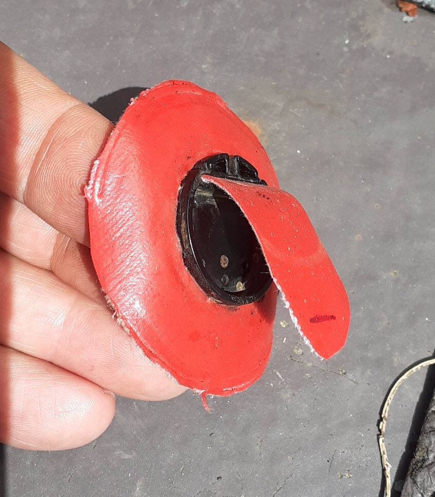

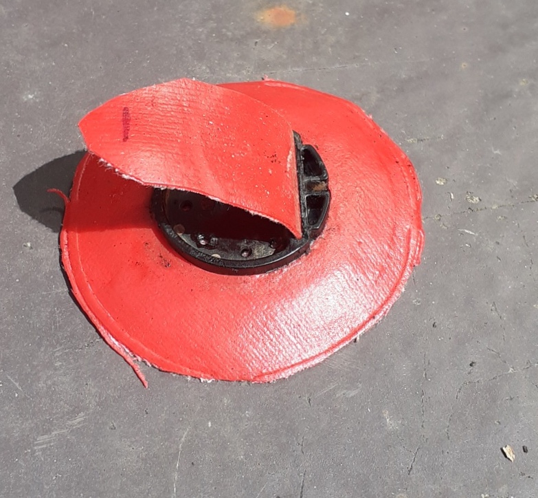

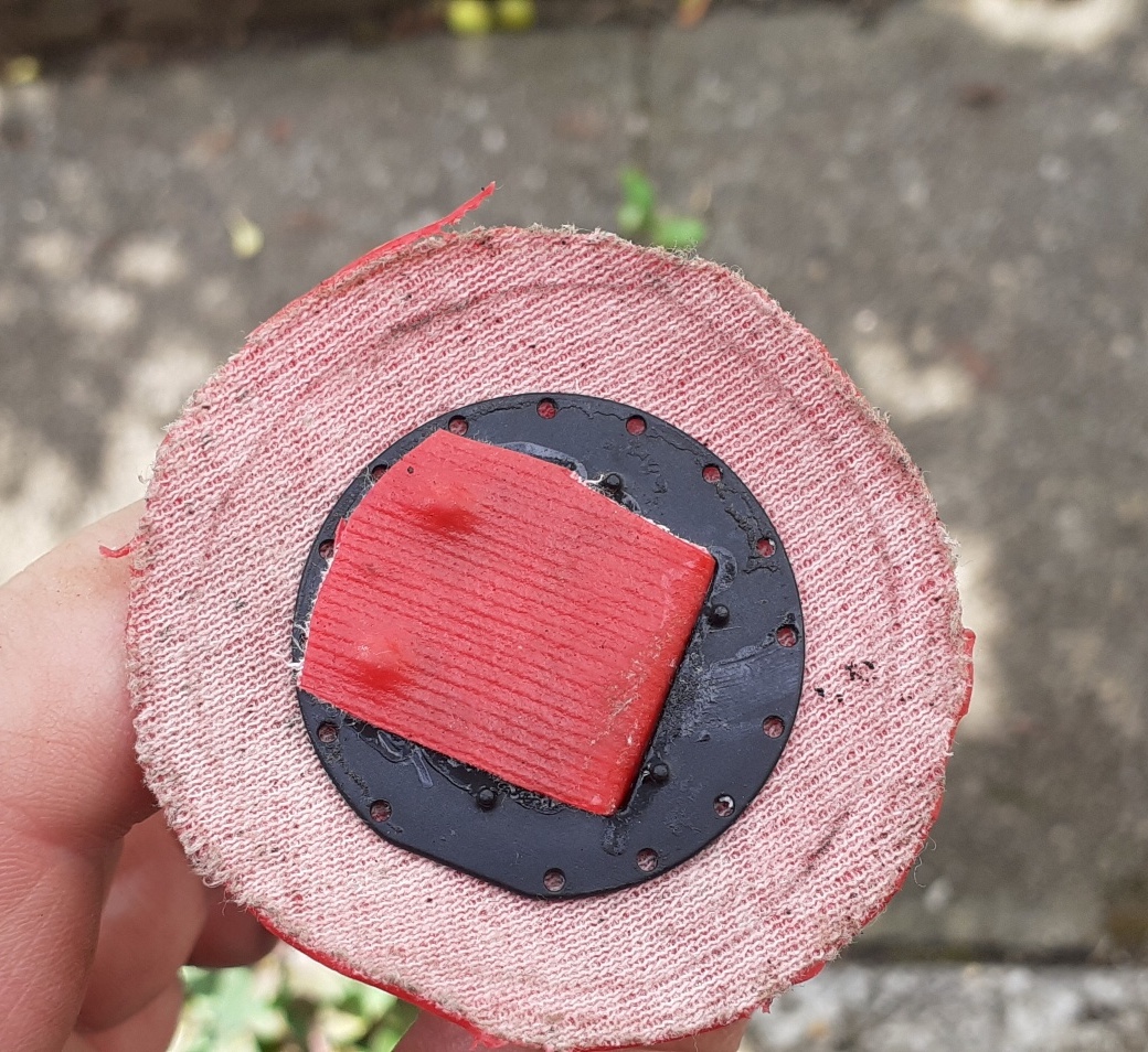

... the short version...yes indeed Rusty Racer
...left hand PCV diaphragm and tongue seal perished and split so valve not functioning! Good news the PCVs (2 - one for each bank, are right at the top and easy to access... I didn’t suspect these before because the noise wasn’t coming from there)
Longer version.... pcv not functioning so at idle full manifold vacuum applied to the crankcase (something I didn’t mention and realised wasn’t right was that with the engine idling the oil filler cap was almost impossible to get off ... full vacuum being applied to it which I eventually realised wasn’t normal ... you’d expect a a bit of negative pressure for crankcase purging but not hard vacuum). Further detailed search for the origin of the noise ( stethoscope with tube and section of brake pipe in the end so I could listen to anywhere in the engine bay... again the noise was not localising anywhere until I listened inside the access cover for the bellhousing... WTF! Piercing squealing inside the bell-housing I’d previously noted this and wondered if it was gearbox issue but didnt fit with geabox function (normal). Read some threads on xs crankcase vacuum this immediately pointed to PCV failure... instead of closing at low manifold pressure it remains open and applies full vacuum to the crankcase through the breather hose. So the noise.... now I can’t physically confirm this but the only explanation I can give is that at high vacuum air is actually sucked past the crankshaft rear oil seal, causing the lip seal to vibrate and act like a reed causing the shreaking noise which is then nicely amplified by the bellhousing. Neatly explains why unseating the oil filler cap immediately stopped the noise...
solution ... well replace PCV obviously (I will do both as the other must be near to failure now) ....problem... its Saturday pm and dealer is closed and part # 079 103 245 L is not listed anywhere on the web (suffix J and M only and they physically different and are for different applications).
As I need the car and am very impatient anyway I have spent a couple of hours hand making a replacement diaphragm and tongue seal out of a pair of industrial safety rubber gloves along with the ever useful superglue. The result after much faffing around and trial and error ... not perfect but it now works well enough to have reduced the vacuum in the crankcase to modest levels... the valve doesn’t quite seal fully... but the the noise has gone and the engine runs fine and hopefully it’s good enough until I can get the new ones.

Ha, yes so am I ...thanks !! I’ll post some photos of the makeshift repair but basiscally the original diaphragm (left hand pcv) was split in multiple places and the tongue had separated. I have replaced this one with new OEM for £150 ... there is no alternative and although you can get replacement diaphragms (including supposedly indestructible ones) for some of the Audi PCVs on line for pocket money.... not the RS4... oh no... so local stealers it is I’m afraid. Had a look at the right hand one as well and although it was still sort of functional it was failing.... so rather than forking out again I took the one I “repaired” and re shaped the hose so that it would fit on the RHS instead. As I said I don’t think it’s sealing properly but it seems to be adequate at the moment. In due course I’ll fit a new one when I can cope with the resentment of paying through the nose for a piece of injection molded plastic / synthetic rubber that’s probably worth about £5!
