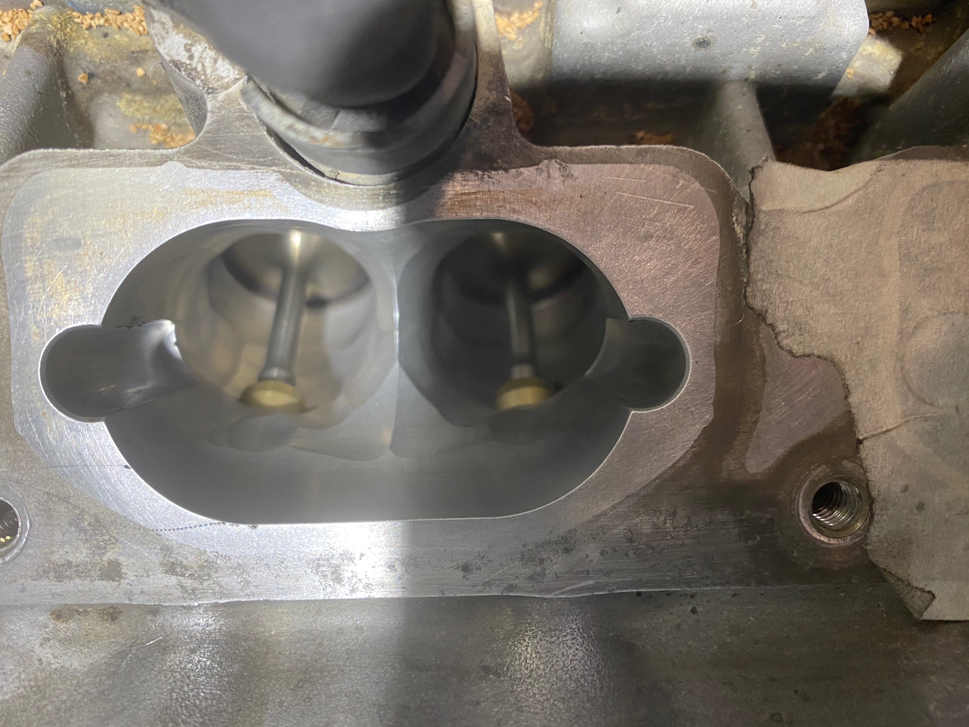

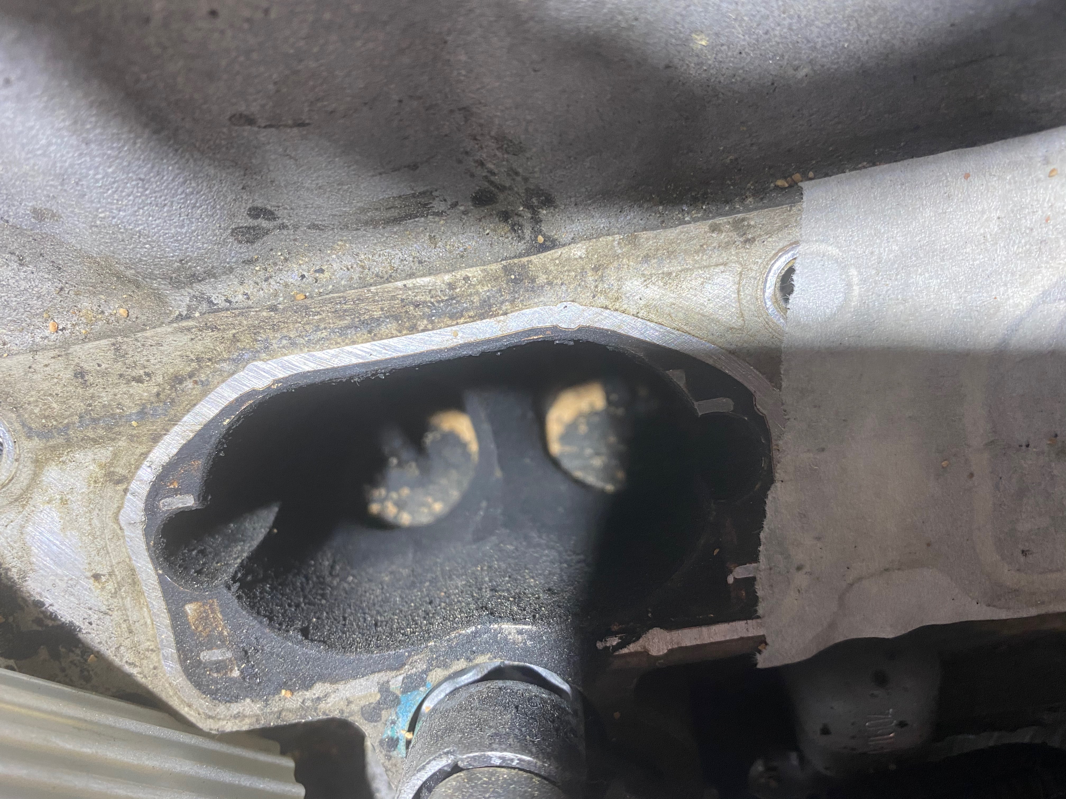

Post by Steve rs4 » Mon May 10, 2021 5:57 pm
I've done a carbon clean myself on my RS4 B8, my mileage was at 40k there was some carbon build up so I think it's well worth doing as my car runs better than ever !
My car was running ok before but if you want to keep max bhp and torque then it's still a must even on the b8's to keep them in tip top Condition ! ImageImageImageImage

I did not do mine with a walnut blaster I'm afraid.
I done it by hand with brushes and it was pretty easy to be honest I just let the cleaner sit for a hour then got to work I got the brushing kit from JHM.
