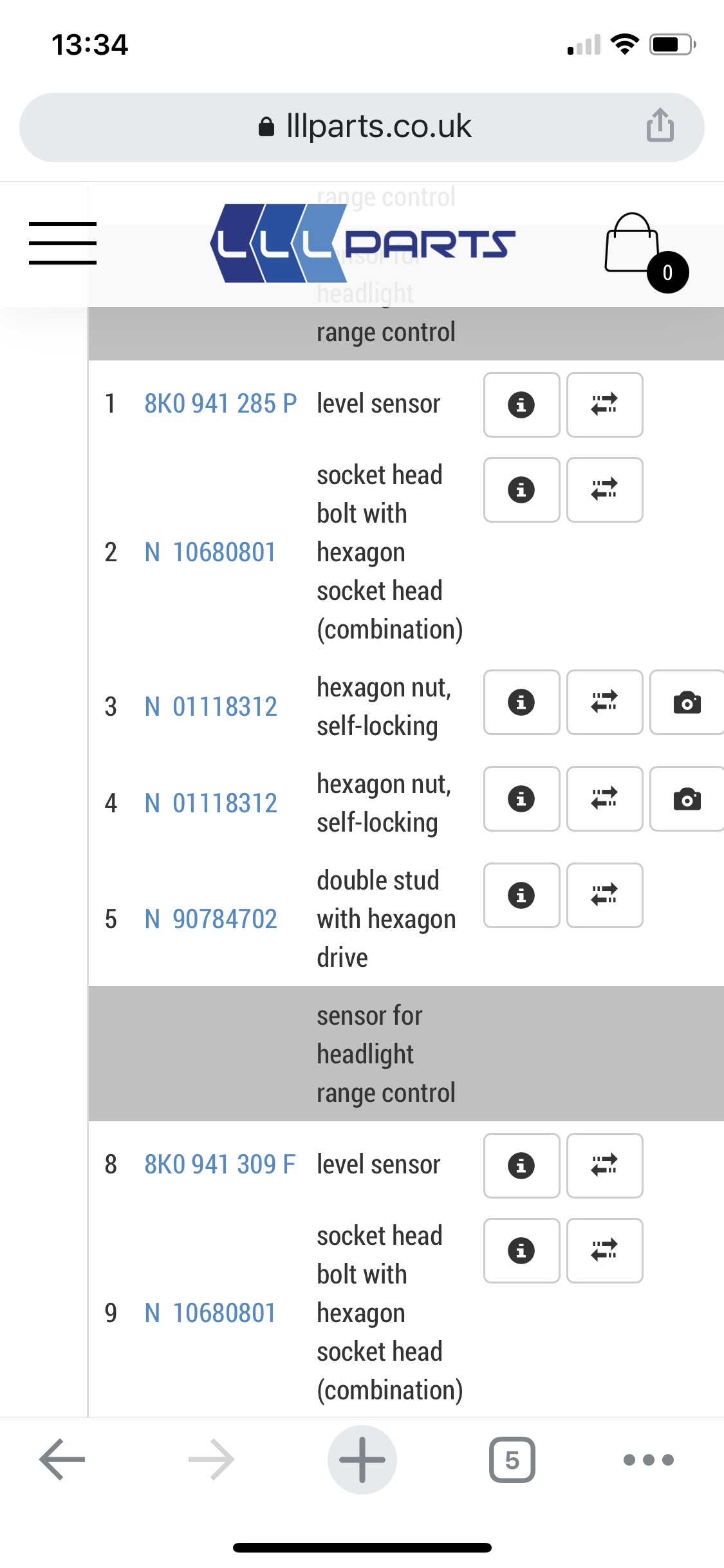

Rugslasher wrote:
Sun Nov 01, 2020 11:28 am
B1ncc 1.8t wrote:
Sun Nov 01, 2020 10:06 am
They are bad for seizing up and they are pretty delicate little things. I couldn’t find any live data on VCDS for them.
Both mine were seized and freeing them off didn’t help.
I fitted two new ones all good now.
Cheers for info, are they stealer part only ?
Item 1 is the part number for the front, and item 8 is for the rear. If you google these part numbers you’ll find various options for parts (genuine and aftermarket).

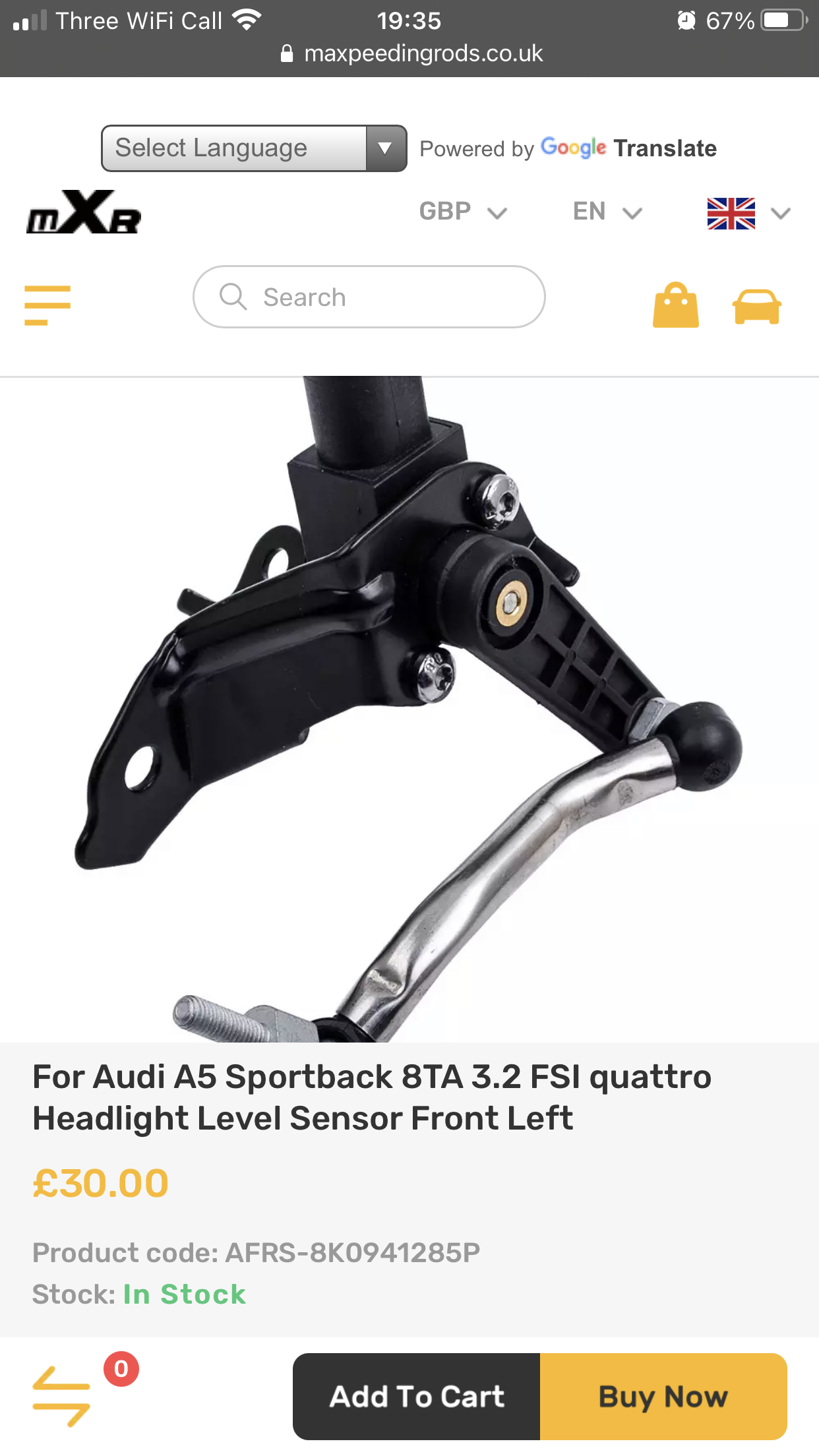

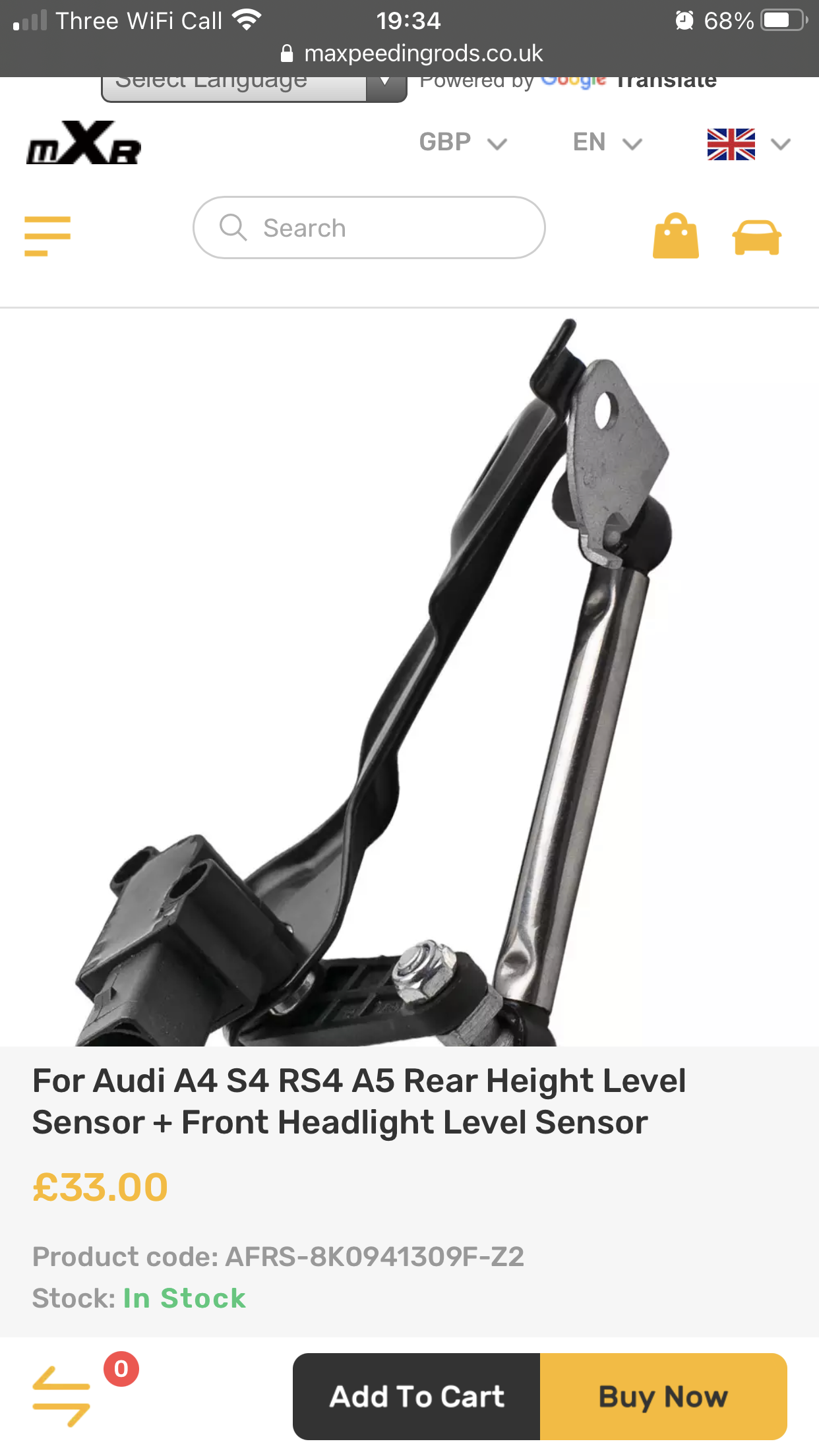

I am lost here, still waiting for my adaptive lights that i orderd from ebay. Can ypu perhaps guide me in a photo on witch sensors you are talking about?
Thanks in advance
Rugslasher
Posts: 87
Joined: Tue Jul 16, 2019 9:59 pm
Re: Adaptive light fault after lowering
Post by Rugslasher » Tue Nov 03, 2020 8:38 pm
These
