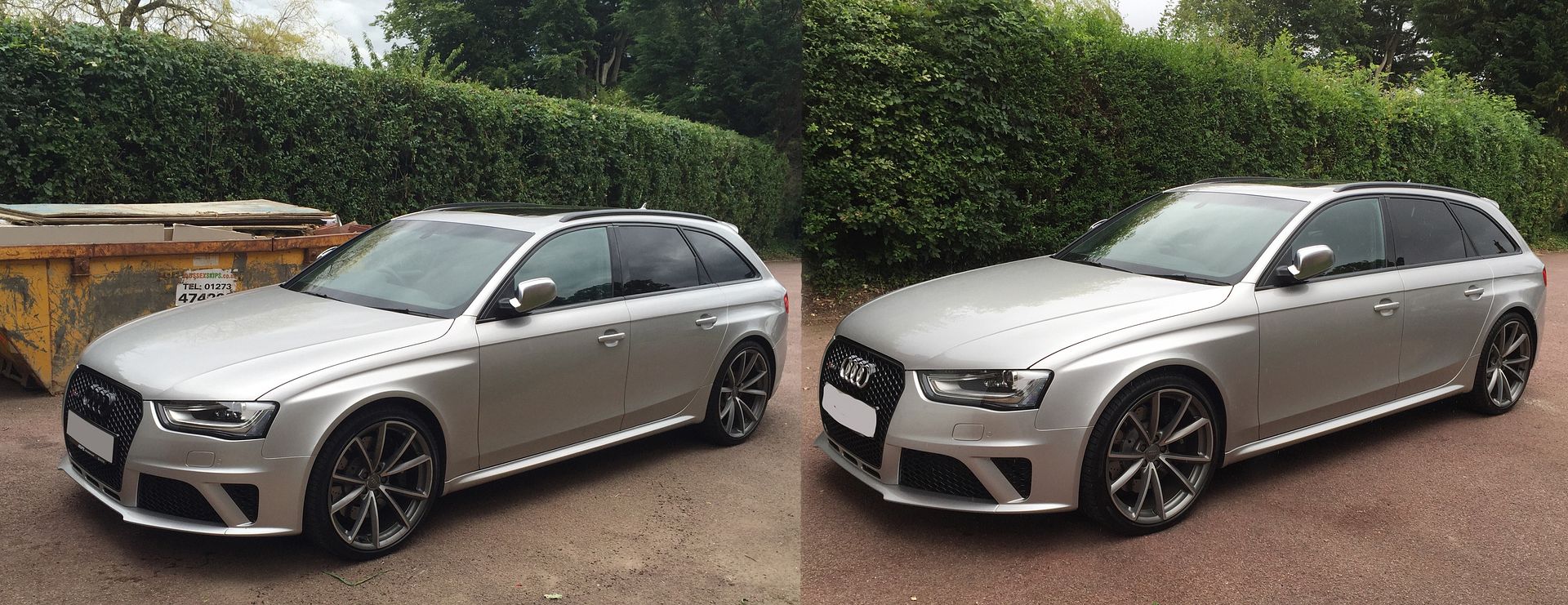

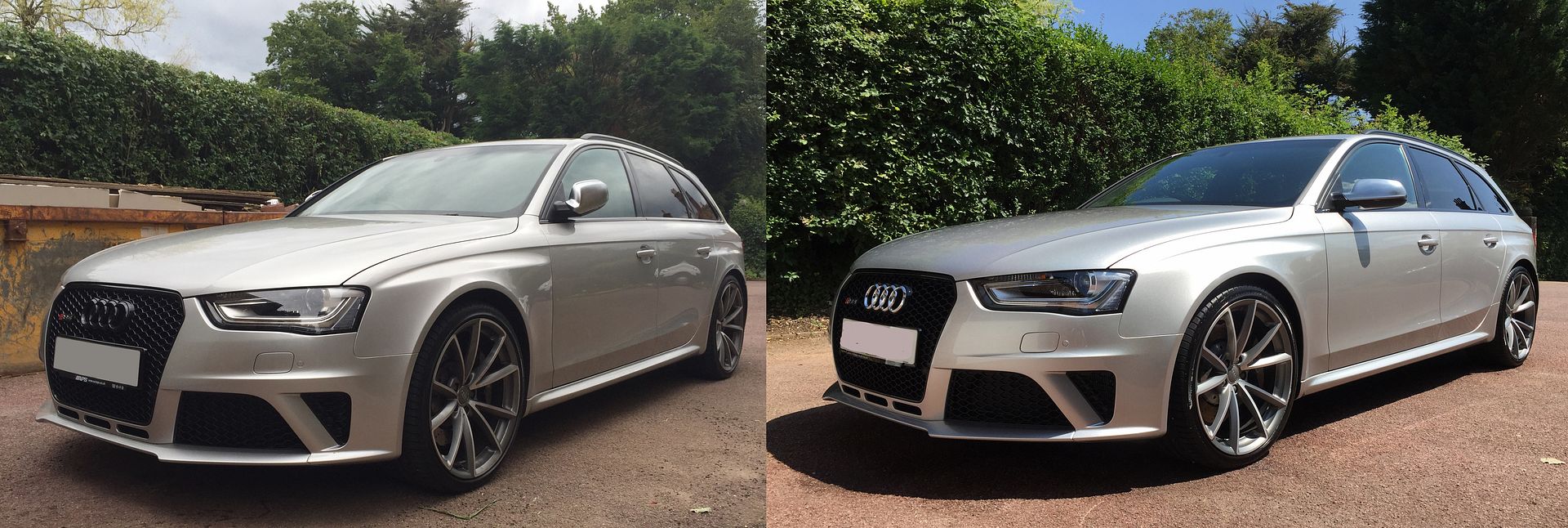

Had my RS4 from 1700 miles (dealer demo/MD's car) and noticed a slight clunk from what I thought was the front O/S. Left it as thought I was being paranoid but when it went in for a service at 7k I mentioned I'd like it looked at. Took the master tech out and he just about heard the clunk - low speed and sounded more like a top mount was loose - to which he said it didn't sound like the usual DRC failure.
Wasn't expecting much other than a fight to get it sorted when I had a phone call to say Audi technical had told the dealer to go ahead and replace the front dampers and a part related to the steering column. She told me it was a £4.5K job! Car definitely feels better, the steering is a little more direct (there was a slight vagueness occassionally where it would almost feel like when you get caught in a rut on the inside lane of a motorway caused by trucks and its pulling at the steering wheel), and she said they found the N/S damper was definitely leaking.
Now though, the front ride height is different, or at least I'm convinced it is. Its definitely higher and the service assistant says that because the damper was leaking, originally the system had less pressure and therefore less height, but I've looked at many photos and still think its too high!
FYI, I had to wait for a few weeks just for the parts to be assembled as they supposedly are having a huge number of warranty repairs on DRC equipped cars (not sure other than the RS5 whether we share dampers with other models). Glad to see Audi have learnt their lessons from the B7
Anyone care to put a tape measure to their front arches? Mine are 698mm O/S and 693mm N/S.
Before on the right:

What were your arch heights before the replacement? Its quite hard to tell on the pics but i'm guessing that before the replacement, the wheel sat deeper in the arch (less space between the top of the wheel and arch)/?
Re: DRC - definitive list?
I didn't take measurements before unfortunately.
