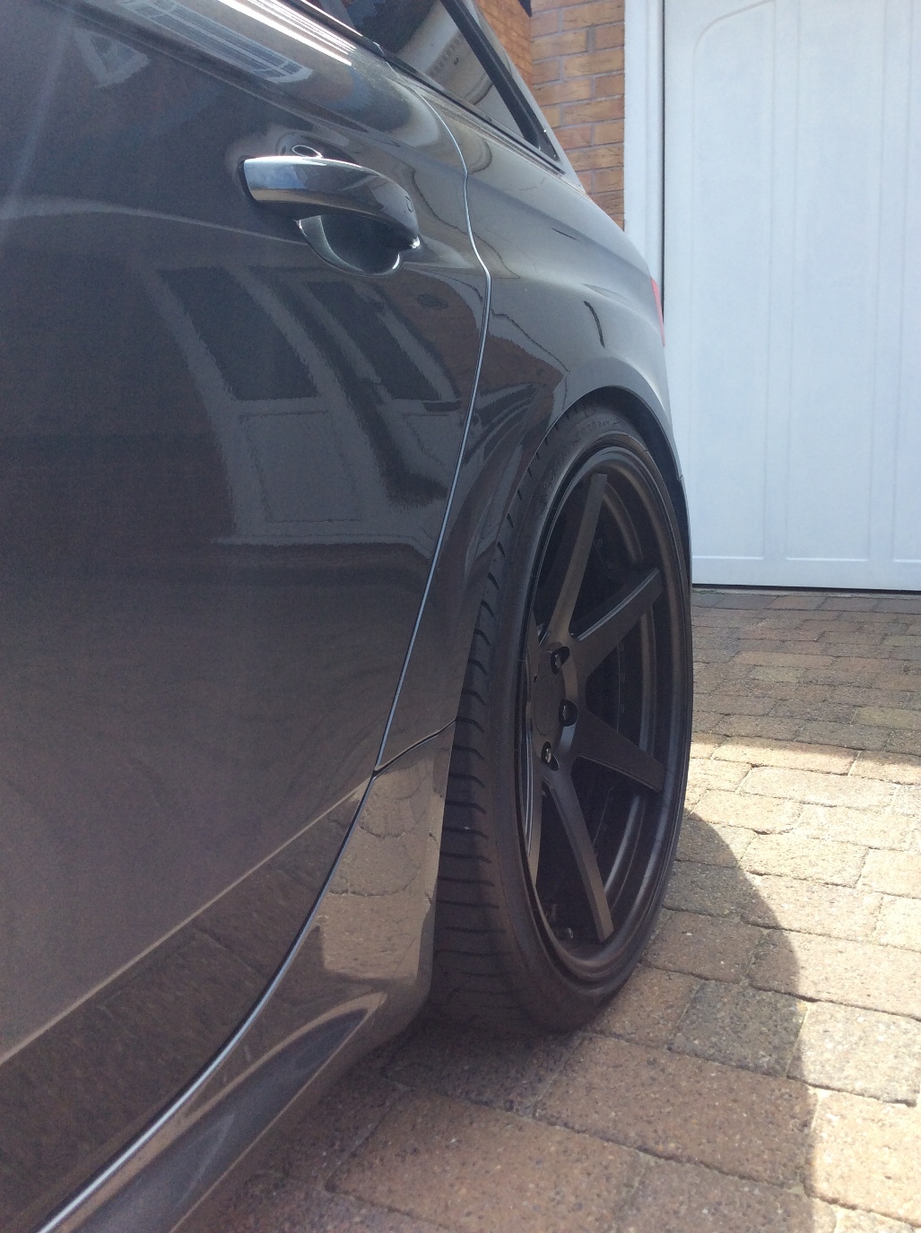

Several tyre manufacturers list a rim width range of 9"(min) to 10" (max) for 265/30R20 tyres with an optimum width of 9.5" so you should be absolutely fine running your existing 265s on the new 9.5" rim.
For your further piece of mind, I'm running 265/30R20 stock Pirelli PZeros on 20"x10" rims and they are fine with little/zero stretch:

You're a superstar! When it stops raining I'll get them fitted!
Thanks matey.
