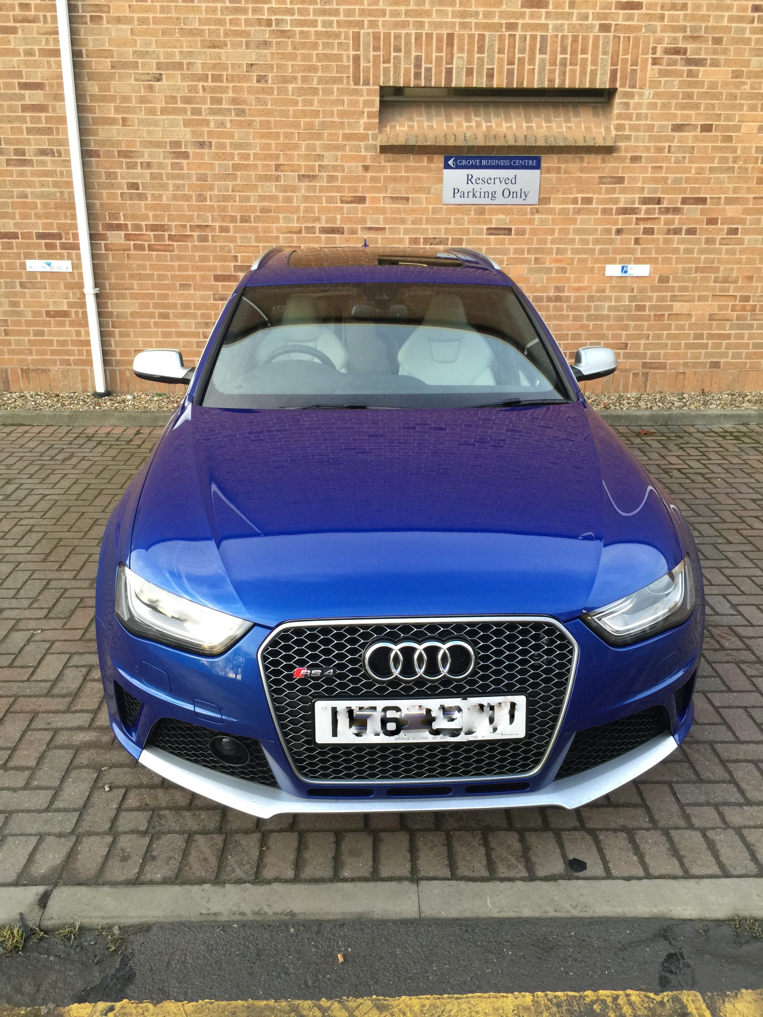

Hello,
Before I start, quick thank you to everyone on here - this was the main place I did my research before buying my RS4. The car is awesome and, whilst I was worried about whether I'd find the fuel economy so annoying vs how much fun I was having - safe to say I think I've ended up on the right end of the deal.
So, Sepang Blue, with sports pack, rotors, silver trim, pano sunroof, B&O - all amazing.
The problem then is this... I have the DRC and the suspension makes a very noticeable knocking when I go over bumps. It does it at high speed, it does it at low speed, it does it over small bumps and big. Definitely notice it every time I go out in the car. Took it into Swindon Audi, who were great (especially Brendan), they re-pressurised the system, which seems to have helped a bit, but it's still doing it and I am finding it really quite annoying. Audi say it's characteristic of the car and there's nothing more they can do. I didn't get the impression that Swindon Audi had seen this before, which didn't give me a lot of confidence in that diagnosis. Questions (1) Does everyone else get this? (2) If you do, is there anything that can reasonably be done to minimise the noise. (3) If you don't, any recommendations for what I should say to Audi?
Thanks in advance,
William
