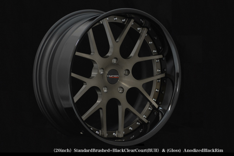

For Winter wheels therefore I’m looking at going forged 3 piece, and to a smaller Wheel Maker (design, machining and assembly) as ; http://www.hyperforgedwheels.com/products/img/c7/50.jpg http://www.hyperforgedwheels.com/products/img/c7/15.jpg
[Hyper Forged, whose reputation in Japan is very good. use forged blanks - if I can call that - by TSW. BBS, TSW & Rays being the only 3 JP companies that forge their own wheels].
‘3 piece’ would be first time, hence I don’t have the experience of disadvantages of same other than what I’ve researched. Summarizing the key downside factors as I understand are ; Strength is weaker than comparable forged Moniblock, Weight is a little heavier, Leaking is (sometimes) possible. Although Rim repair is easier, Rim replace cost is in any case high.
SO, assuming I know and accept the above, are any obvious ‘other disadvantages’ that I am overlooking. Why should I steer clear of forged 3 piece?

Took the plunge and - though perhaps not conventional for Avant & not a recognized brand in UK - went with attached Maker, design and color combo ;

Understand not everyones taste & there’ll be polarizing opinions - I’m happy with outcome though.
[3 Piece Hyperforged C7’s _ Matt Black Rim _ Gunmetal Disk. Not super light, but 800grm lighter than OEM’s ...(when weighed w/tires)].

Shame the fronts couldn't match the concave of the rears.
Re: Forged 3 Piece, ‘Bling’ over Performance
Yes, although the OEM’s are same concavity, the Wheel Maker I chose has a Std Concave and a Deep Concave disk standard(s). Given the offset used, the same width rims, the Deep Concave for said wheel would have been too close to front callipers. [Wheel shop I used tried make the wheel offset a little tighter...and so sum of all small changes led to front being as it is].
It’s a subjective view of course, but in real presence the ‘difference’ in concavity works in such a way as to compliment that of the rears - if that makes sense.
