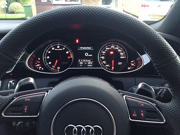

When I got my car new a few weeks back I noticed immediately that the steering wheel was off centre when driving on a straight road. So I took it straight back so I couldn't get accused of hitting a pot hole etc...
The supplying dealer had it back in for a day to check the alignment, they couldn't fix it. Claiming something about not wanting to put the lane assist out of calibration???
So they've just had the car in for 2 days, and sent it back to their main prep centre and specialist body shop. Got it back today, and the steering is exactly as it was when they took it in!
:audibash:
The picture below is how my steering wheel sits when driving straight, it's not far off, but enough to be annoying. Questions are; are they all like this, am I just being too picky? Is this normal and the steering angle is just adjusting for the road camber?
TIA

Thankyou, I'm glad that they are 'not all like that', it is annoying the crap of me, and spoiling an otherwise great car.
The reason it was sent back to their main prep centre was that the supplying dealer didn't have the specialist alignment equipment. I'm not sure I believe the line about putting the lane assist out of calibration.
They are going to be told tomorrow to get it sorted, or I will reject the car. To be fair to them, the steering feels much better now, albeit not straight, so something was clearly wrong when I collected it.
To give the dealer their due, they have been very helpful and apologetic about the whole thing, and my little petrol head 20 month old son has his first Audi as a freebie!...

The steering wheel doesn't look straight on that one either :bigblink:

A quick scan with VAG-COM shows that when the steering rack is reporting zero degrees, the steering wheel is reading about 1.2 degrees.
Searching the web, it appears that its not nearly as simple as just tweaking the track rods to square it up, or running basic settings on the Steering modules. You can potentially make all the cruise, Steering and Lane assist etc all throw fault codes.
It woudl appear Audi themselves place a bit of tolerance on the steering, but do note that if its too far the likelyhood of custom complaints increases
