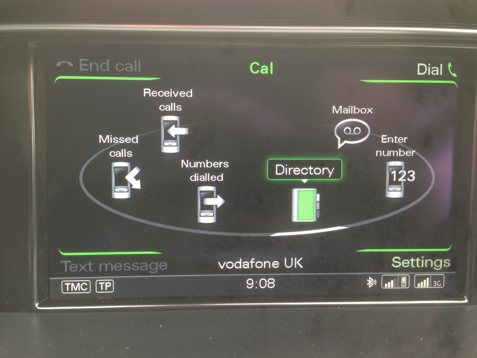

I have my new RS4 now and also an iPhone 5.
I always thought that because the iPhone doesn't have the sim access profile the only way to make the Audi connect work was to have a separate SIM card in the car and then pop it out when you want to make a call over Bluetooth connection to the iPhone.
However today I put my GiffGaff sim (unlimited data for £12 a month) in the car.
It then asked me which one I wanted to use for phone calls, so I said the iPhone. Now I have two little phone icons showing signal strength at the bottom right of the MMI, phone calls go via iPhone and when my sim is activated by GiffGaff I think data goes via that.
From looking on forums it had looked like this was impossible, have they done an update or will it not actually work?
Thanks.

Here is a shot of the MMI with the two phone connections, see bottom right. Am I making a to good to be true newbie mistake here?

OK so the SIM is now activated and it all works.
Calls over the iPhone, AudiConnect googlemaps and traffic over the SIM in the dashboard, without having to insert/remove the SIM.
In other words convenient.
Would be better if it could use on line stuff over the iPhone data to save me £12 a month but given the price of the car it is a rounding error!
