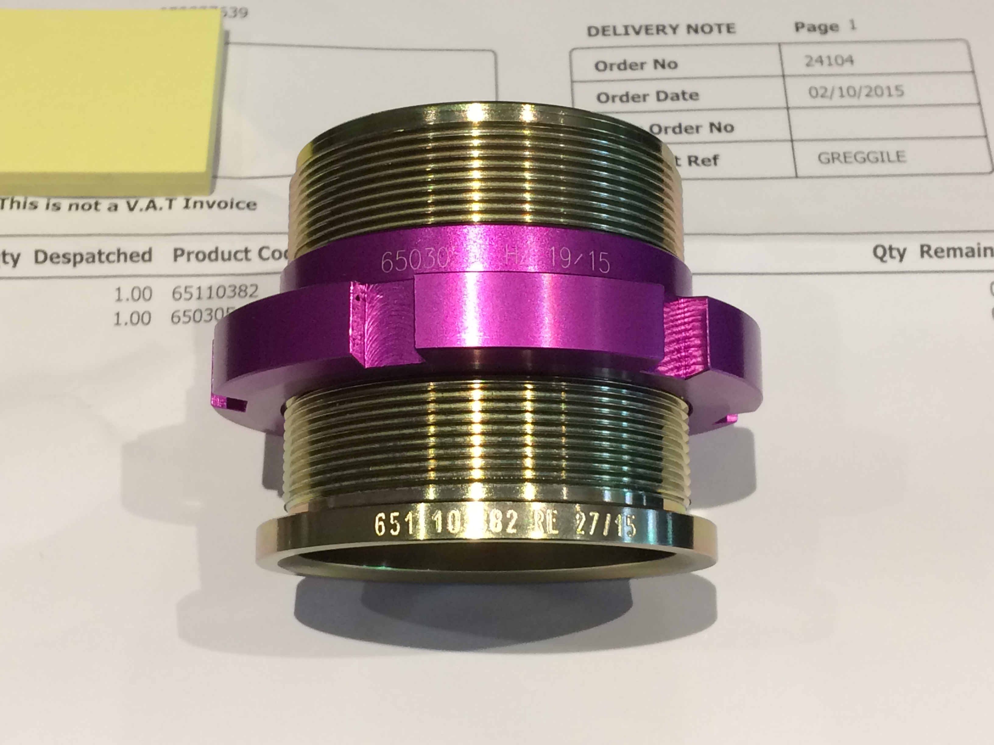

Alignment 8 will be Friday!
Purely down to a coil over part being damaged because it was locked solid with grit etc!
Replacement will be fitted Friday.
