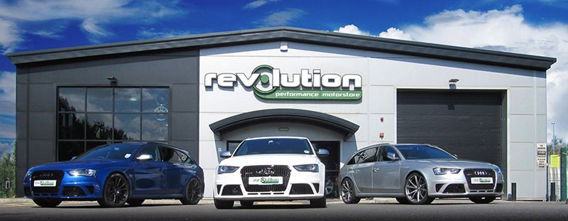

Soo, I booked the car in with the very helpful folks at Revolution (http://www.revolution247.com), who are of course members on here! Did a full alignment, had a chat, met Graham off of the forum, took some photos...
Anyway, it turns out that Audis helpful way of 'correcting' my steering was to set the ‘rear thrust angle’, and the ‘front steer ahead’ settings right at the right hand limit of the tolerance, and had set camber angles different from one side of the car to the other. So in effect my car was always drifting to the right, and so I would steer left to compensate, and hence centre the steering wheel. Nice theory.

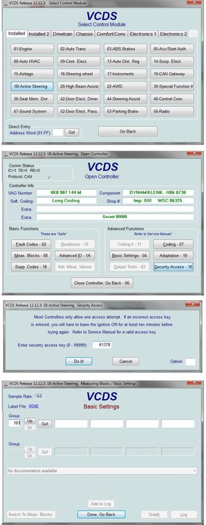

So, for anyone with Active Steering on an A4, A5 etc which has the steering wheel out of centre when driving ahead, all you / your dealer have to do is re-do the basic calibration for the Active Steering....
If you are going to do this yourself you'll obviously need a VCDS cable. (http://www.ross-tech.com/vag-com/)
Disclaimer: I worked this out by trial and error, and if you use it to fix the steering on your car, don't blame me if you break it!
The instruction on the Ross Tech Wiki says to leave the steering wheel straight while you do the set up. However to correct an off centre steering wheel, you have to do the set up with the wheel in the position it is when driving ahead. So in my case I put the steering wheel to the right slightly before doing the set up.
In VCDS with the engine running…
Go to the ‘Select Control Module’ option…
Step1: Click on the button for the 1B - Active Steering
Step 2: On the next window, click on the button for Security Access, and put the code 61378 in the box that pops up. Click OK.
Step 3: Click on Basic Settings. Then in the next window you need to put 101 in the Group box and click Go.
When you do this you’ll get a clunk from the steering, and faults will flash up on the dash. Don’t panic!
Click the [ON/OFF/Next] button. You’ll get a ‘OK’ in the first box. Then click [Done, Go Back]. Don’t worry about clearing the faults for now. Just click [Close Controller, Go Back - 06].
Now without moving the steering wheel, turn off the engine, and restart the car.
There will be a yellow steering wheel symbol on the dash, and in the DIS. This is because there is a fault registered. ‘Steering end stops not set’.
To set the end stops simply turn the steering all the way to the right, wait for the beep. Then back all the way to the left, and wait for the beep. The yellow warning light should now go out.
You will have registered loads of other faults in everything from the engine to the ABS etc etc. But these are only there because the car lost it’s steering settings. All you need to do is run a full scan, and clear all the DTC’s.
Your steering should now be straight. (I had to do the above 3 or 4 times, before I got my steering centred to my OCD standards, because Audi have a tolerance of +/- 1.5 degrees, and I don’t!
