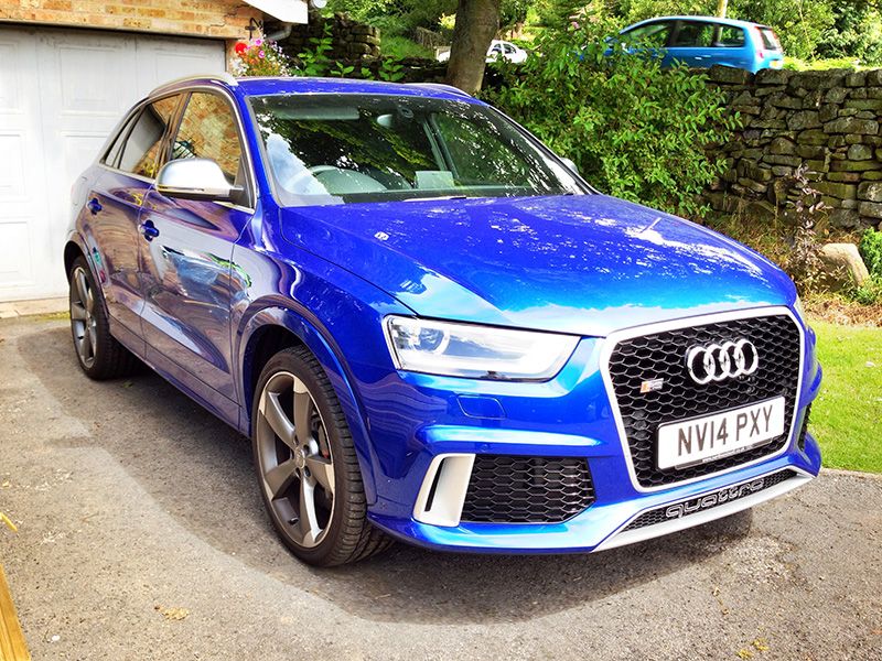

In the meantime I've got a brand new baby RS...
All the girls in my office love it, which I think says a lot about it! :P

Now get back out in the RSq3 and do some more perms and blow dries :)
My wife would love that in that blue. I might hide this from her
That car is so wrong on so many levels, it's doesn't make any sense to me
