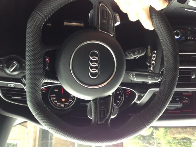

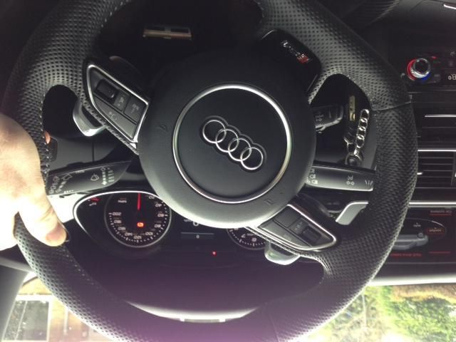

If anybody just happens to be sat in their car, it would be really helpful if someone could do me a huge favour...if you could put the steering in comfort mode, and spin the wheel lock to lock. Does it stop at the same angle either side? Just need to confirm if it's normal for it to be different, Audi say it is, but that doesn't sound right to me???

I know it's an rs5, but system is identical bar the assists package
Full lock left and right
Would appear to go a few more degrees left over right

I'm really bored (on hold) and just compared the images using photoshop after some transformations and they are almost pixel perfect!

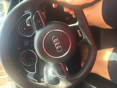

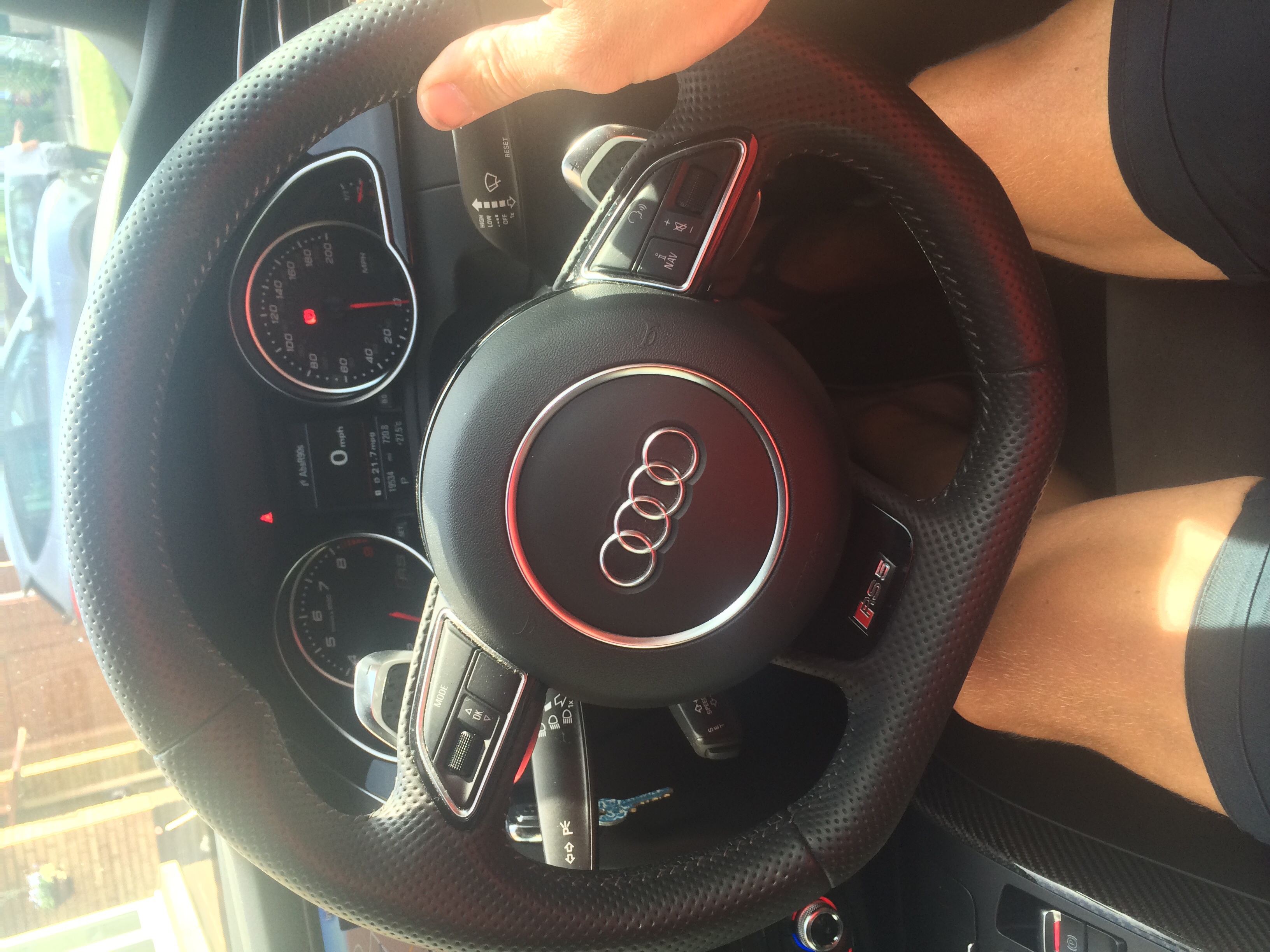

Here's mine:
Held to the right, about the same as yours I would guess:
And to the left, hmm somethings not right!:

Andy_S wrote: They apparently checked with Audi UK, and it's normal for the steering to stop at different angles. :roll:
Well, yes, I would agree. All the tolerances add up and things are never perfect.
However... We are talking degrees here.
What you have shown in the pictures is way way way WAY over and above what would be considered normal.
(note- definitely worth sending to Audi customer services as until you put the pics up I thought it was normal too)
I have seen something like this before though - if there is a mistake during alignment and the person doesn't spot it then it compounds the problem. What I suspect is that the steering wasn't central at some point (most likely is one spline out on the steering column) and they have tried to compensate with track rod and other adjustments. These are really for fine tuning and could never take account of an error that you would get being a spline out.
To me, this explains the whacky lock to lock ratio you have, the inability to get the rack sensor lined up with the steering sensor and why turning one way feels heavier/different to the other (as the suspension geometry for castor will be shot to hell).

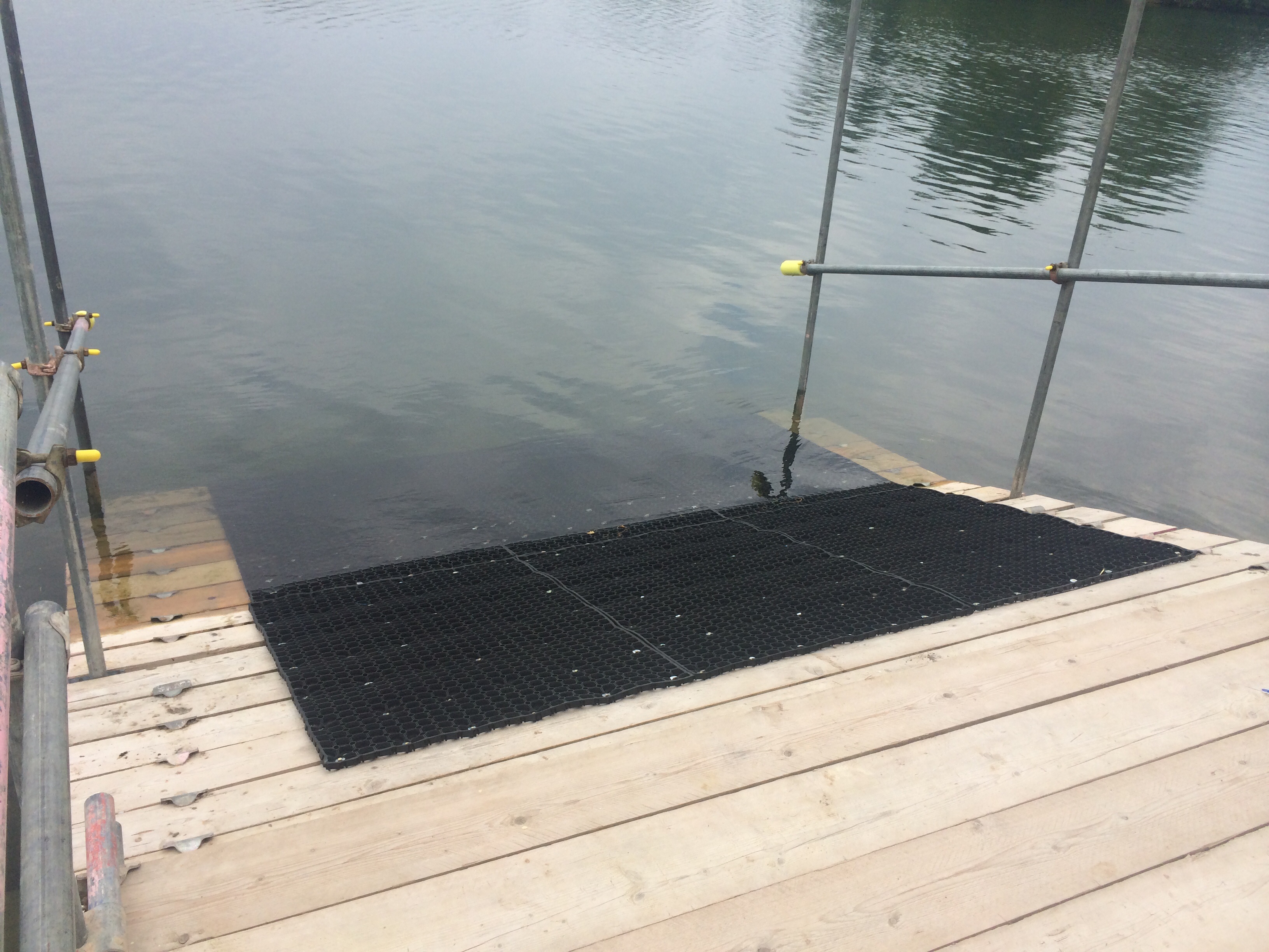

Mine today was trying to screw 300 crappy screws and badly fitting washers into a ramp underwater with the Crappest air gun ever. Nice to be outside, but that was about it today
