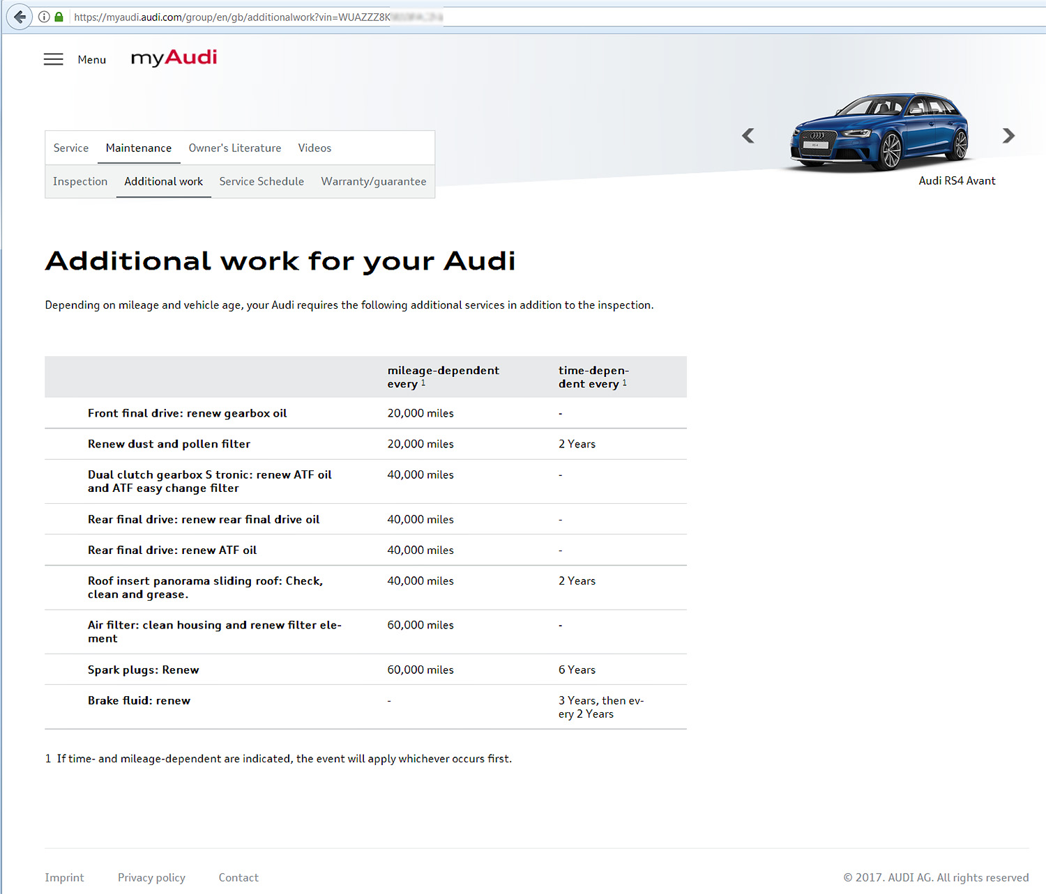

Hi Chee,Chee wrote: ↑Fri Oct 20, 2017 9:06 amThanks guys. I think I will leave this one alone and get my deposit back. Does anyone have a link to a copy of the official Service Schedule for the Audi B8 RS4? As I thought the DSG oil needed to be changed at 40k mile intervals, this is correct for my GOLF GTI anyway? Or is the 20k service just for the front final drive oil?
Ta,
Chee
I've taken a screen print from Audi's online owners area, for you to see the additional service items required.
Click on image to enlarge:

Great, thanks for the info Sam.
Just to update, the dealership has been in touch with the previous owner and they are convinced that it did have a service at around 15,000 miles at Audi. But, as with others on here, it isn't showing on the digital service log. This was Friday, and they still have not provided evidence either way. So I think it is looking unlikely that I will buy this car.

Chee - due apologies for jumping on this thread, but have a similar issue
Please forgive my ignorance as a newbie - but have read extensively on here about all the various issues
Just seen a March 15 B8 at a local non Audi dealership. 32k miles
Oil changes done at 5500 and 16000 by an Audi dealership.
They (and the current selling garage) have no doumentation of the foll items on Sam's list in the sticky
"Audi Additional Service Requirements:
Front Final Drive: renew gearbox oil – Every 20,000 miles.
Cabin interior Dust & Pollen filter – Every 20,000 miles or 2 years. Whichever comes first.
Panoramic Roof : check mechanism, clean & grease slides – Every 2 years or 40,000 miles. Whichever comes first"
Having spoken to my local dealership - they're of the opinion that Audi UK would not cover the gearbox, if it went kaput - although the seller reckonas his local audi dealer would cover it locally 'under goodwill'
Thoughts please, from those with more experience in such matters..
Thanks in advance

That's the grey area bit
2 services done at 5500 and 16000, by Audi (I phoned and checked personally).
The additional bits (esp the "Front Final Drive: renew gearbox oil – Every 20,000 miles") not done to date - currently 32k miles
The seller has suggested a gearbox inspection at Audi dealership of my choice + Multipoint pre sale check - which he is willing to pay for + any bits that need doing post inspection.
I need to see with my local dealer, if they'd be happy to sort out on 'goodwill' should something go wrong in the future
Was thinking of getting a 2 year additional Audi warrant anyway, come March 2015
