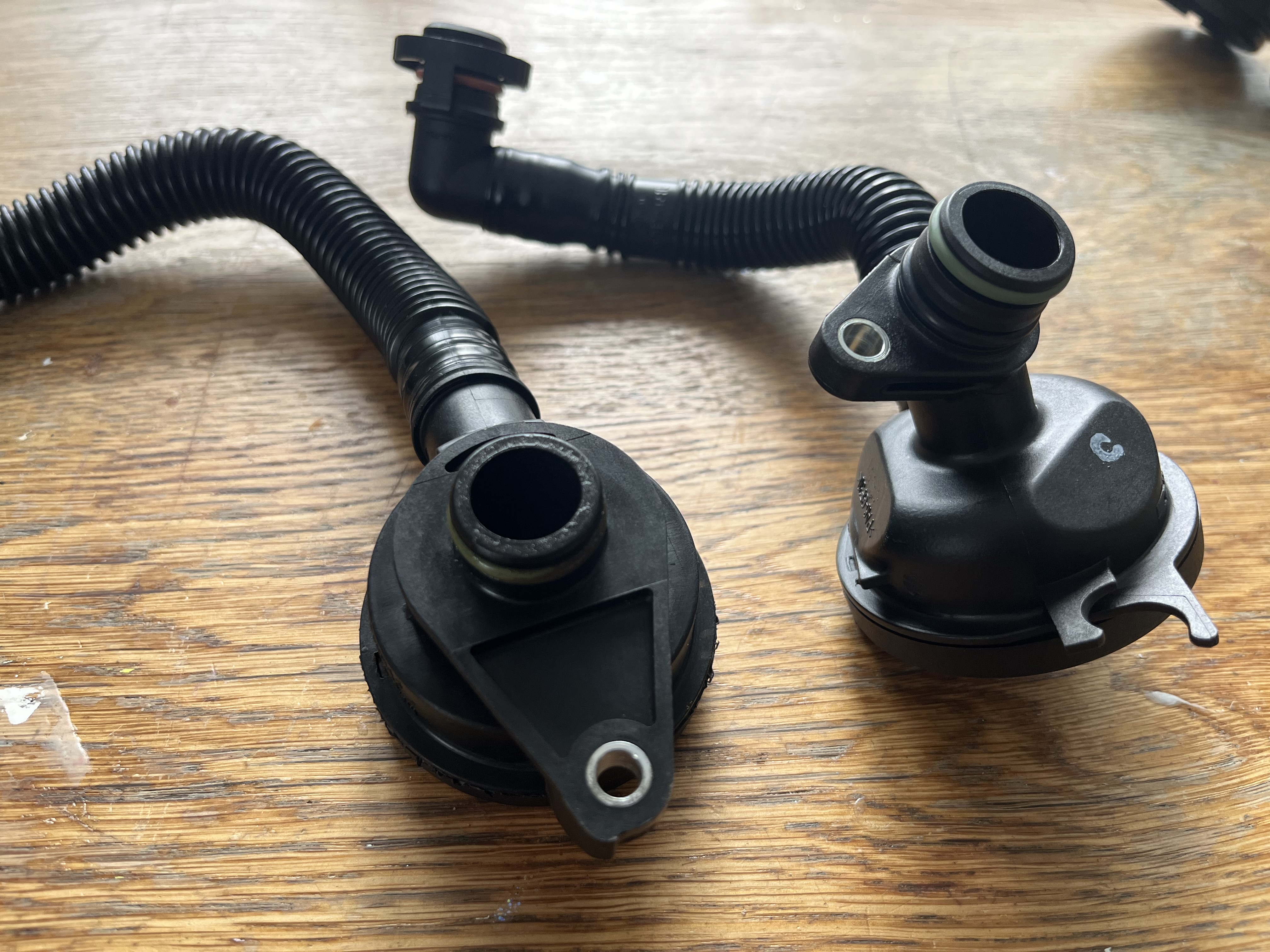

Update with Pictures attached. Audi PCV on left Merc on right. Also a picture of the Mercedes part no.

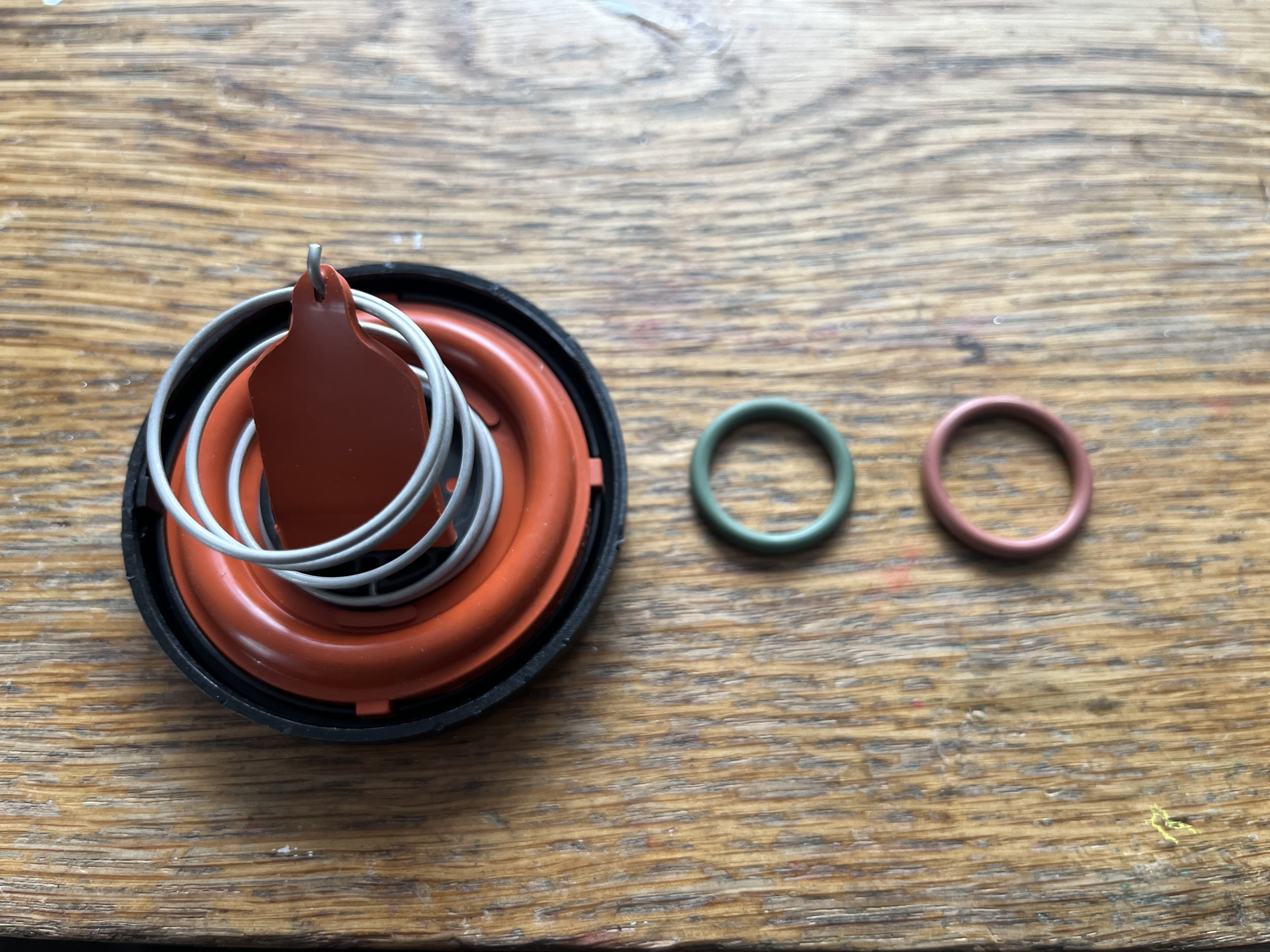

I stripped the diaphragm, cap, and o rings off the Merc PCV and simply fitted them to the Audi PCVs. Car runs perfect again now!
