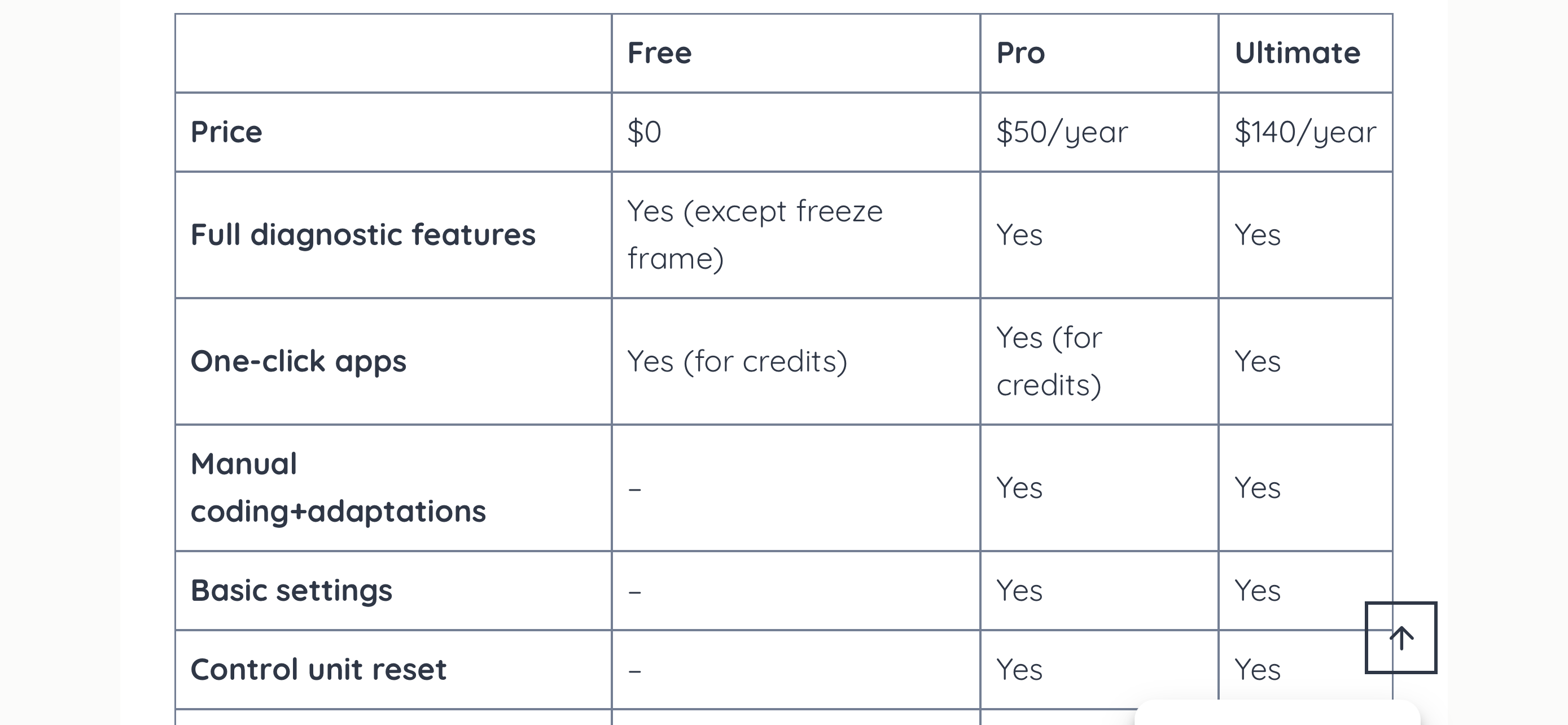

Thanks and good shout, I was just on Amazon browsing. The obd11 seems the best option any experience on these and any benefit / drawback of the different versions?

Hi mate. I’d go for free for what you want to do. You can always upgrade later if you need to code etc.

Also, I’m assuming you want to keep the cost down and just read codes now and again.
If you’re actually working on the car. Clutch calibration, diff pipe fill and bleed, more in depth diagnosis etc, VCDS is probably a better better. ODB11 does most of the same stuff, but I couldn’t get some of it to work
