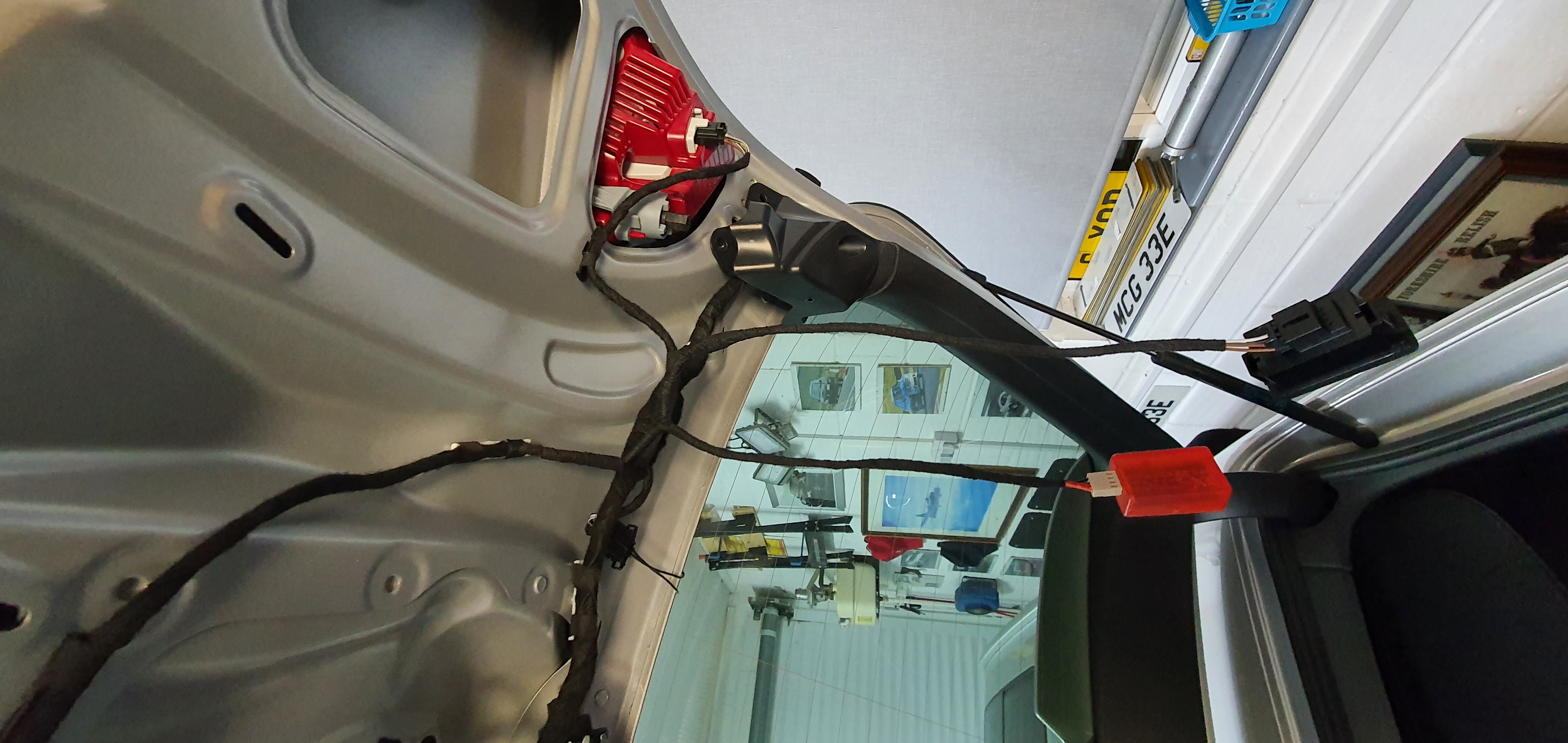

I fitted it on mine, no difficult tbh if you have basic wiring skills (and a soldering iron)

Thanks Surrey Sam, great instructions. Fitted mine this morning and works great.
NOTE: 2021 units are now shipped with 4 wires not 5 wires. The yellow wire has been deleted. The Orange wire (which was spare) is now the old yellow and is connected to the Gy/Bk wire to the tailgate switch. I only found out after I stripped the tailgate and came to solder the connector.
I checked the Bexpro website and saw a note in German explaining this. At first I thought I had been shipped the wrong unit.
