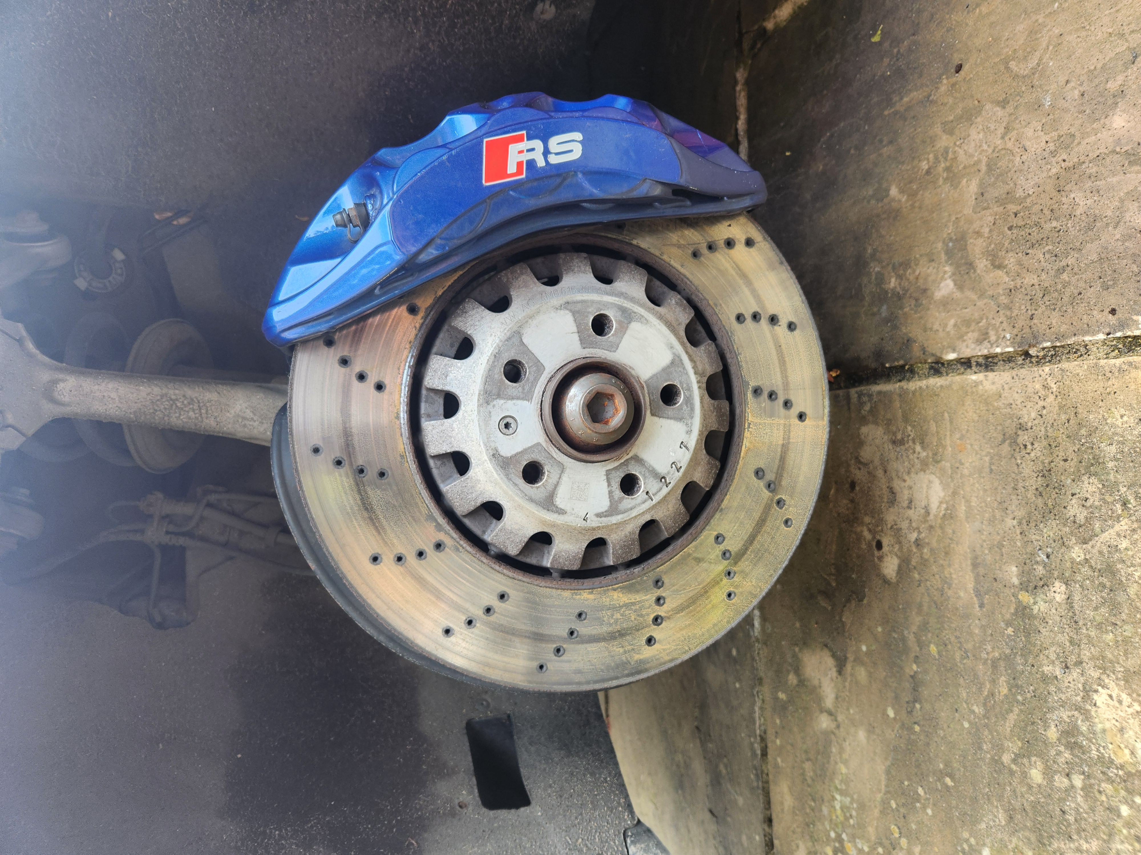

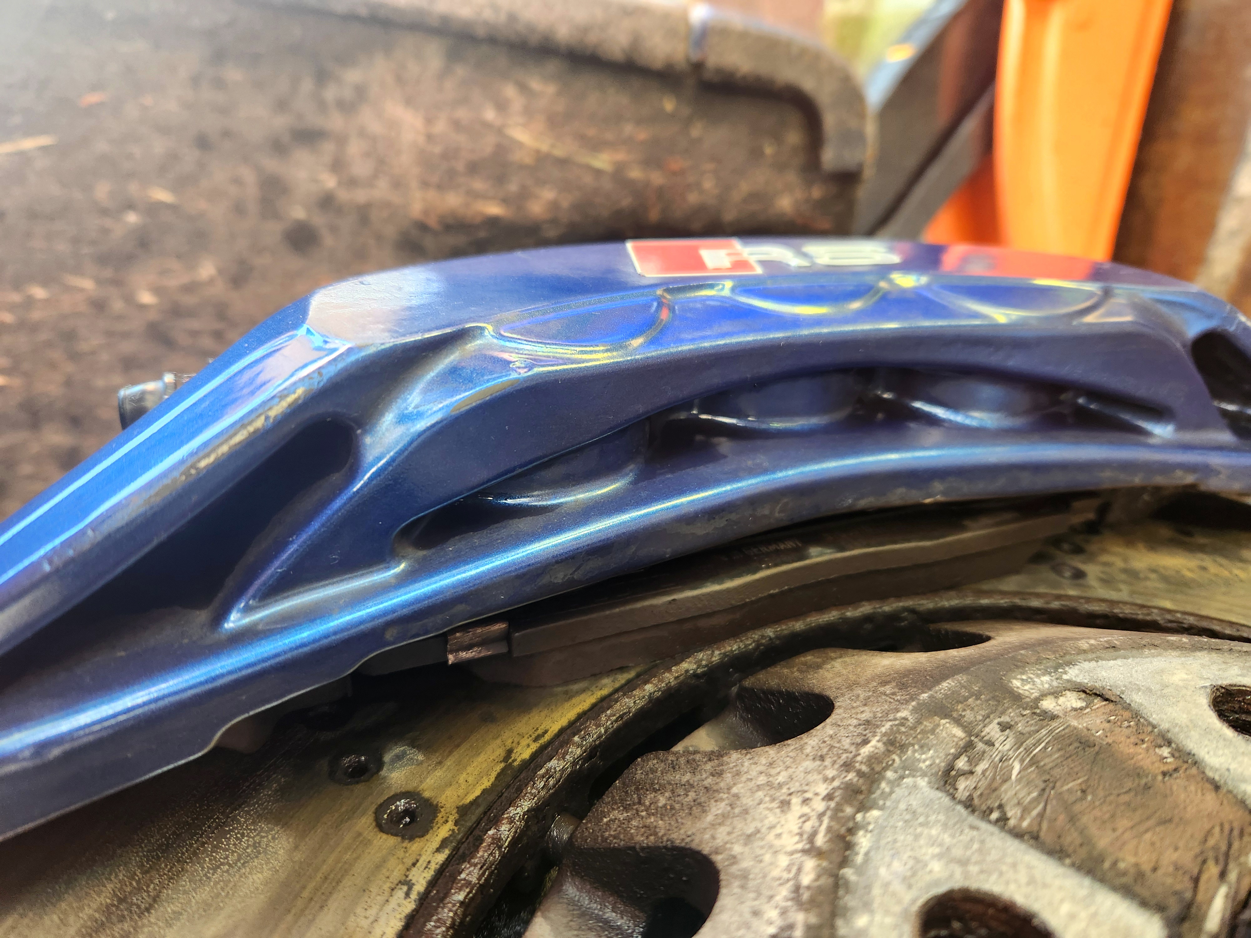

Having read through these posts about discs/pads etc it sounds like a personnal prefernce to all. My front discs aren't the wavy ones, think Zimmerman but cant be sure. Question is, is there a massive difference between the two brands? Also with the Reyland discs, how do they fit with the dust sheilds on?
But, have also read in this thread that the front caliper has 4 pads per caliper?!! Is this correct? Only checked mine the other week as put a ceramic coating on wheels, 2 pads per caliper!! Which is correct?
