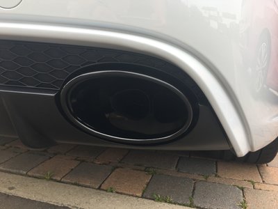

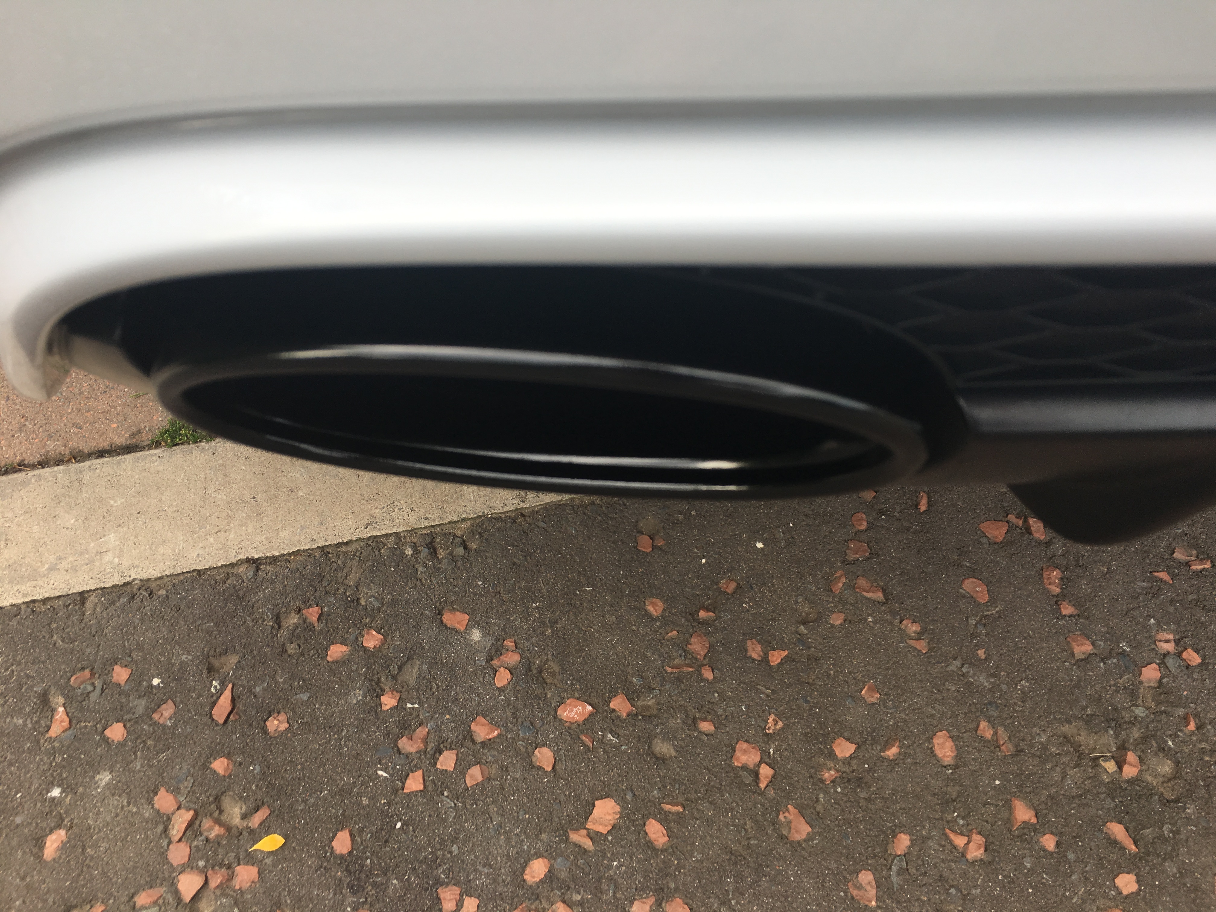

Hi all,
I have the black exhaust tips that come with the sports exhaust on the RS4. They are corroding, signs of oxidisation. I tried cleaning but it seams like the black has come off, what do people do to get it back to looking new? Thanks in advance.

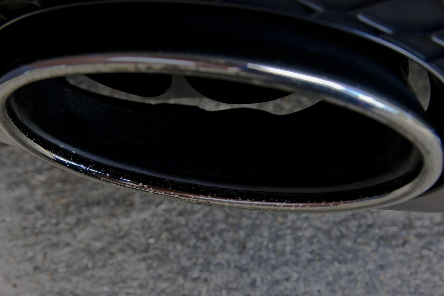

As Noidea says. You can't really do anything except replace with new, or remove and get powdercoated. The original surface just pits and chips unfortunately, so cleaning them up only then highlights the issue further. Mine had covered 17k miles and looked like this, Audi refused to replace under warranty.
OEM tips
