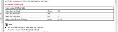

Post by Alex@Fontain » Thu Jun 07, 2018 10:00 am
Small lip is normal wear and nothing to worry about.
This is Audi's guidance on disc wear:
Alex, interesting that they have an actual measurement for the level of allowable runout on the discs. Audi were concerned about this on mine but they dealt with the slight lip and cleaned up the bell housing. They tried to charge me but I pushed back and they did it under warranty.

innercry666 wrote:
Thu Jun 07, 2018 4:37 pm
Of course there is a limit on run out. Even aftermarket cheap discs say to measure the run out - but no one ever bothers to read the paper instructions..... let alone actually do it!

The disc bells are very thin on these, run out can easily be developed if all faces aren’t perfectly clean and free from burrs (even rust). Also, wheels should be torqued up correctly to prevent further uneven loading through bell clamping.
