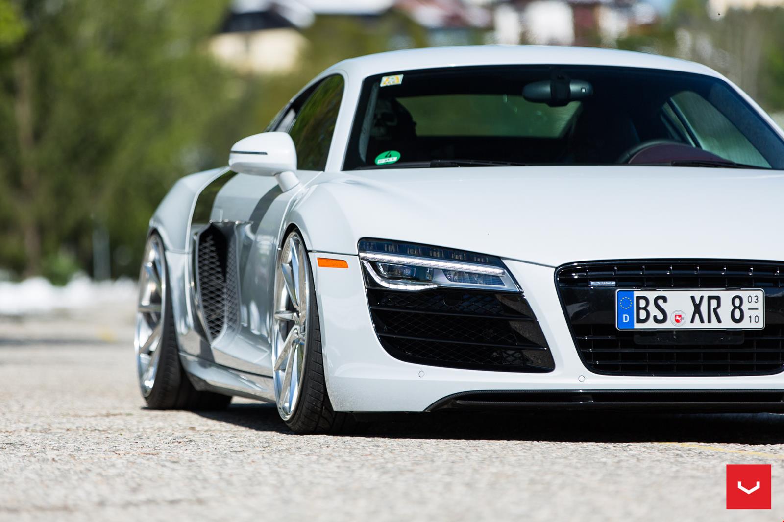

If you look at the R8 in the image below, you will see that the front wheel is a 20"x9" with a flat profile. I'm 99% sure that the 20"x10" has the same flat profile. The rear wheel is a 20"x10.5" with a deep concave profile.

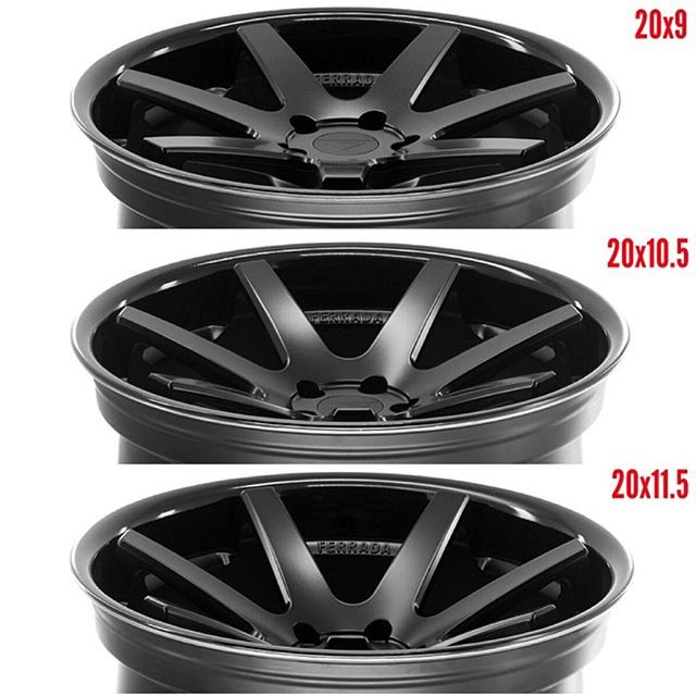

The following image is of the Ferrada wheel design and demonstrates how concavity can be enhanced by using a wider rim.
So, in answer to your question, the reason for going from a 9" (or 10") rim to a 10.5" rim is to improve appearance by deepening the concavity.

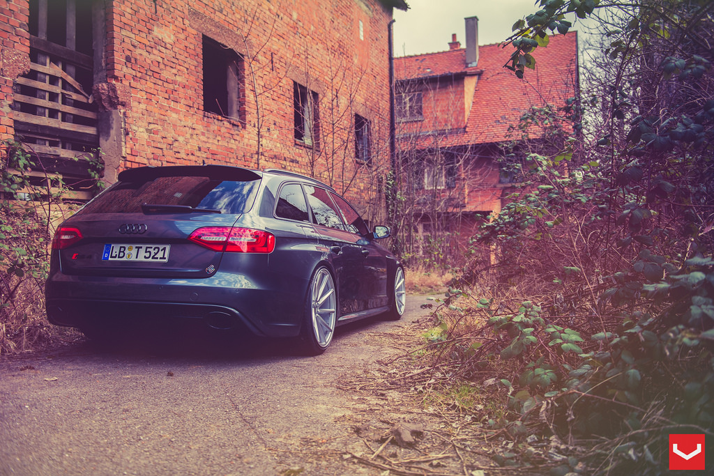

Having said that, the following RS4 is fitted with the 20" x 10.5" CVTs all round AND 265/30R20 tyres but, as I've mentioned previously, the tyres are a real stretch, have an exposed rim (i.e. offer zero protection against kerbing) and are not recommended from a safety point of view; they might even invalidate your insurance if your insurer is not notified in full and even then you run the risk of them not insuring your vehicle.
