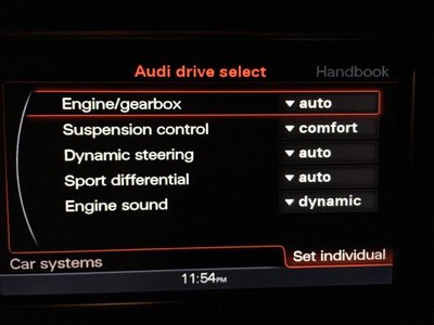

I use individual all the time and pick my settings, this is the ideal choice for me. I can't remember them all and the wording but I know the steering is Auto so at low speeds it lighter and and at higher speeds its heavier and you don;t wander all over the road. The lock to lock changes too as wheel as the weight.
My INDUVIDUAL settings are:
