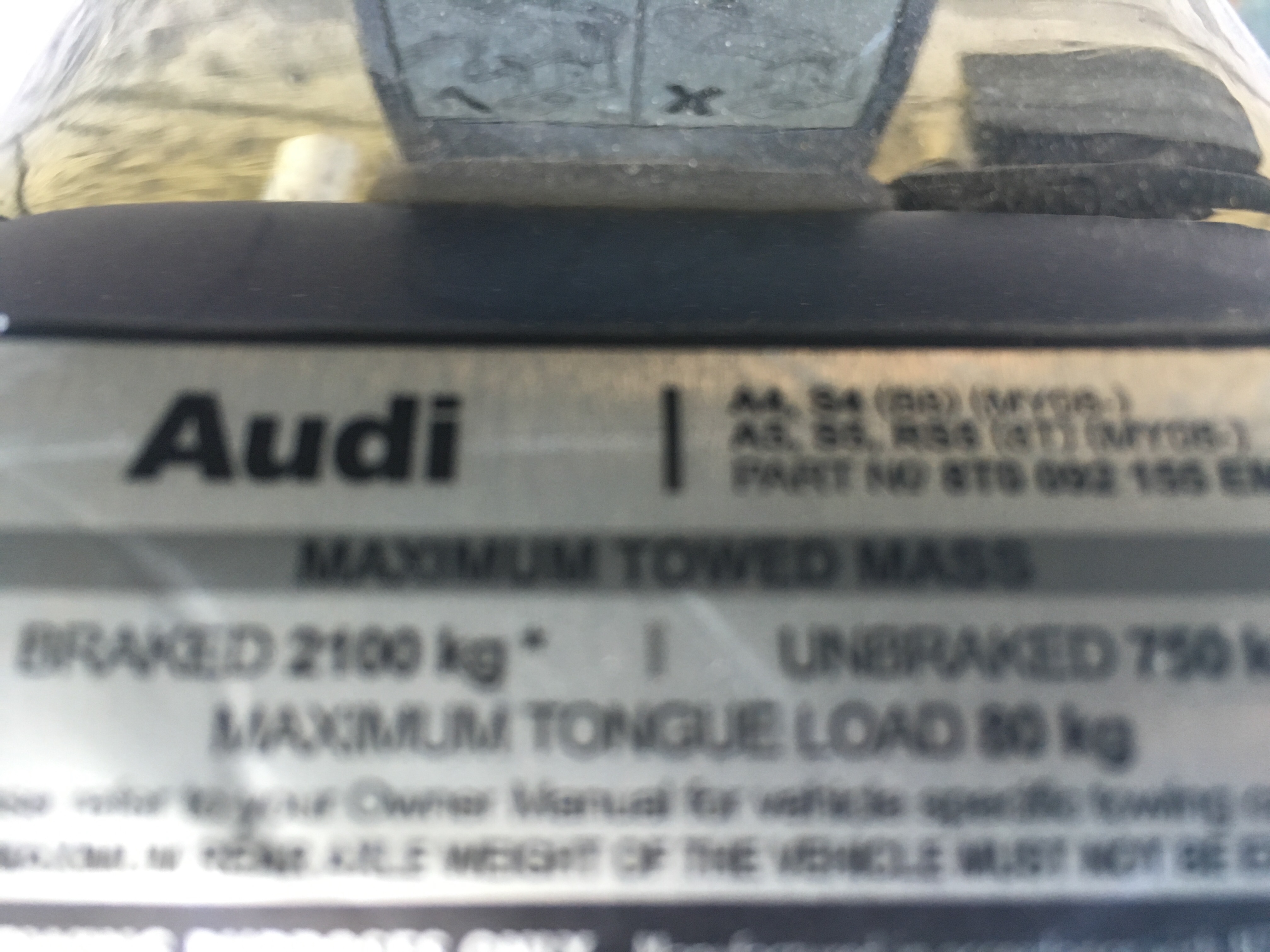

Ok now I'm confused. My tow hook was supplied as a genuine part by the dealer and I had to wait a few weeks for a special wiring loom to come from Germany so the electrics on the trailer would work correctly and not interfer with the on board electrics in my RS4. I have managed to take the attached photo of the label on the tounge of the tow bar, it was very difficult to take and I couldn't get my iPhone to focus correctly but you should get the idea.

1199Panigale wrote:Ok now I'm confused. My tow hook was supplied as a genuine part by the dealer and I had to wait a few weeks for a special wiring loom to come from Germany so the electrics on the trailer would work correctly and not interfer with the on board electrics in my RS4. I have managed to take the attached photo of the label on the tounge of the tow bar, it was very difficult to take and I couldn't get my iPhone to focus correctly but you should get the idea.
So what you have is a genuine Audi part - it's just that it's illegal for it to be fitted to an RS4 in the EU (because Audi didn't think it was worth the extra cost of the homologation testing with a towbar fitted on the RS4).
But that doesn't mean it isn't 100% fit for purpose and legal in other countries, such as NZ.
