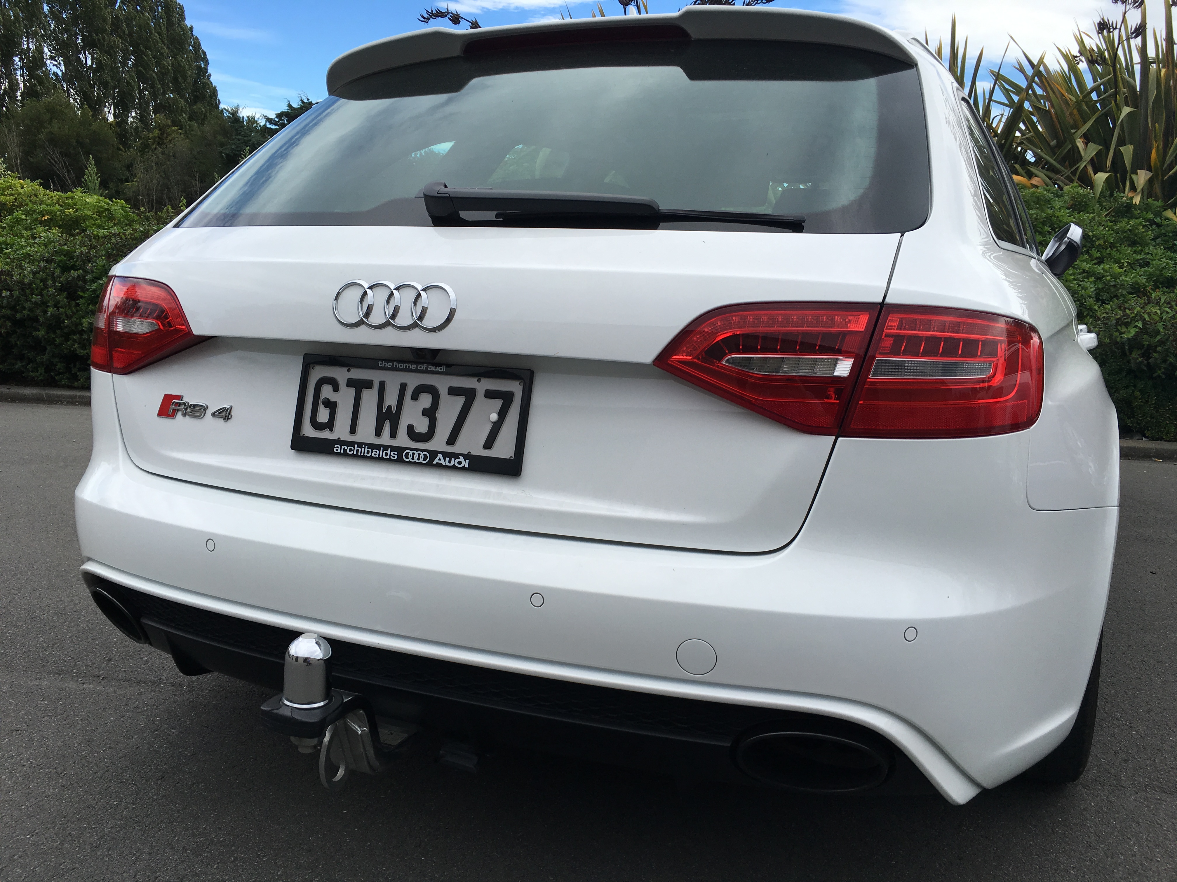

Yes that was me, I have a toe bar/hook fitted to my B8 RS4. I ordered it with the car as It was a case of no tow bar, no RS4. It took a few months to get sorted back in 2013 as the electrical loom was not available yet and the dealer told me that this was the first B8 RS4 that Audi had fitted with a full tow bar and electrical connection. The rest diffuser does need to be cut but you can't see it unless on a hoist and the bar itself is standard A4 as understand it. I have some
Pics somewhere...
As for towing, it's just fine. I did tie a caravan once for around 100 miles and the fuel consumption was astonishing.
Pics somewhere...

Yes it can be removed but not easy as the rear diffuser blocks the access to the pin that needs to be removed.
