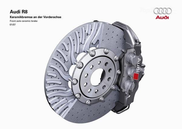

They don't have drain holes as such, only internal venting, which can get blocked up with crap pretty easyPando99 wrote:exactly, very disappointing after getting the wheels clean. Makes me wonder if a drain hole is blocked, this will lead to corrosion issues
Will try googling it to see what is out there
On a steel disc, the holes are pretty small, but water in there won't cause any corrosion issues as the steel used is super hard, so you'd need to leave salty water in there for probably years for it to do more that barely corrode the surface
Ceramics have much larger internal vents, so shouldn't retain much water, although you'll always get a bit in the horizontal vanes and some of the funnier shape ones. You could probably get the water out by driving 6 foot slowly down your drive after washing I appreciate this is an out of date R8 disc, but the technology's the same
