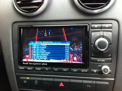

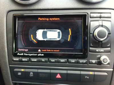

I now have fully integrated RNS-E High Acoustic Parking Sensors front and rear... as well as my trusty Digital TV tuner with High Diversity Aerials (was woking fine at over 130mph on the autobann honest!) TV in motion (coded by SatNavSystems)
Acoustic Parking Sensors - just like a factory option!

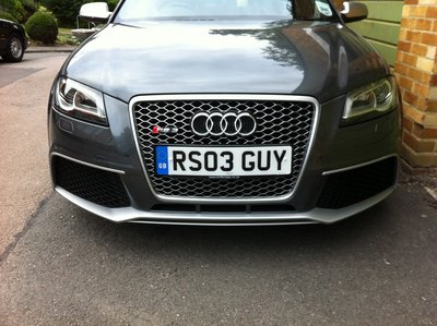

The RS3 front bumper does not have pre-marked holes for the sensors.
And finally got round to getting my new plate transferred at DVLA in Wimbledon:
Oh - and I got round to putting my new plate on too
TV tuner, unfortunately not controlled by the RNS-E buttons but the TV remote works a treat.
TV tuner...

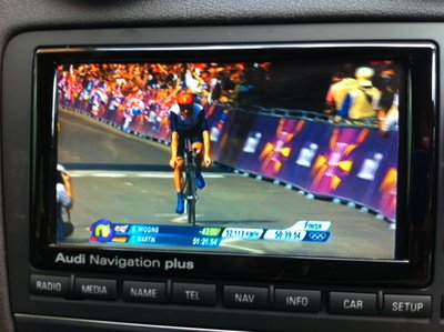

And one of Wiggo winning his gold to be topical:
Wiggo!

Front parking sensors?!! Come on, you can see the front of the car, it's not exactly large :smile_smoking:

I was more interested in getting the acoustic display working through the RNS-E - you can get the sensors upgraded and fitted for about £500
