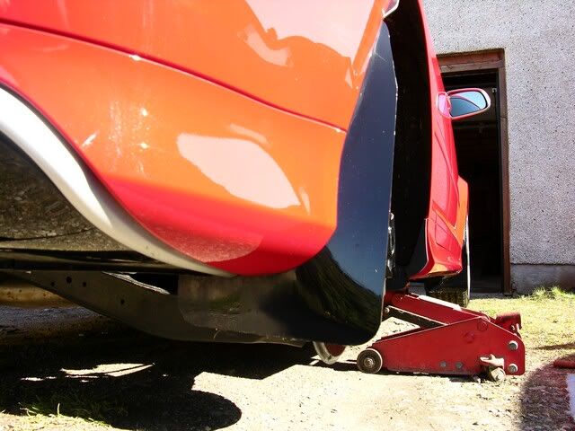

A few people have PM'd me about the pic in the "Rogues Gallery" of my RS3 commenting on the mudflaps which are fitted, so decided to take a few pics and post for those who are interested. Audi as I am sure you all know dont do mudflaps for the RS3 or the S3 for that matter so I am afraid you will have to improvise as I did. Mudflap material was purchased from Demon Tweeks, they do a double sheet set for about £20 which is enough for all 4 wheels. This is quite thick material which is great as it holds its shape and does not flap about about in the wind
To size these things properly and get the holes in the right place the best way is to play about with a bit of cardboard and scissors, however as you will see from the pics you can make full use of the existing screws on the inner liners and there is no need to drill.
Pic 1 showing a view of the rear flap from behind

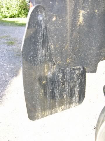

and a view showing the inside which if you look closely you will see two screw heads from the original liner screws which secure (these two are more than enough to hold ), sorry about the crap, they are mudflaps after all!

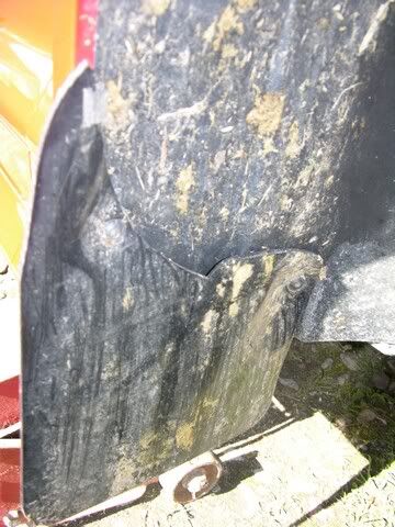

Now a view of the front from the rear
This was deliberately sized quite wide to stop crap from being thrown up against the rear arches

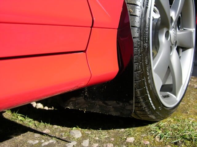

And from the other side
Again if you look closely you will see the two original screw heads, in this case one is towards the inside edge of the flap and the other about two thirds up on the left. Now with the front I have added a small stainless spring clip and the top to keep it in place. This stainless clip is one of these re-usable clips for holding sheaf's of paper together. I used one which will clip about 60 sheets of paper so that it was big enough to go over the mud flap material and clip onto the inner wing. Arrangement works perfectly and is the same that I used on my S3 for tens of thousands of miles without falling off!
Not as neat as factory fitted I will agree, but just as capable, if not more so (as I sized them bigger) at keeping some of the stones and crap of the bodywork and given that the factory dont make them anyway, its the only choice at the moment.
