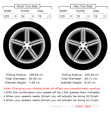

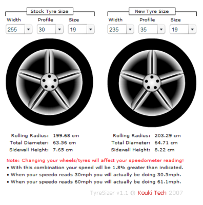

JonG wrote:
Thats too big a difference in rolling diameter IMHO
I note that the Audi upgrade package has 255/30/19 tyres on the front and not 35 profiles, presumably to keep the rolling circumferences similar front to rear.
http://www.audi.co.uk/content/dam/audi/ ... rtback.pdf (page 24)
LMFAO i cant read it does indeed say 30% :knob:
i should read my own tyres :drink:

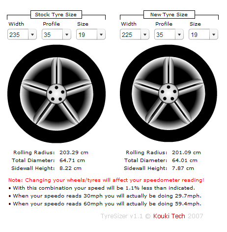

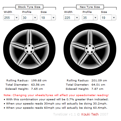

so after an eagle eye viewer spotted the deliberate mistake here are
255 v 235 large front v stock front
255 v 225 large front v stock rear
235 v 225 stock front v stock rear
