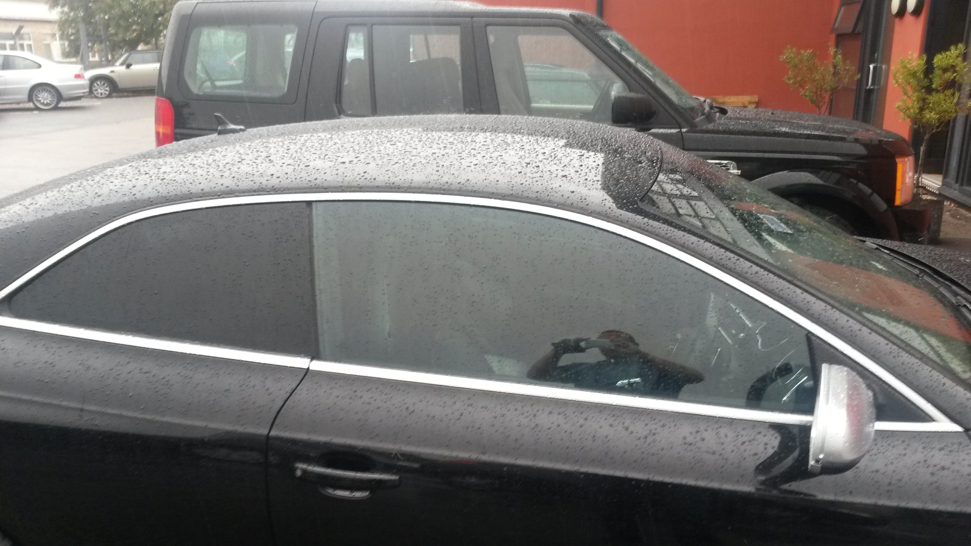

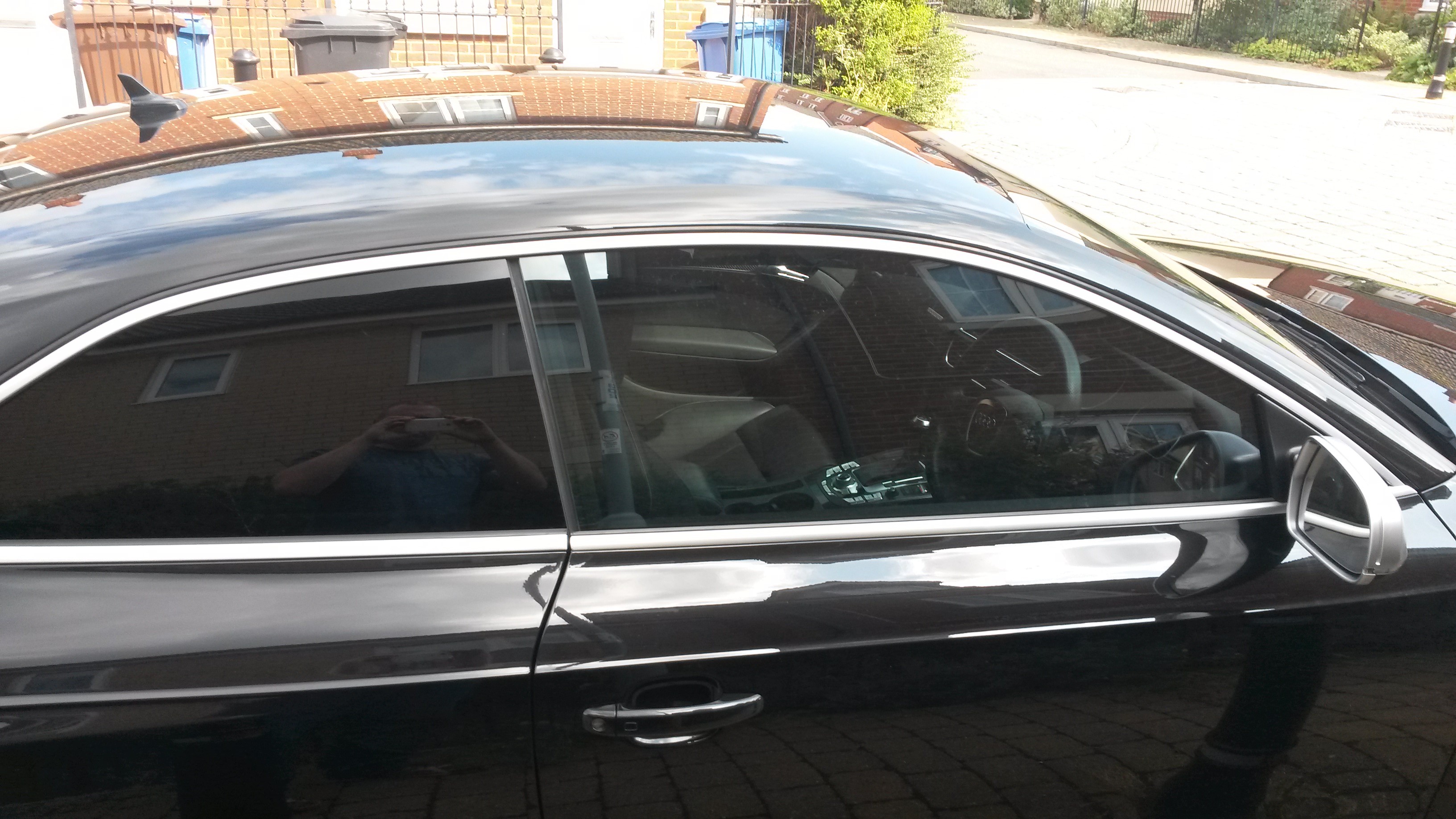

The car came with the audi OEM blacked out windows (not an option I would have ticked due to its severity) so tried to balance it a bit with a front window tint with UV protective tints and had the windscreen UV protected at the same time but with the standard tint level. The first pic was taken just before the work the second a couple of hours later when I got home.

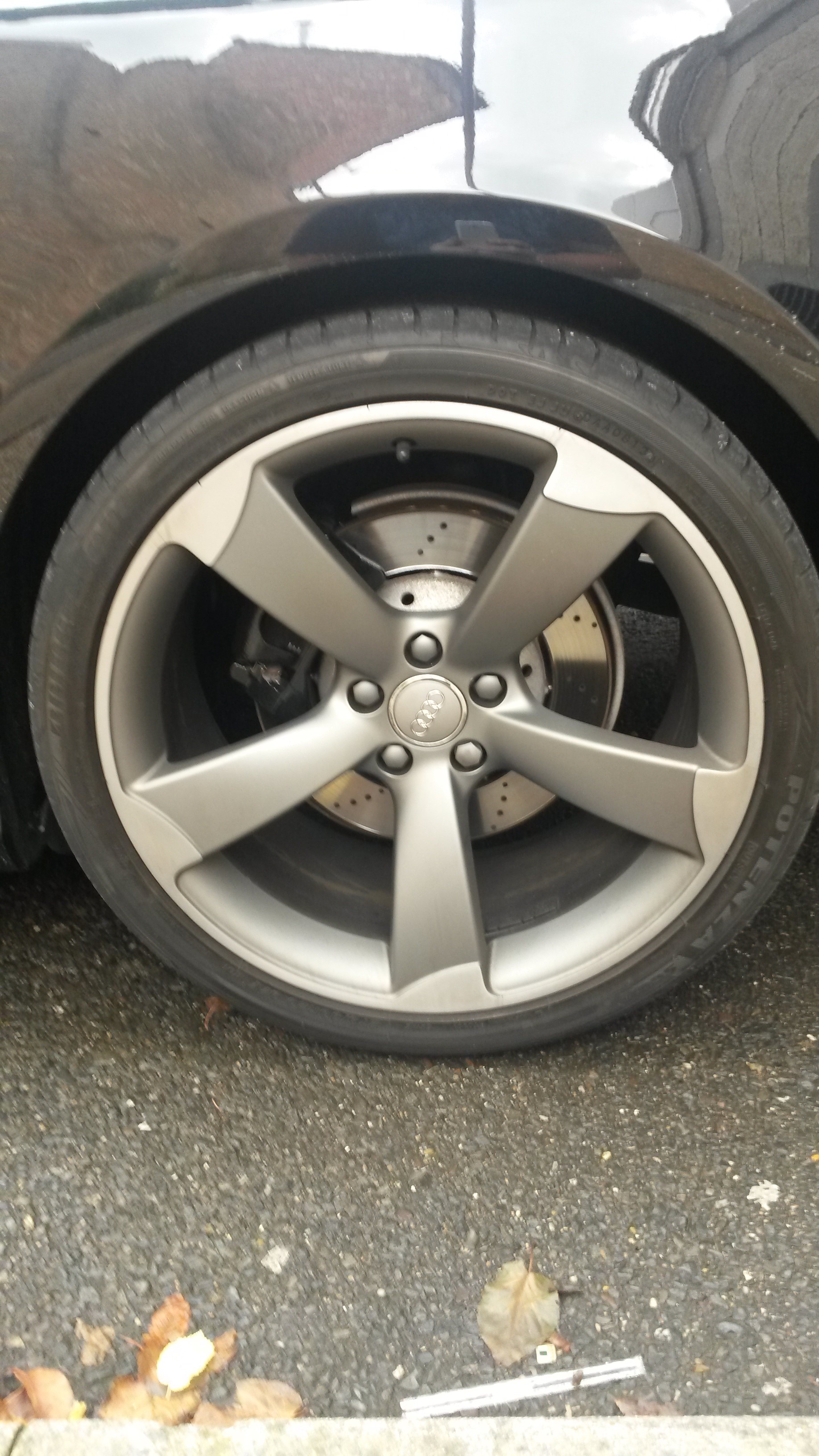

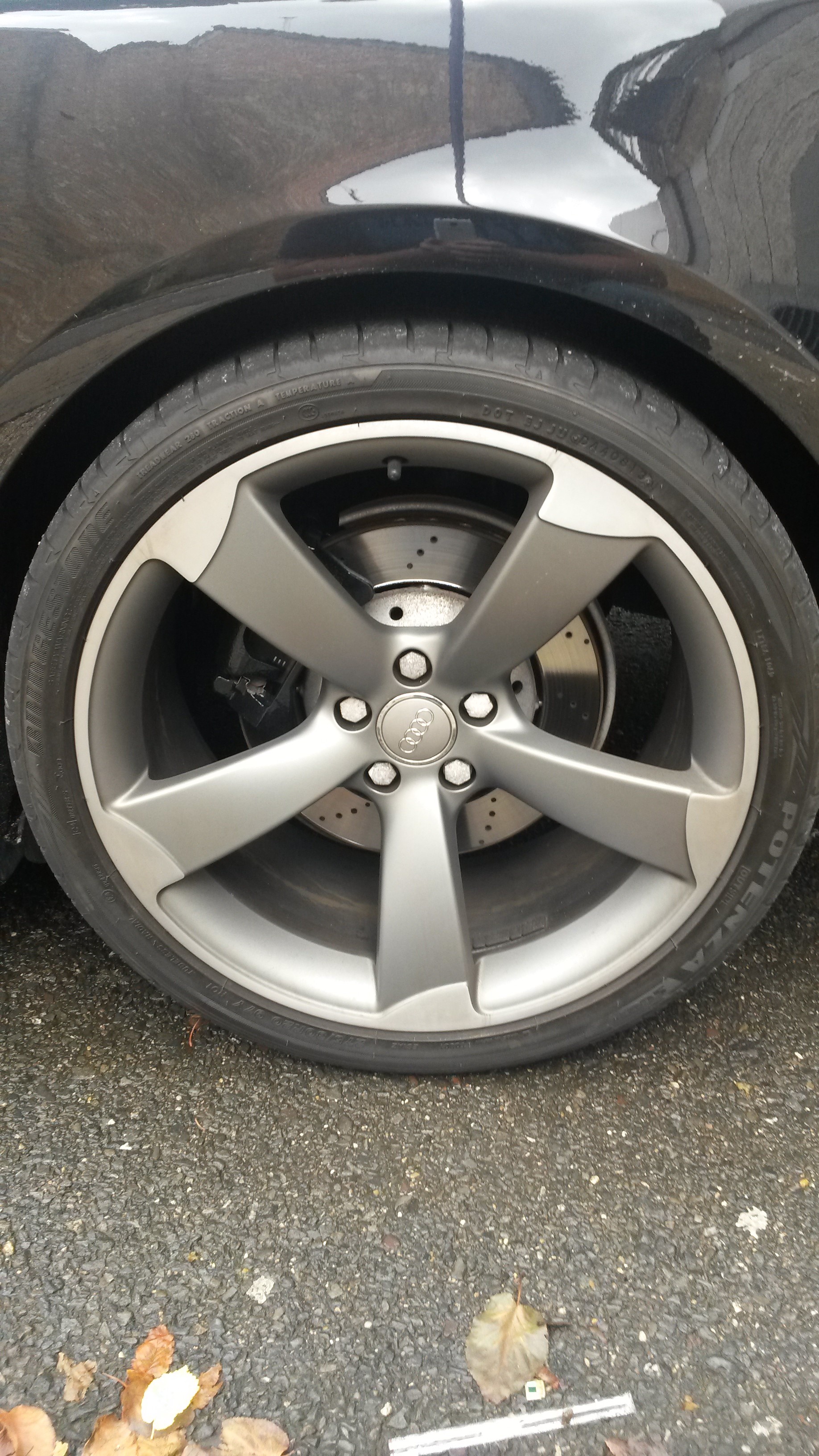

It was kindly pointed out by my buddy Daytonamart on here that the wheel caps looked a it of a mess due to the previous owner suing non-friendly products when the car was cleaned. To be honest they looked like a corroded steel or even a chalky like effect. They certainly made the wheels look a lot worse so a quick trip to Audi and a short time later got some new bolt caps. Instant difference.

Well 15 mm spacers on the front is a no no. The wheel protrudes too far and would be illegal. 10 mm on the front is just about fine that being said it makes it look slightly wider at the front than the back so I will be taking them off tomorrow and will see how it looks without any on but lowered with springs instead. Also tried 10mm on the rear but again the wheel protrudes too far. All in all not a good start.

All spacers back off now. After trying them on I found that if you want that flush look you would have to go smaller which means flats instead of hubcentrics. Will get the car lowered and hope that will be enough to give it more presence.

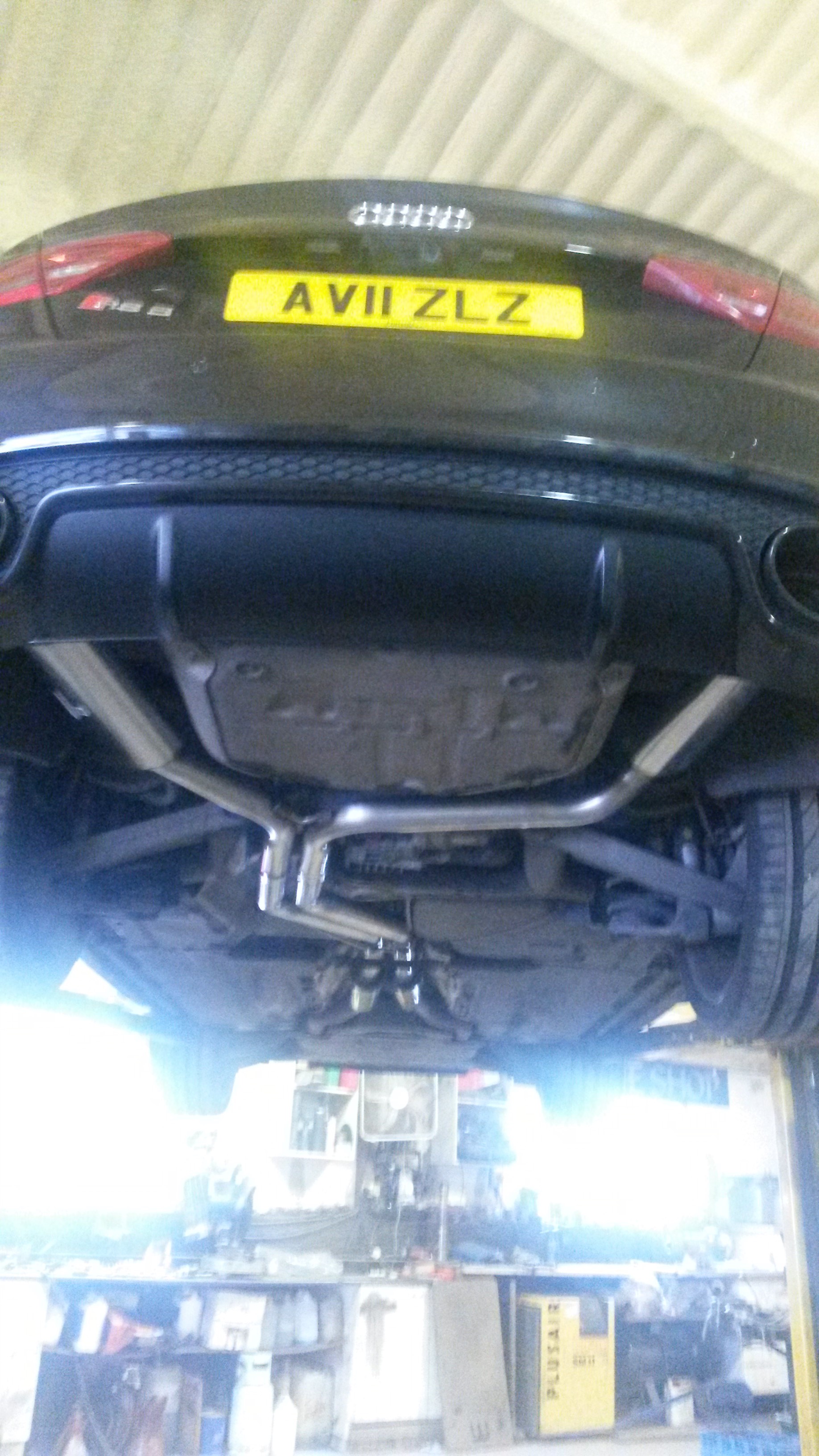

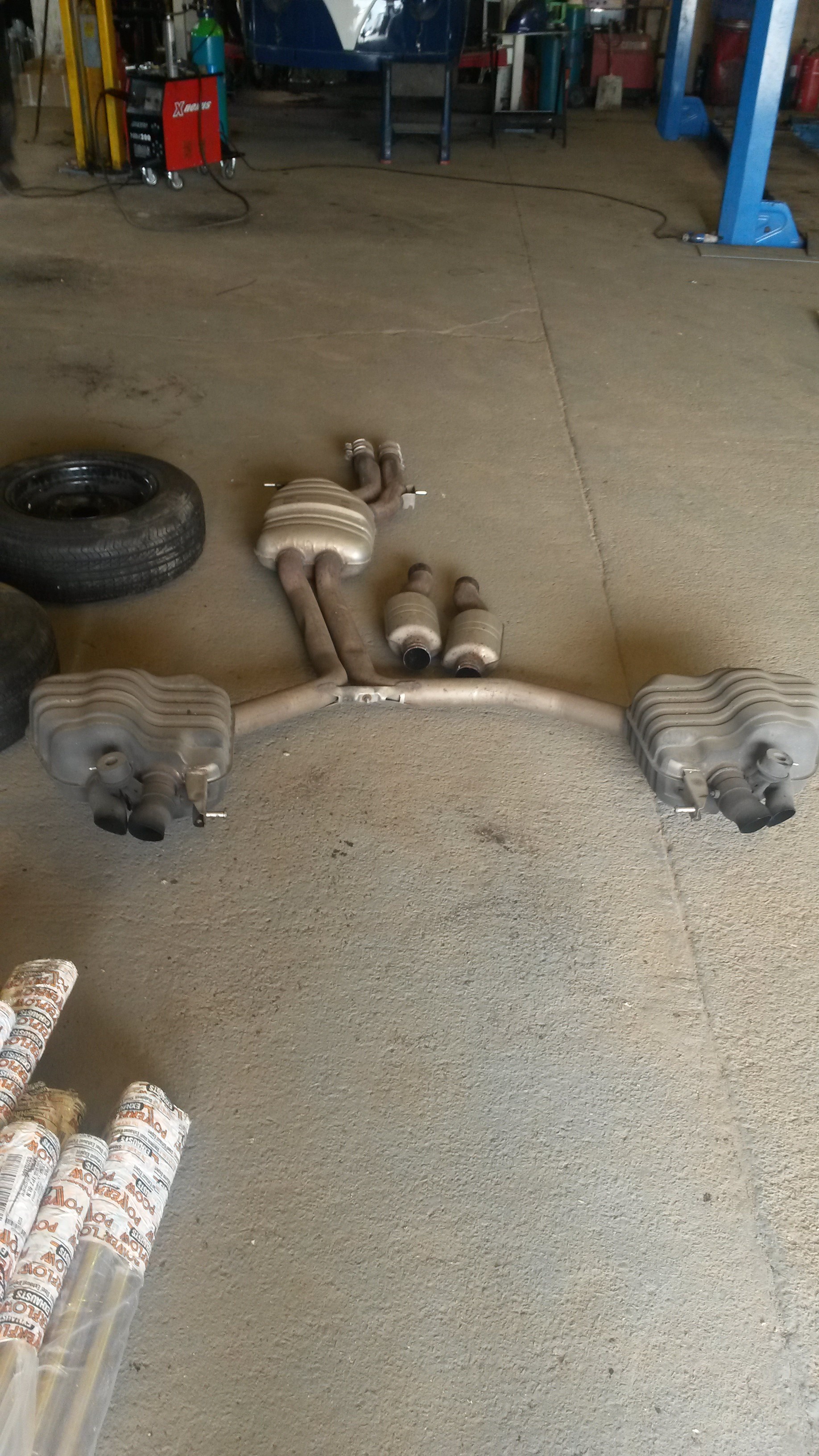

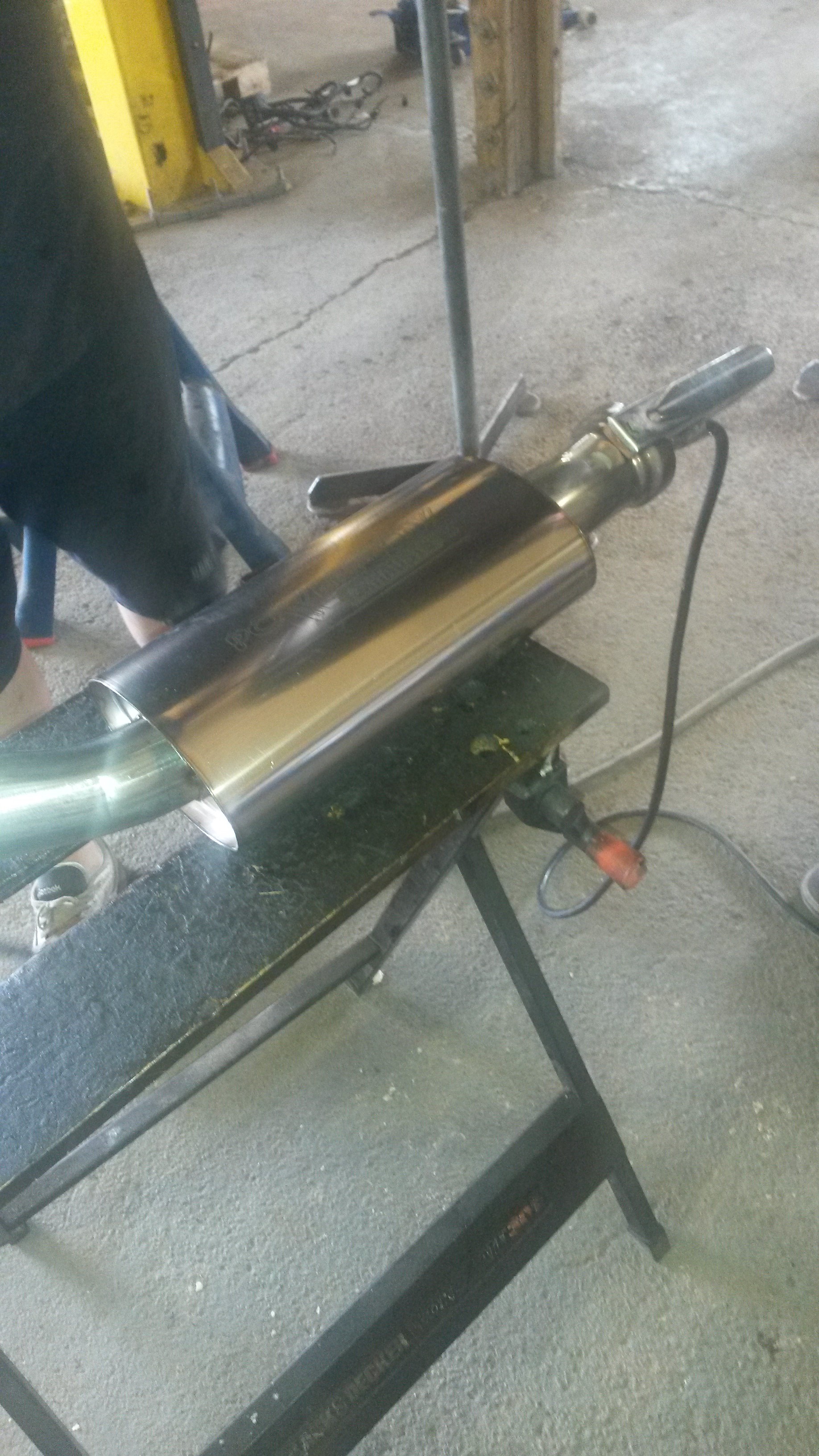

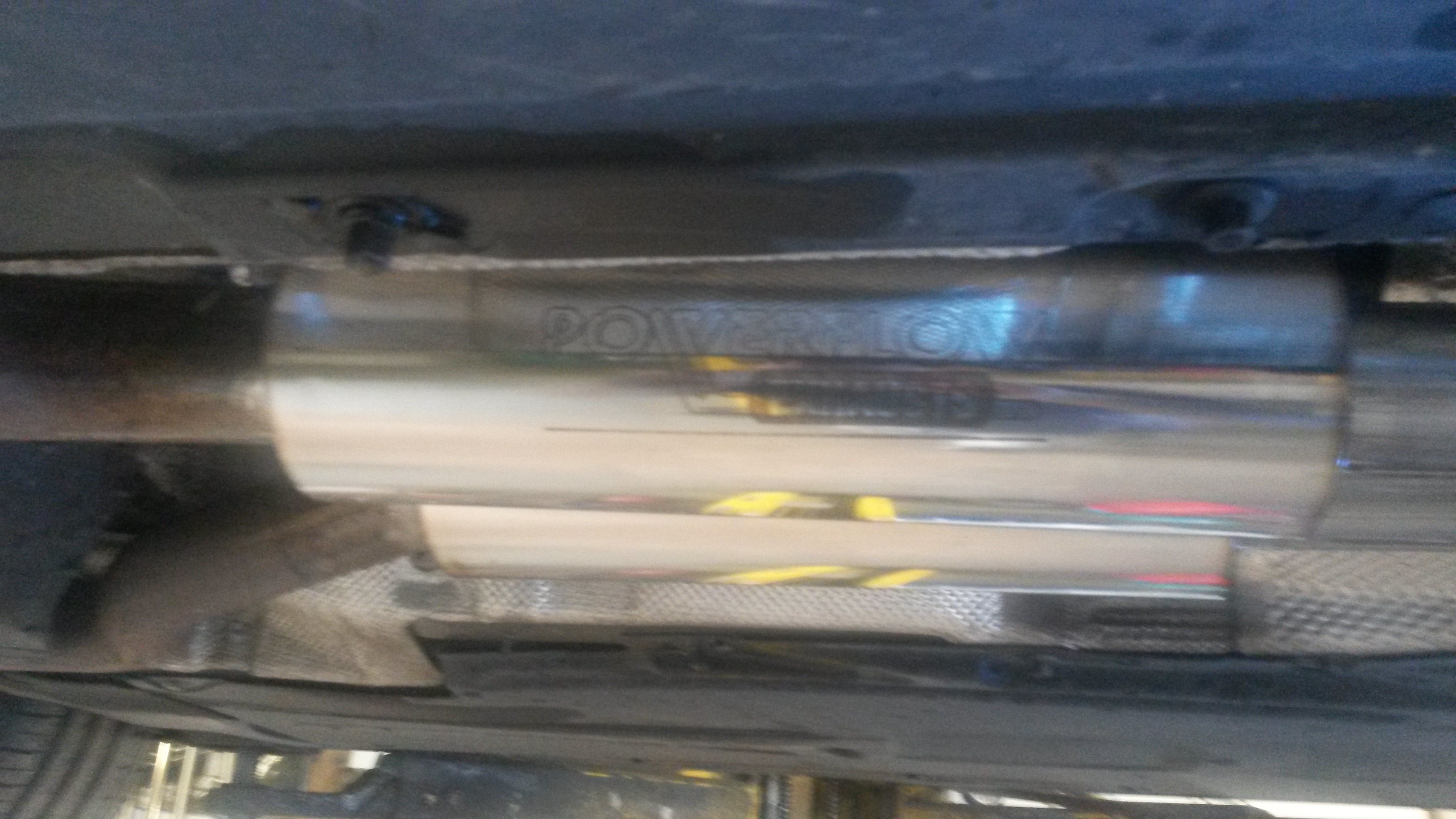

Well exhaust was done today, as before went to the guys at ISC Racing near me have done a superb job again. A massive thanks to Simon and the rest of the guys. Great value and a super smooth sound. But wonder if the police will pull me for it :bash:

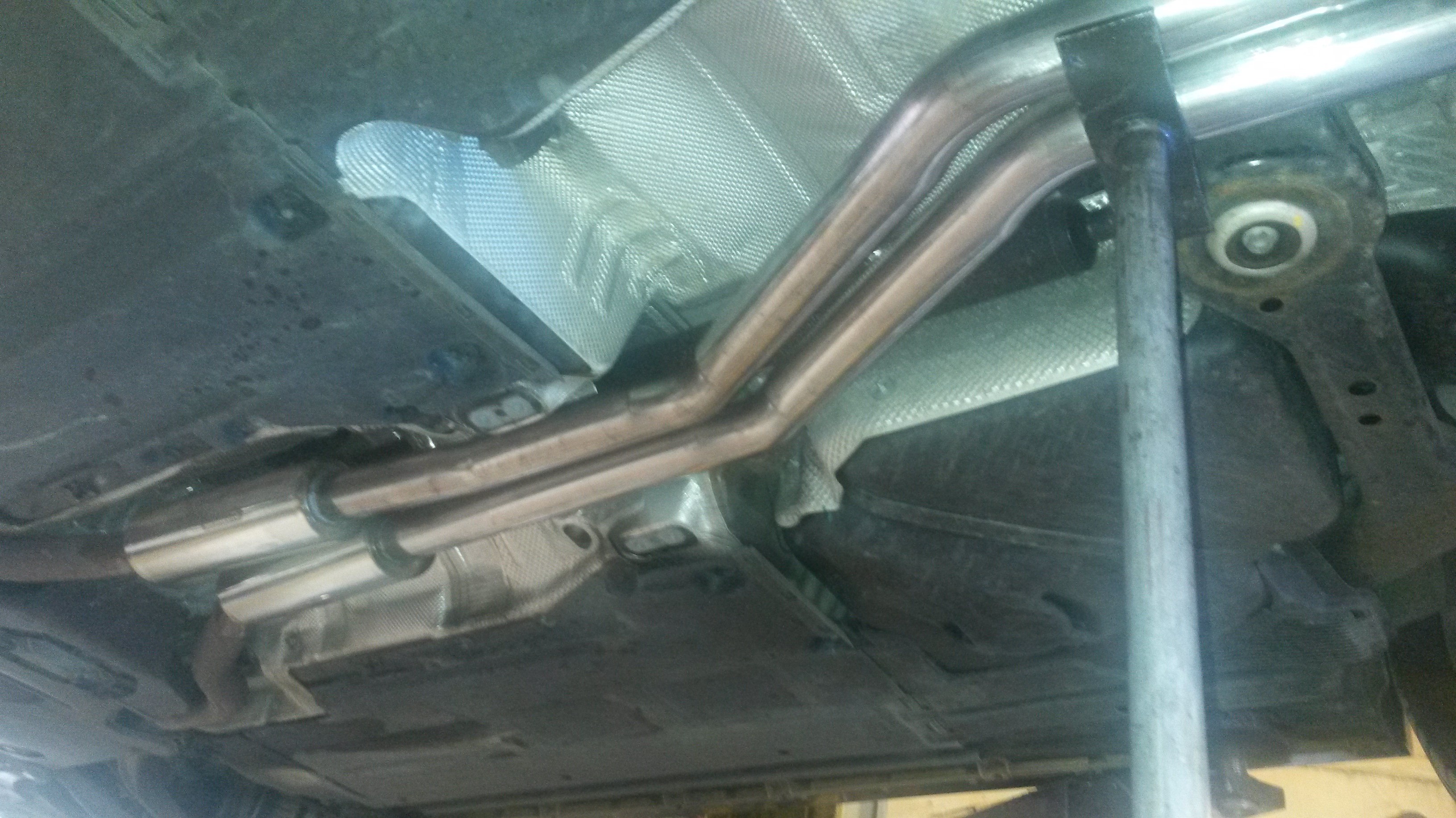

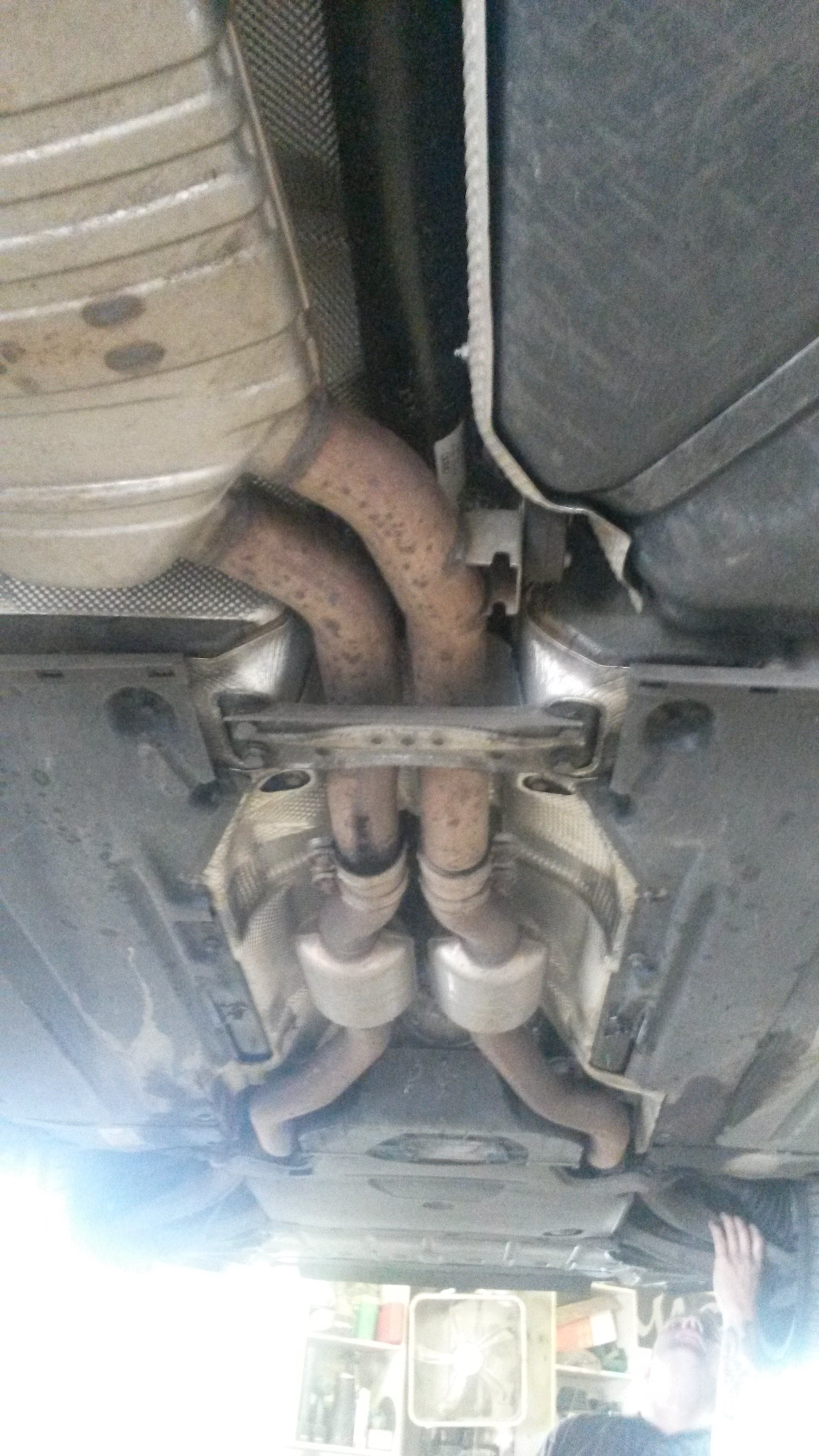

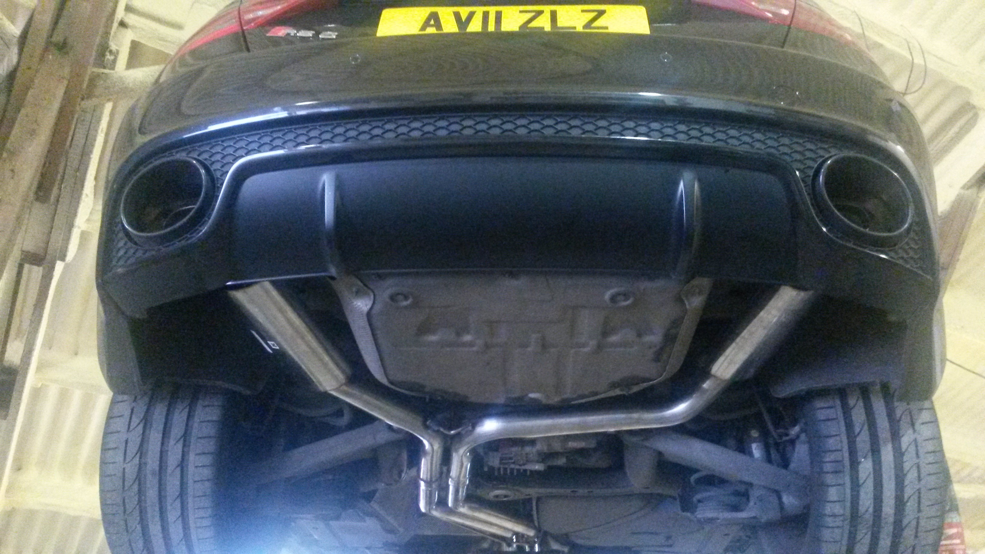

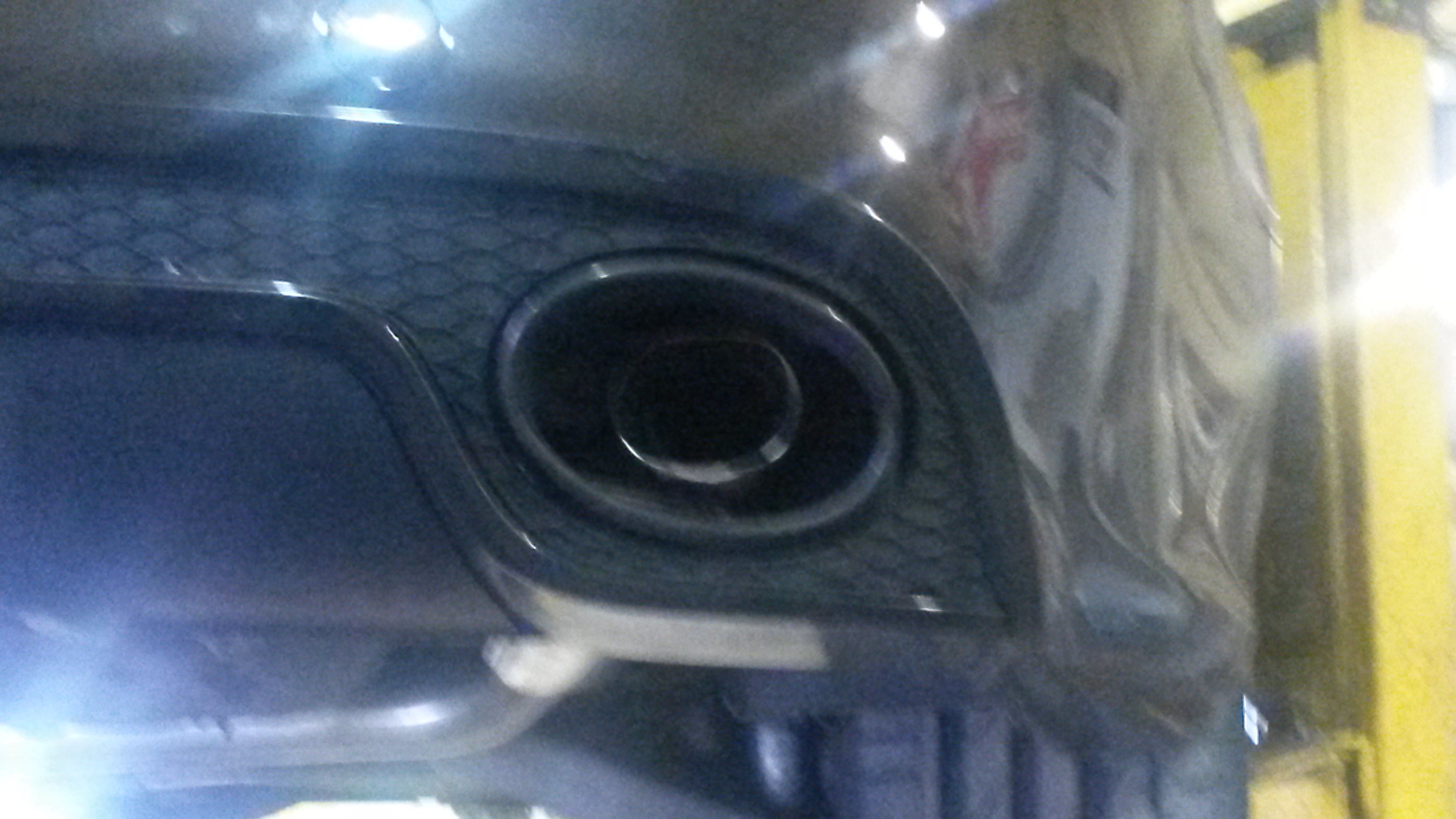

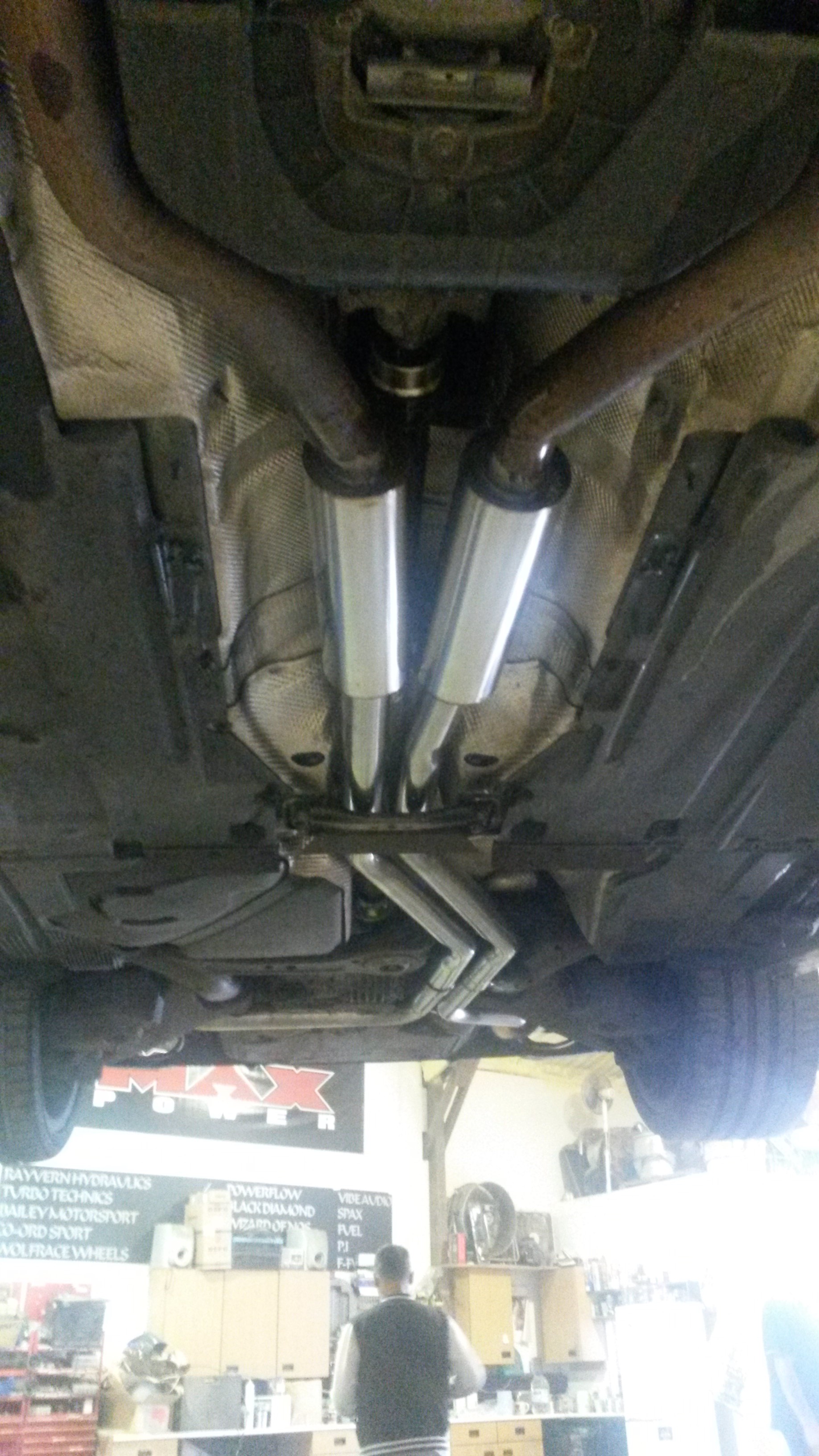

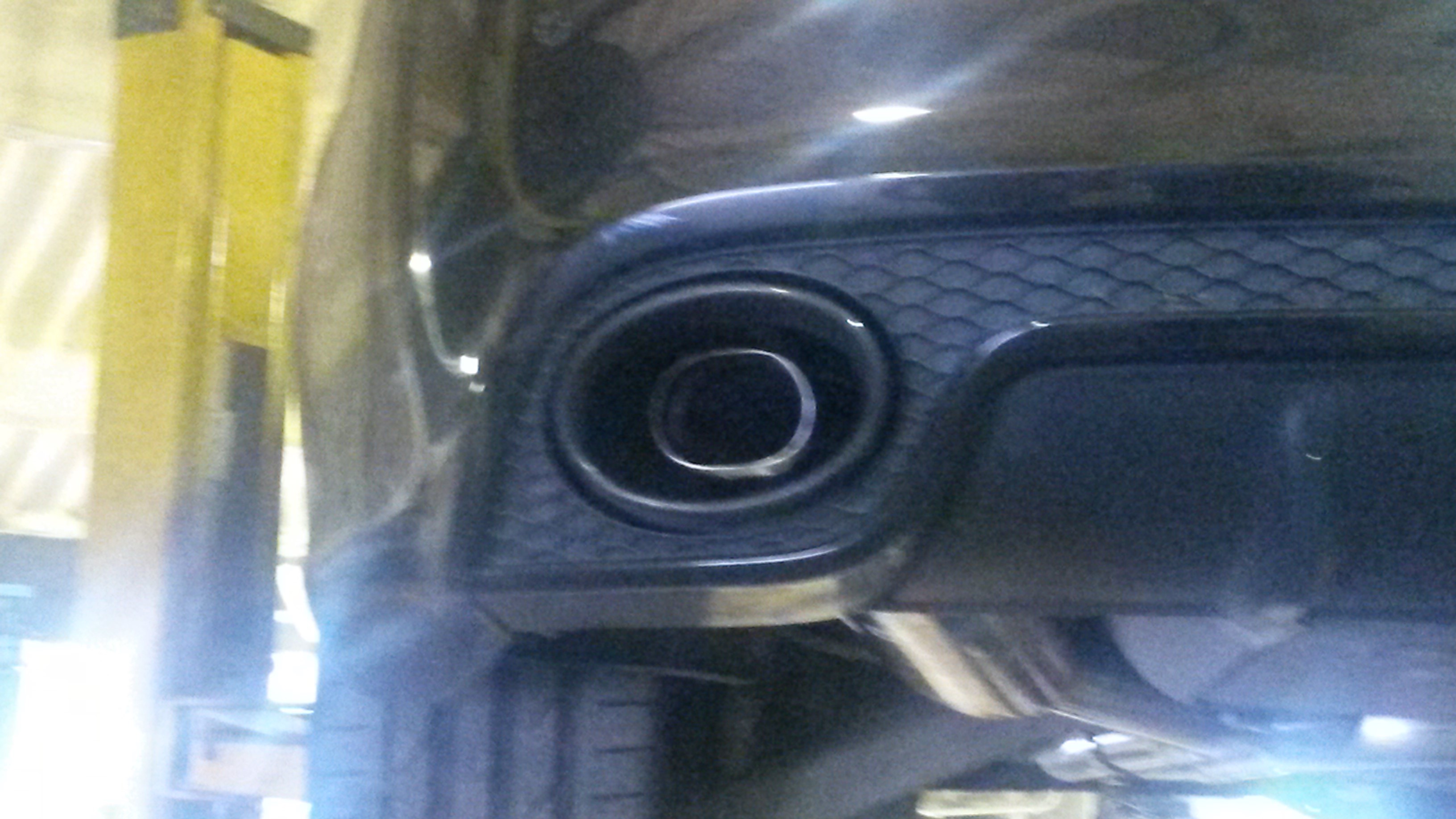

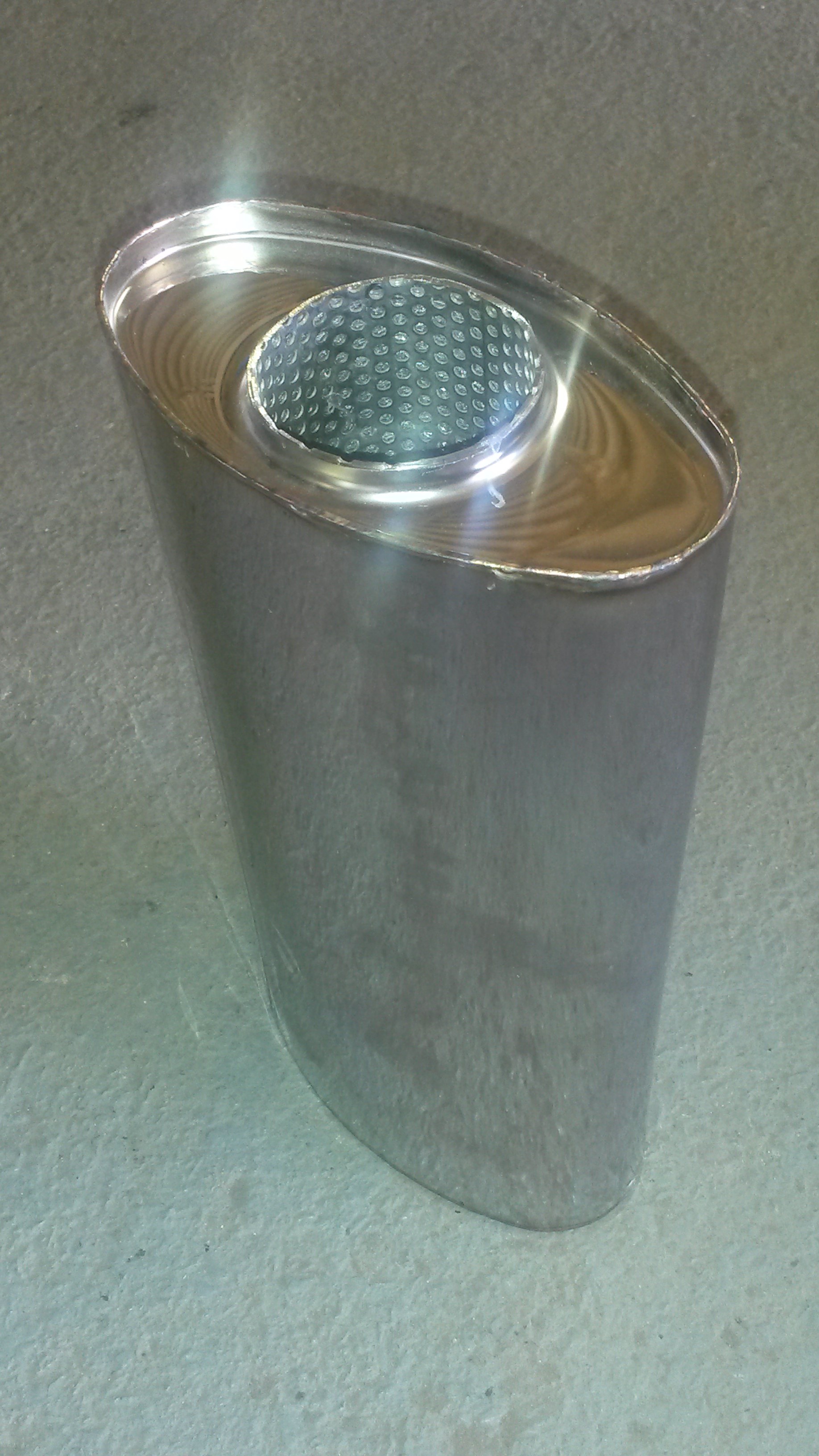

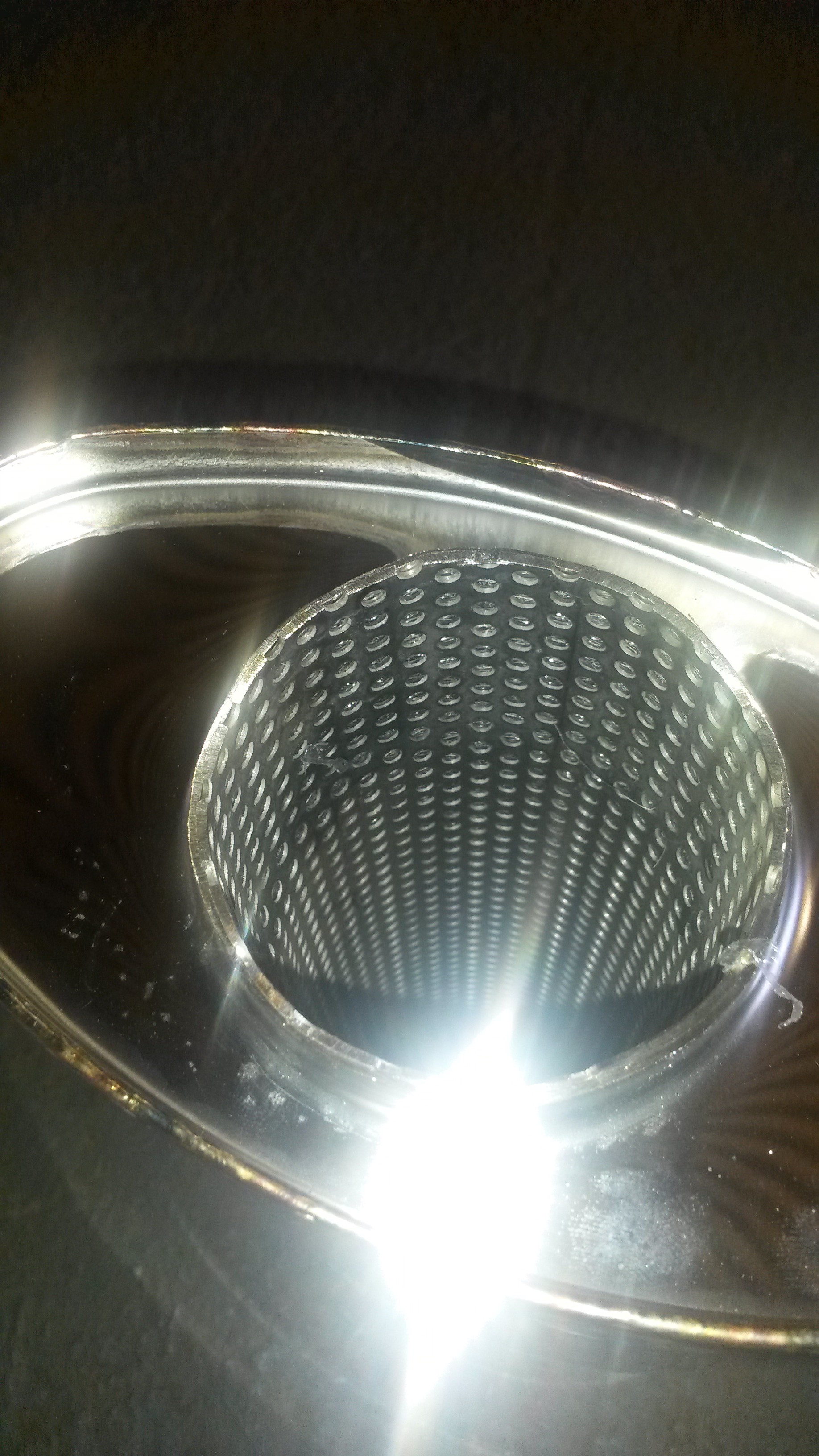

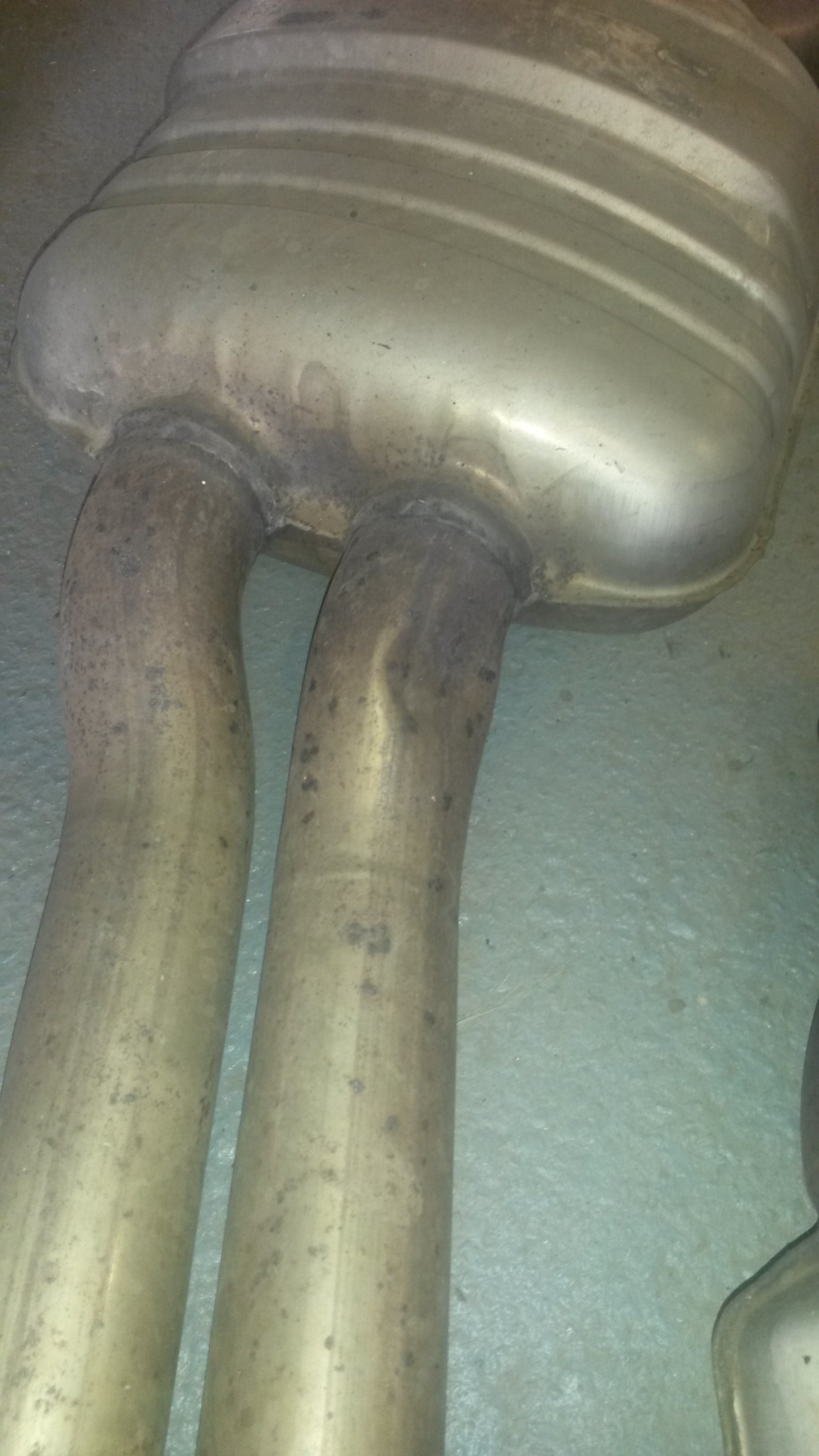

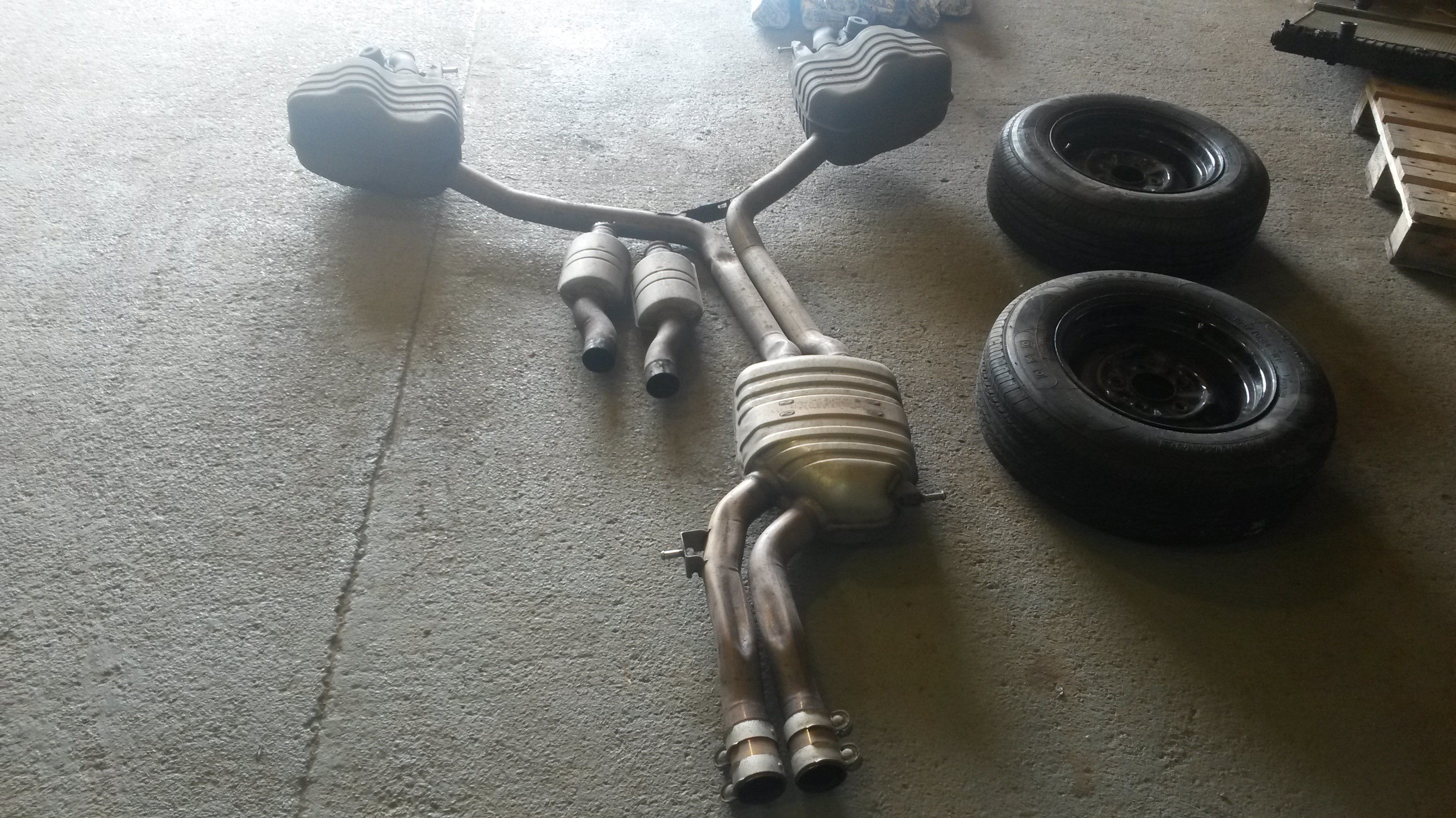

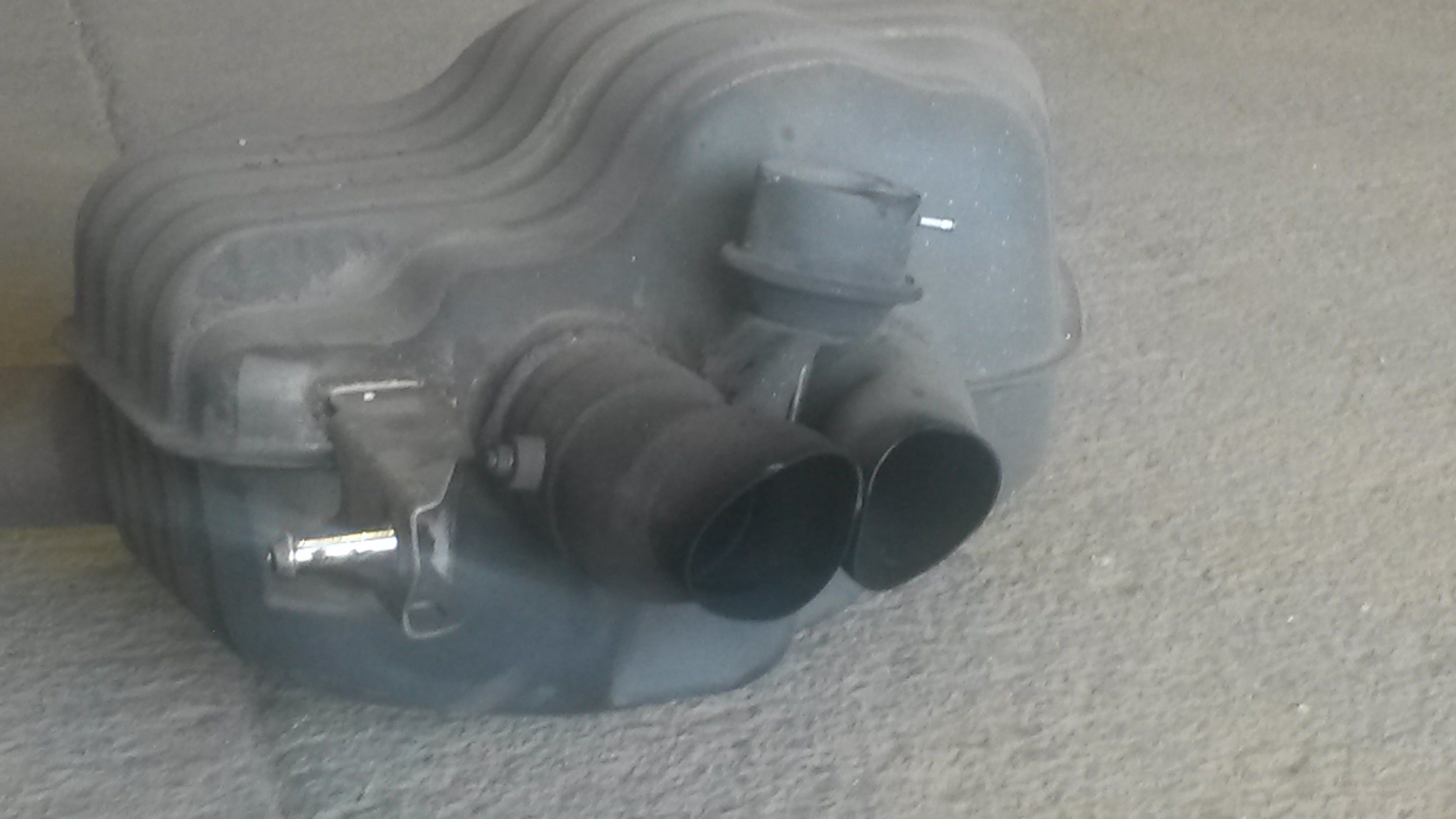

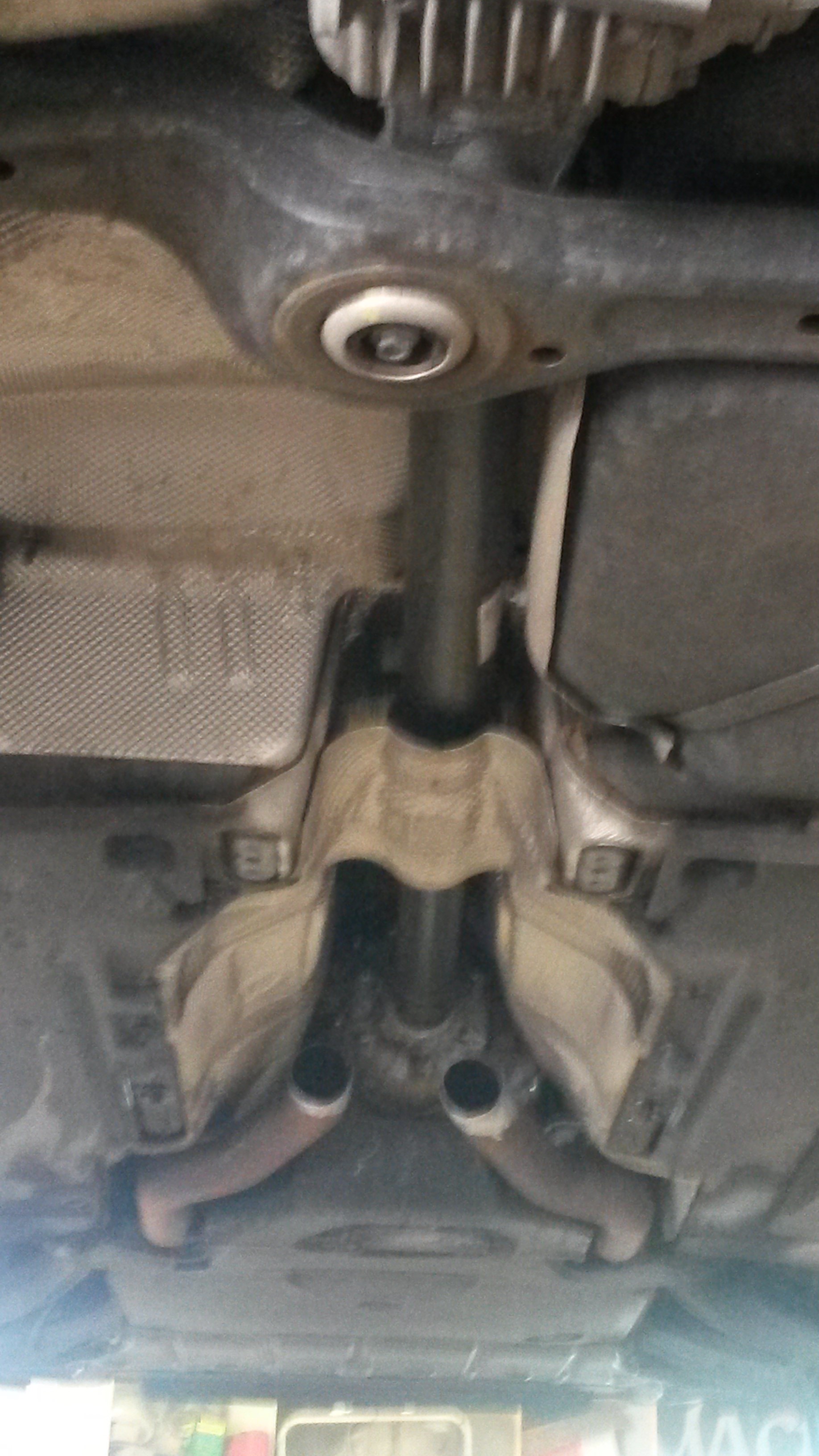

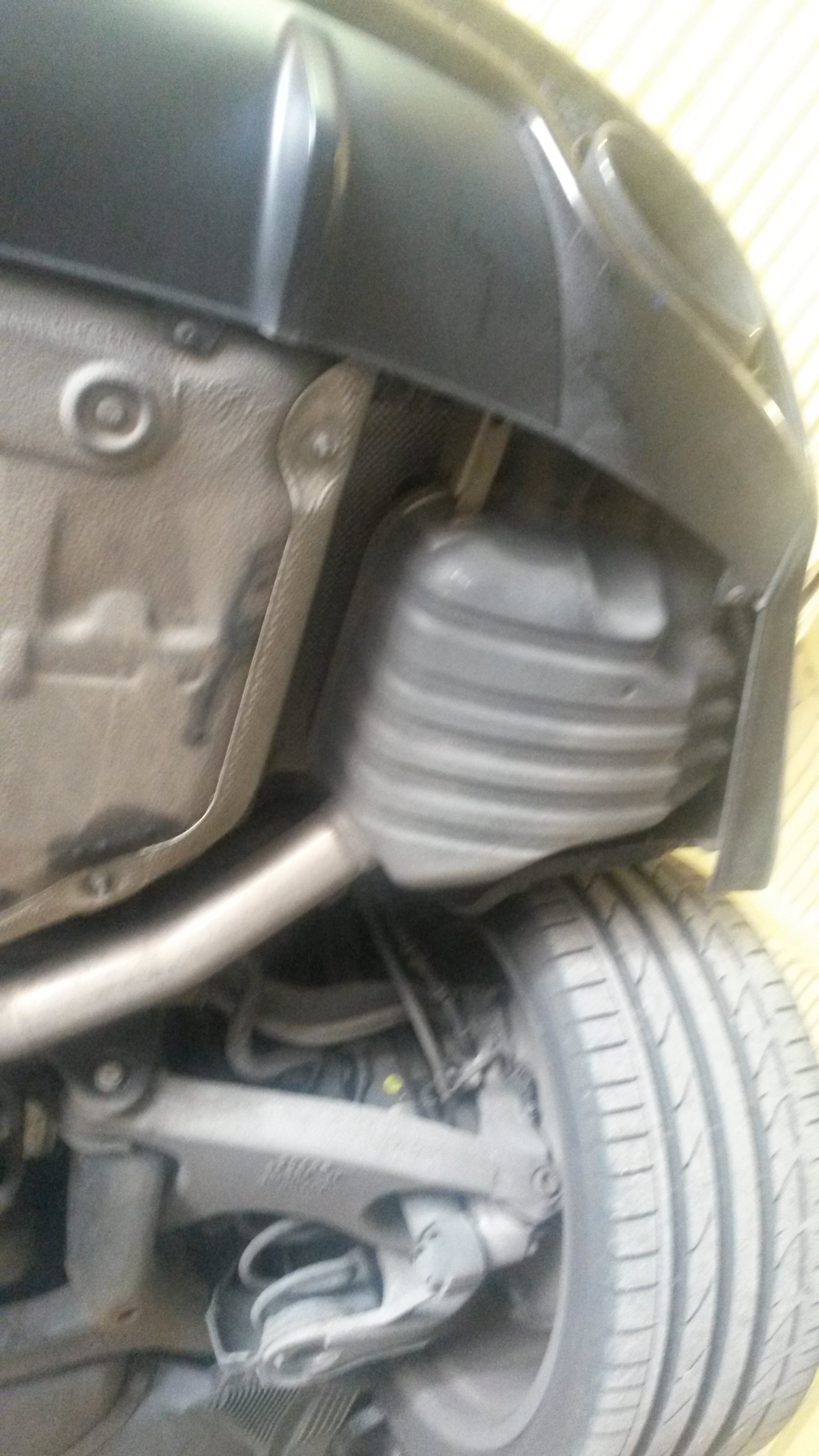

Heres some pics of the build and will post links to vids but as always they don't really do much justice via a phone camera. Its a real base sound and having took Daytonamart out in it for a second opinion we think it is spot on but would be nice for the odd occasion when you just want a quiet run. Now if I could just find a way to valve it and be able to independently select it rather than have it on the dynamic button :D
Four Powerflow parts and the rest is custom tubing.

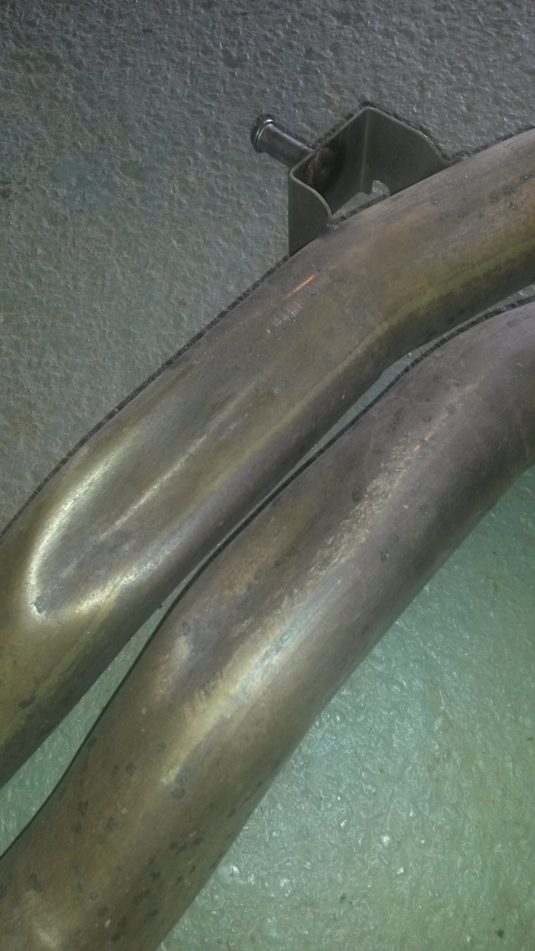

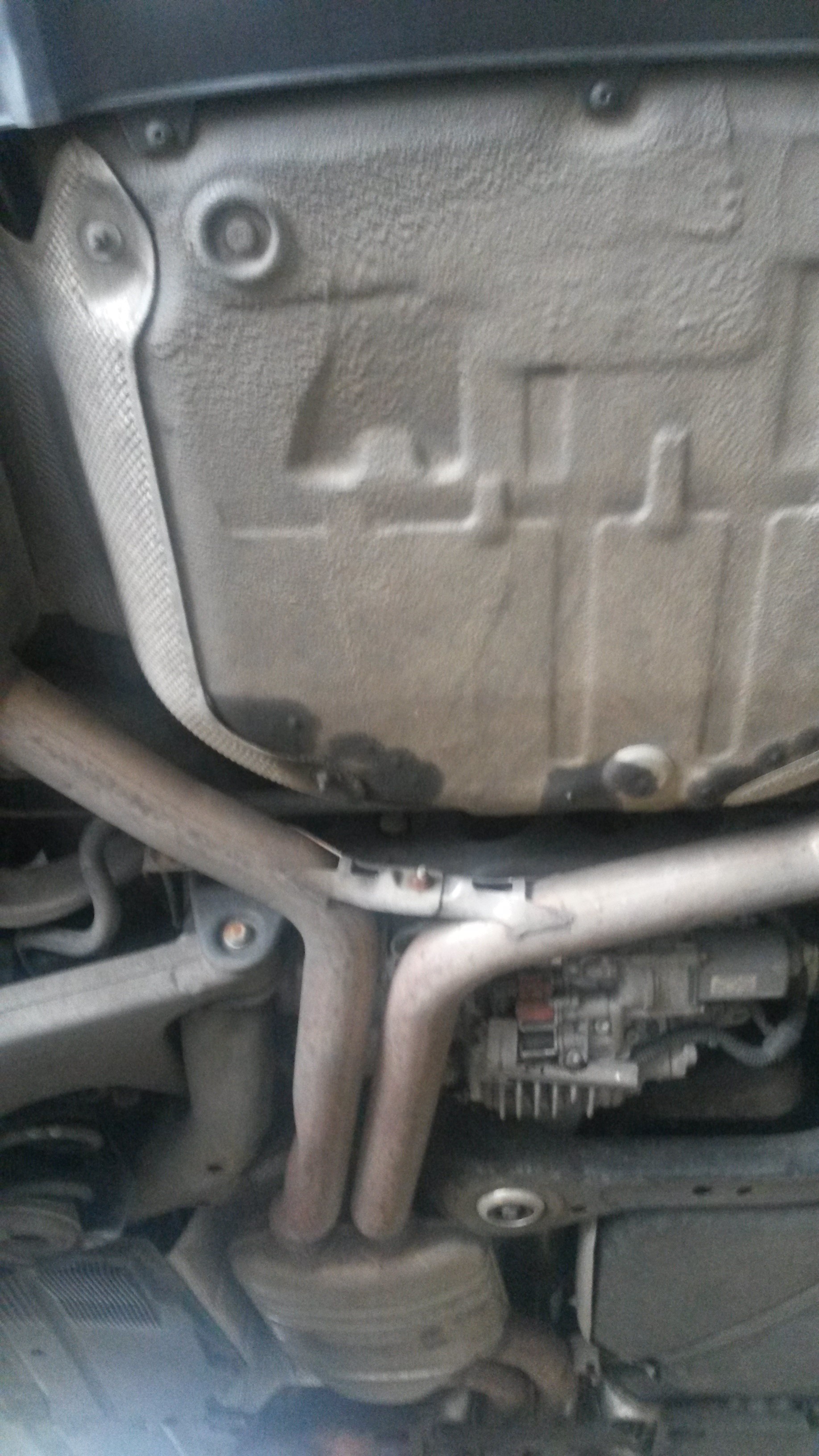

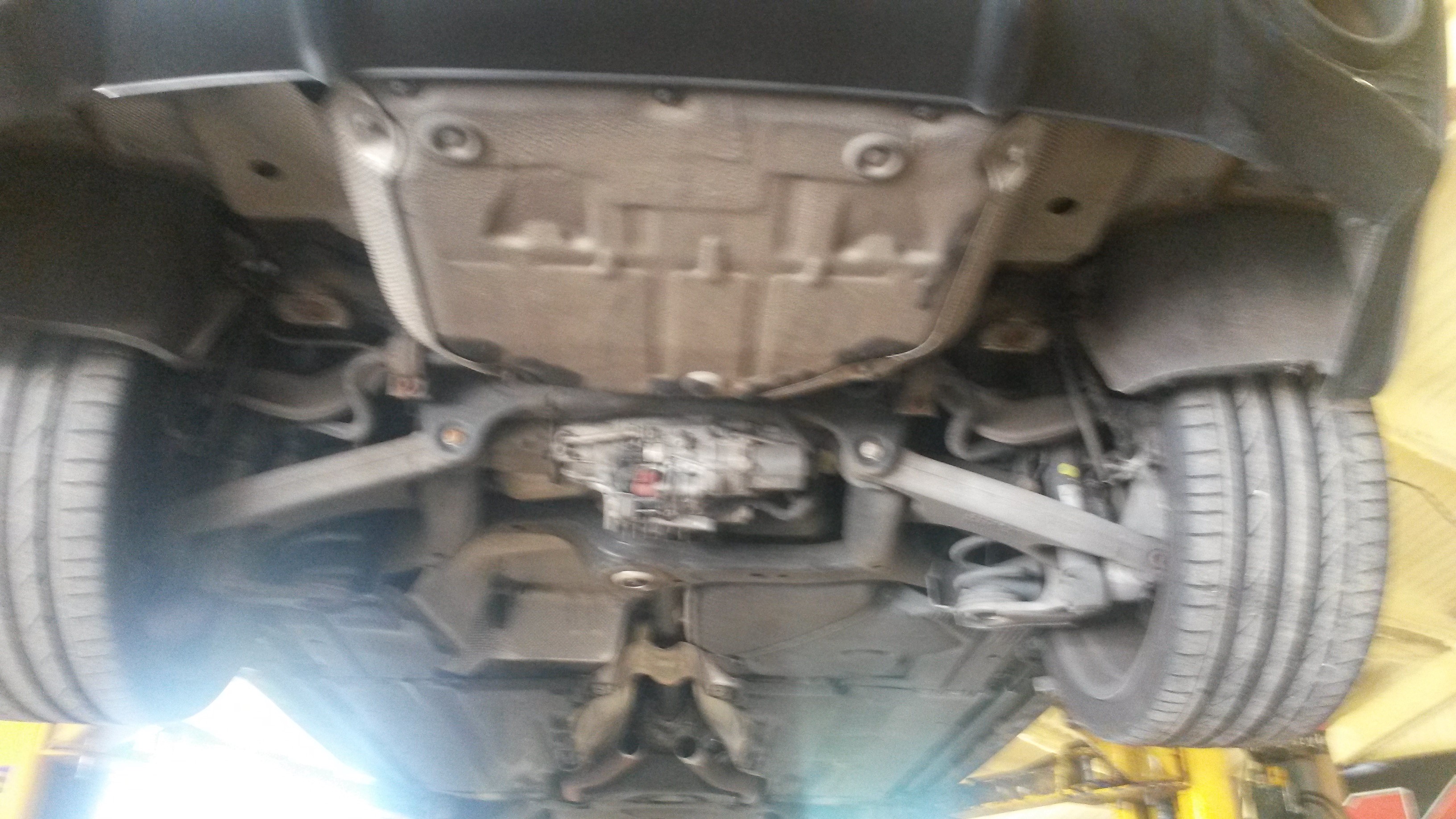

Audi OEM pipes various restrictions for fitment.
Another fitment restriction
