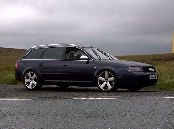

I took it out today
Scanned for faults before taking it out.
3 faults were picked up.
1 Knock sensor signal too low
2 O2 sensors, both banks, both pre cat
Took it out, did about 40 mile across the peaks (not perfect conditions- twisties, wet, altitude, average speed cameras and slower traffic). Anyhow it's where I live so no option really.
Fuel trim started adjusting and has settled at -0.9%idle and 0.8%malt.
I did a WOT pull in 2nd to around 6900rpm. Hit 262 g/s of MAF airflow. That equates to 327.5 Bhp at 1800ft asl running on 95RON. Not too bad!
Both pre cat lambdas then!?! huhmmm
