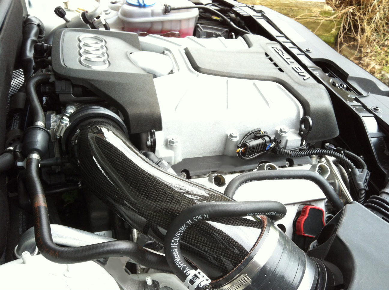

Fitted my APR Carbon Intake pipe. Easy to do, just needed a bit of 6mm ID vacuum hose and an 8mm-6mm reducing connector. Also relieved the mouth of the airbox a little to let it breath a bit easier. Sure hasn't made it any slower and it has just enough whine to make it interesting. Not put many miles on it yet, but will report further in due course.
