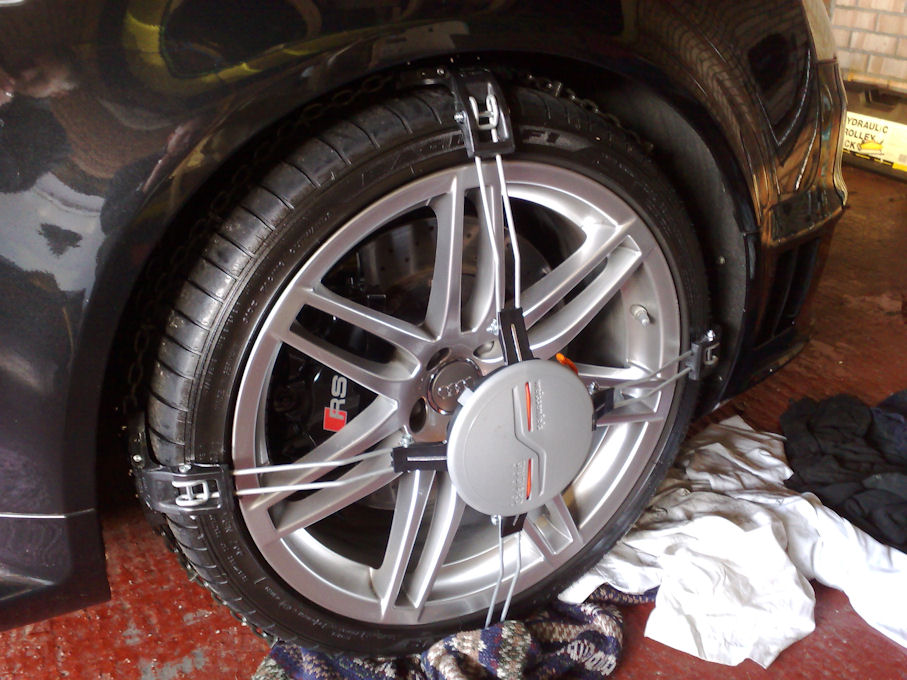

Chains
Post by SR71 » Wed Dec 15, 2010 1:43 am
No problems fitting chains to my 19" wheels on the RS4.
Just got to buy the right size.

Post by kart_man » Fri Dec 17, 2010 11:05 am
Just ordered some Thule K-Summit chains - I'll let you know how they go. Seemed like a better option than winter tyres, as the snow fall here is so sporadic. Will only be used in extreme conditions as so far the car has performed well in the snow we've had.
