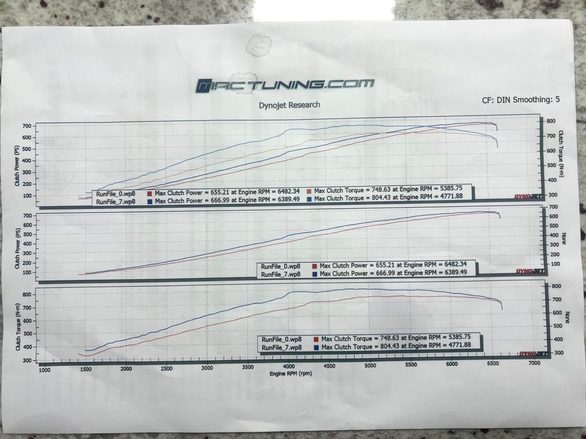

Current spec:
Secondary cats removed
BMC filters
Wagner intercooler
Dodgy stage 1 map (non-MRC)
Recent dyno at MRC (click to expand):
Dyno run where it made 666 PS and 805 NM: https://www.instagram.com/p/DJ7xlH7I3GF/
(First run it made 20 PS and 50 NM less, then Doug fixed some vac leaks; it pulls stronger at the top end now but won't be driving it much until it's seen to, I'm worried about turbos going and taking the new Wagners with them.)
Should be hitting peak torque at 2k not 4k, turbos maxxed out at stage 1 so guessing a boost leak or something else. Because they're maxxed out we didn't try a stage 2 map.
Anyone seen this amount of lag before?
Gutted as I've already put a lot of money into this project and seller lied about servicing, it's needed loads of bits rectifying and despite saying it had spark plugs done a year ago, on inspection they're stamped 08!
Also oil on the spark plugs so some leaking in the cam cover.
Stage 2 will have to wait.
