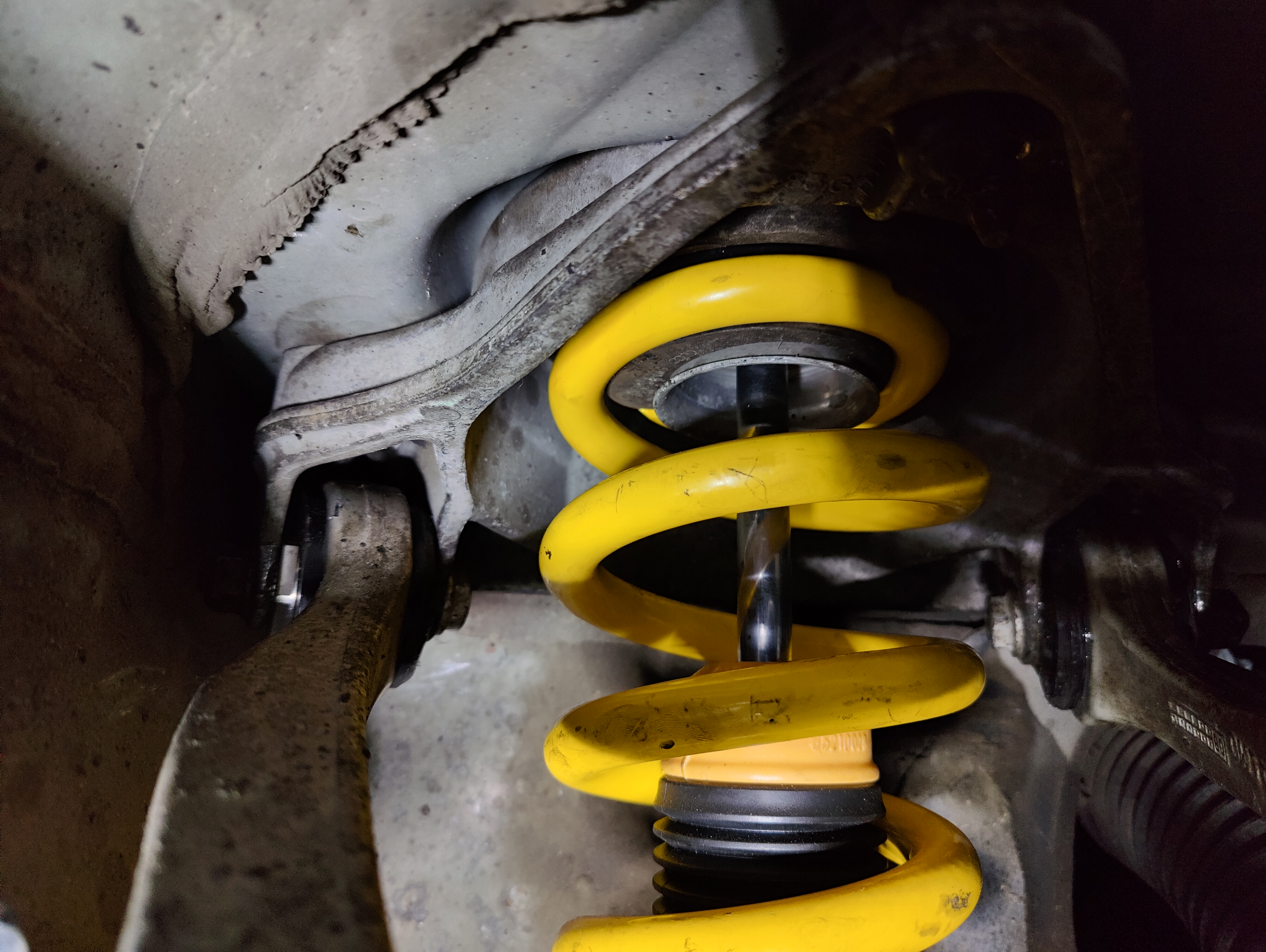

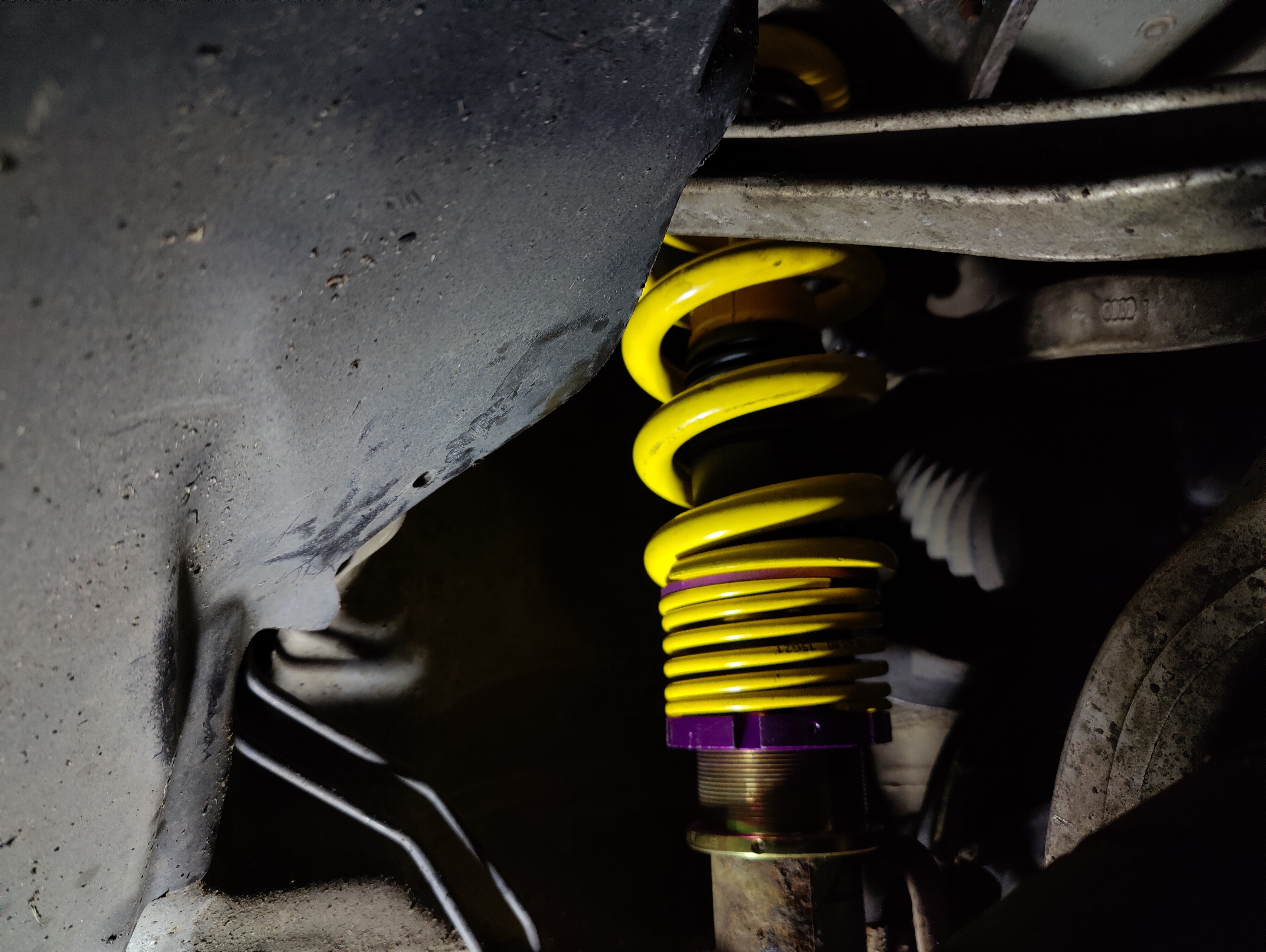

Can anyone confirm whether it's possible to change the springs without needing to recharge the DRC?
Re: Lowering springs/spacers
Apparently it can be done but I har a look and to be honest without removing the front wings I couldn't see how.
It's 100% possible, no need to remove wings. The hardest part is getting the rears out without special Audi spring compressors (at about £800). All I'll say there is that it's easy with the spring in two pieces. I went with the KW adjustable springs, so I was able to set them at their lowest to get them back in without compressors.
I ended up just getting them fitted by someone who could recharge the DRC. I couldn't get the strut low enough to clear the wing with the DRC connected. Your other fight with be the top arm pinch bolt. You may end up having to snap/cut the head off and use two nuts o. The threaded end to pull it out. I then replaced them with stainless bolts.
Indeed, I destroyed the tip of a finger trying to get that out. I ended up undoing them from the top mount. I was fitting camber bushes so needed that undoing anyway. I ended up just fitting them using a portable bushing press rather than the big press in the garage. Unfortunately I don't think I have pics during the process. I did contact a couple of places about having them fitted but none responded to me.
