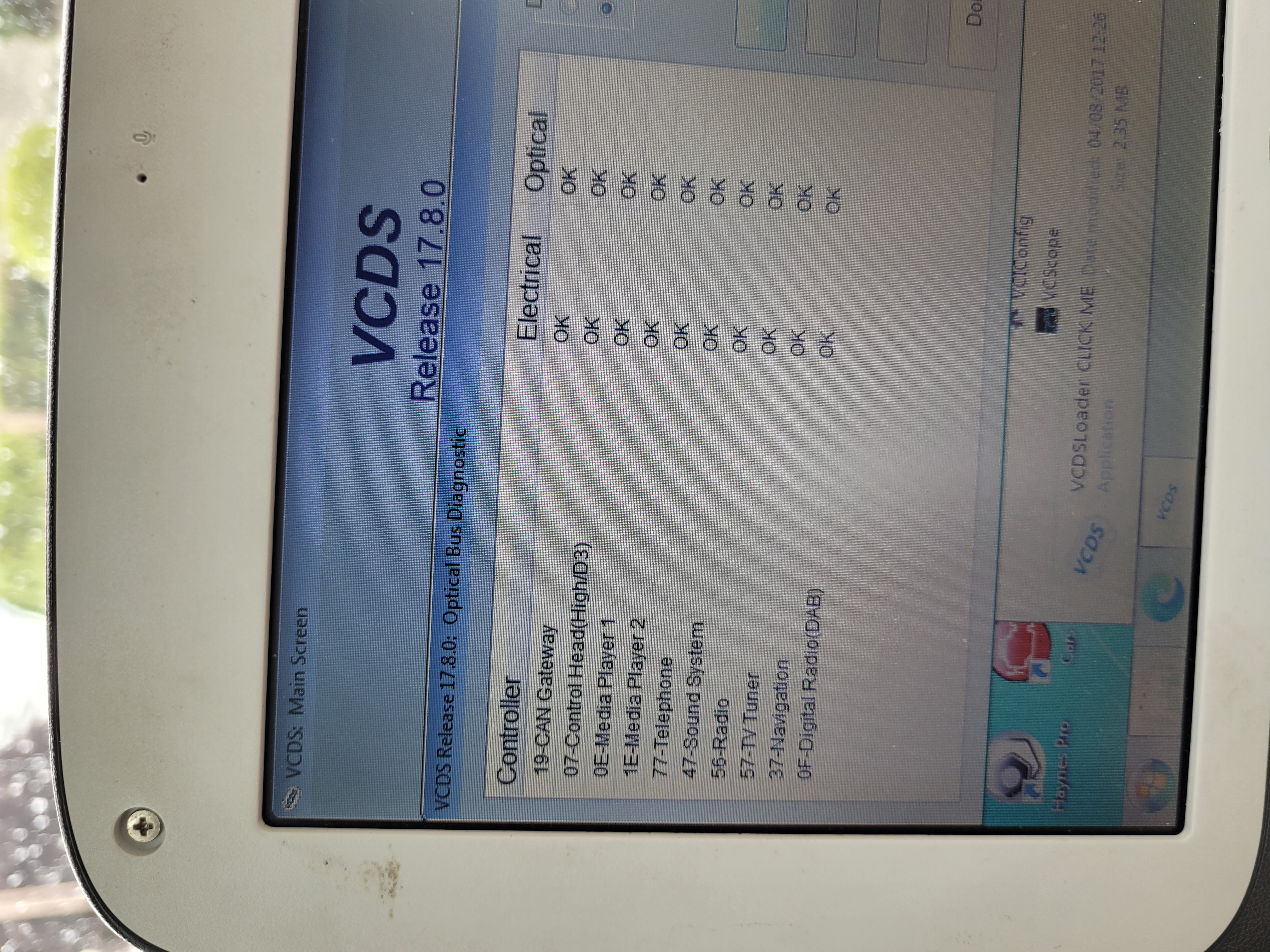

HI all.
I'm looking for some help.
My C6 RS6 has no sound coming from the speakers. I thought it was water damage on the Bose amp so had that sent away and refurbed. After refitting still no joy. I have had the passenger seat out and checked the Bluetooth module and everything is dry as a bone. When I run VCDS I'm getting "address 47 sound system cannot be reached" I bought a fibre optical loop from amazon and tried on both the amp and Bluetooth modules but still nothing. Anything else I can do before sending it off to a grown up to take a look? Cheers.
MMI SEND HELP!

VCDS -- Windows Based VAG/VAS Emulator Running on Windows 7 x86
VCDS Version: https://protect-eu.mimecast.com/s/m6a1C ... n=17.8.0.1
Data version: 20170721 DS276.2
https://protect-eu.mimecast.com/s/TITcC ... s-tech.com
VIN: WUAZZZ4F28N902330 License Plate: CS54LSS
Mileage: 223260km-138727mi Repair Order:
Chassis Type: 4F (4L0)
Scan: 01 02 03 05 06 07 08 09 0E 0F 11 31 14 15 16 17 19 1E 36 37
42 46 47 4F 52 53 55 56 57 61 62 65 6C 6D 72 76 77
VIN: WUAZZZ4F28N902330 Mileage: 223260km-138727miles

Address 47: Sound System
Cannot be reached

47-Sound System -- Status: Malfunction 0010
Cannot be reached
