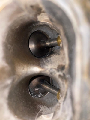

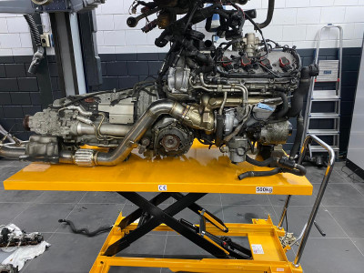

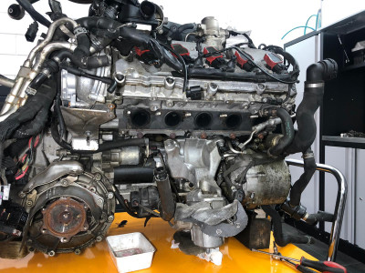

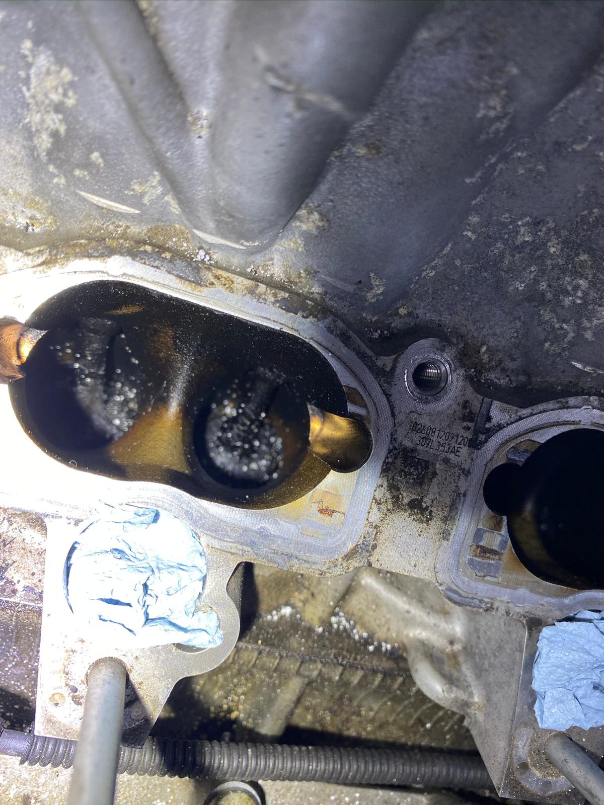

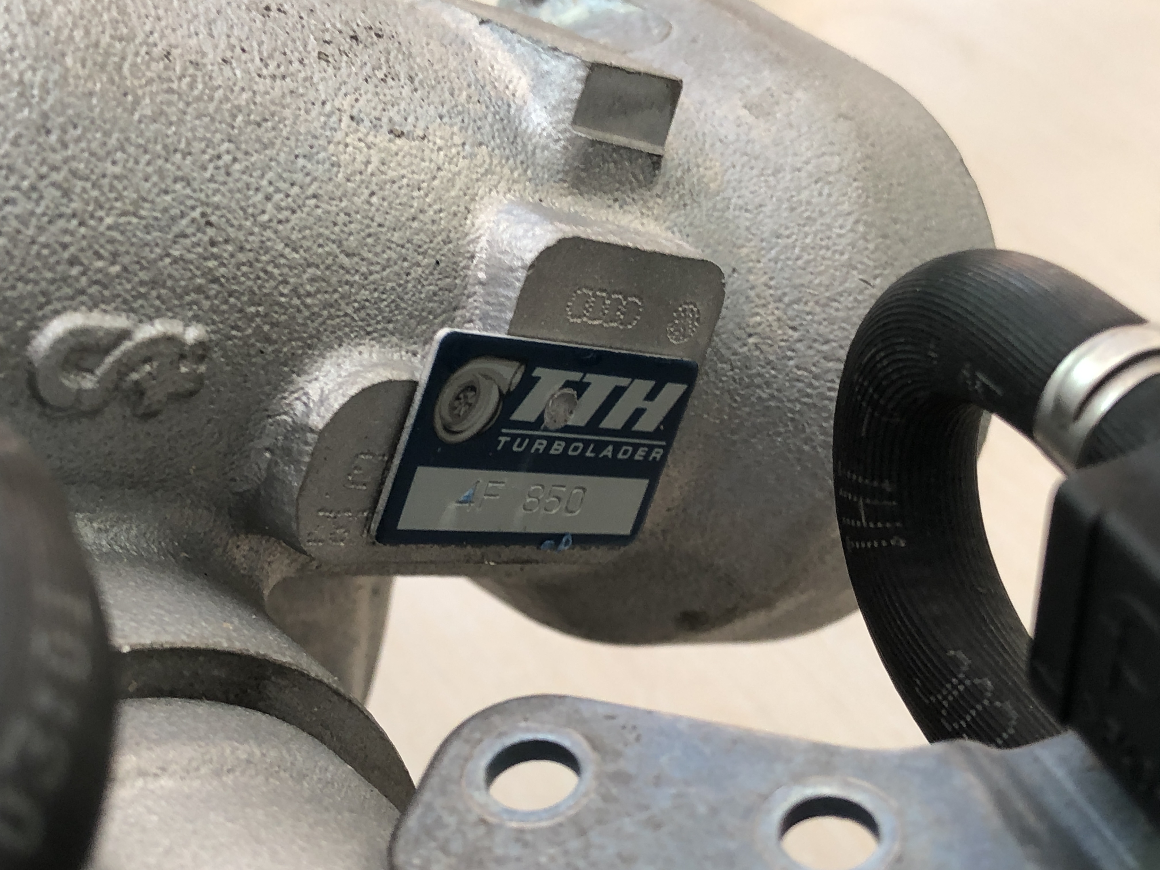

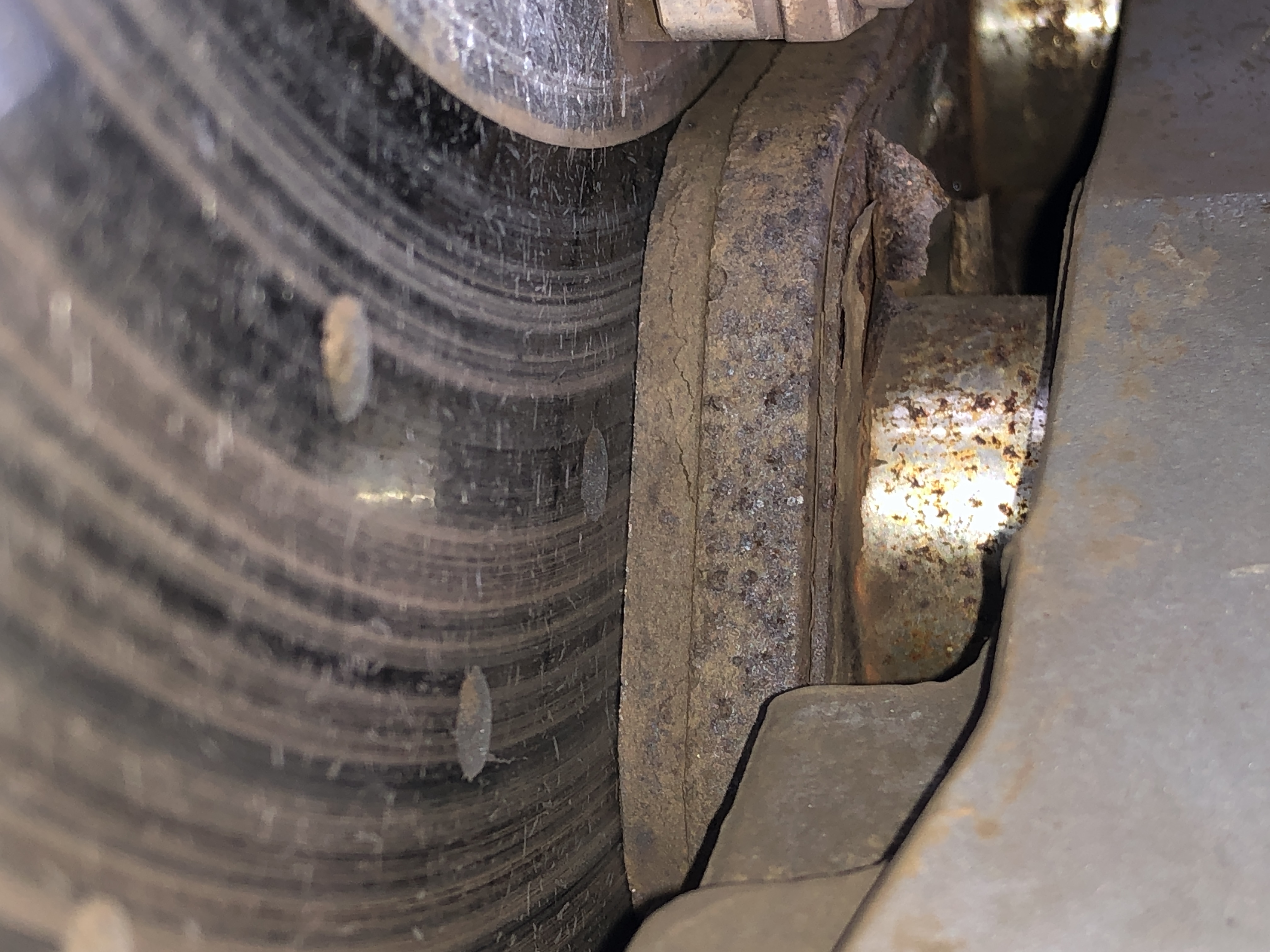

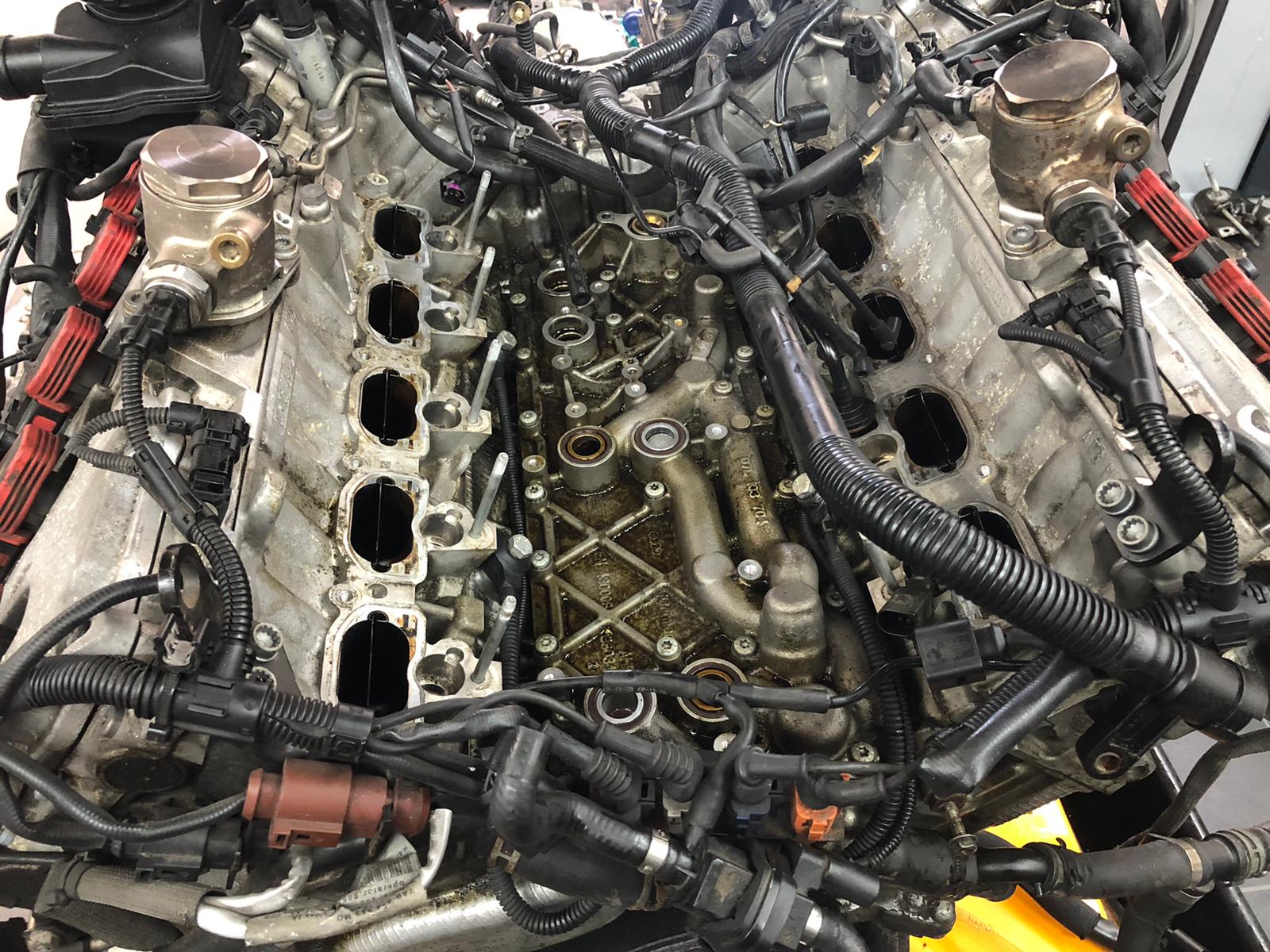

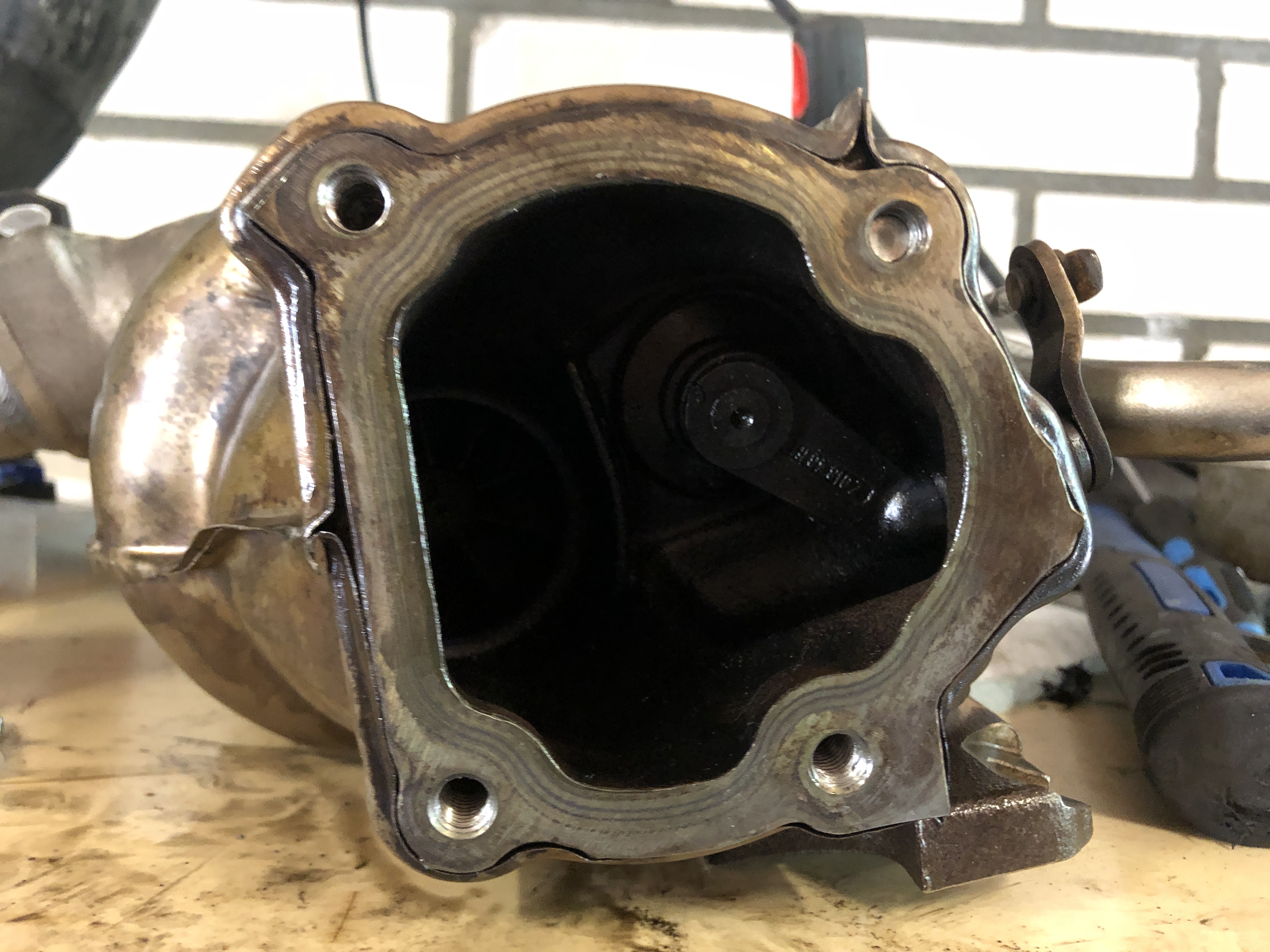

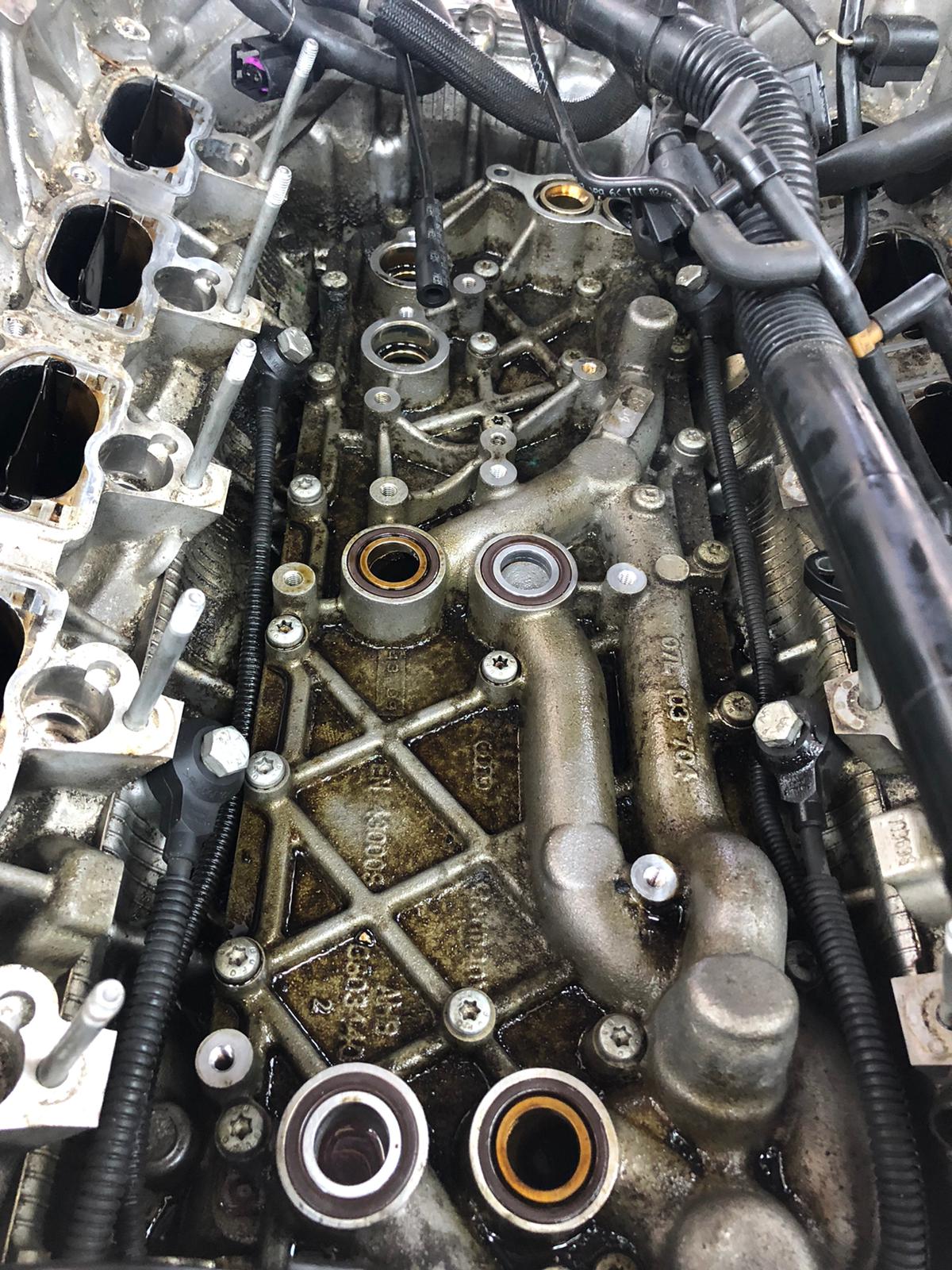

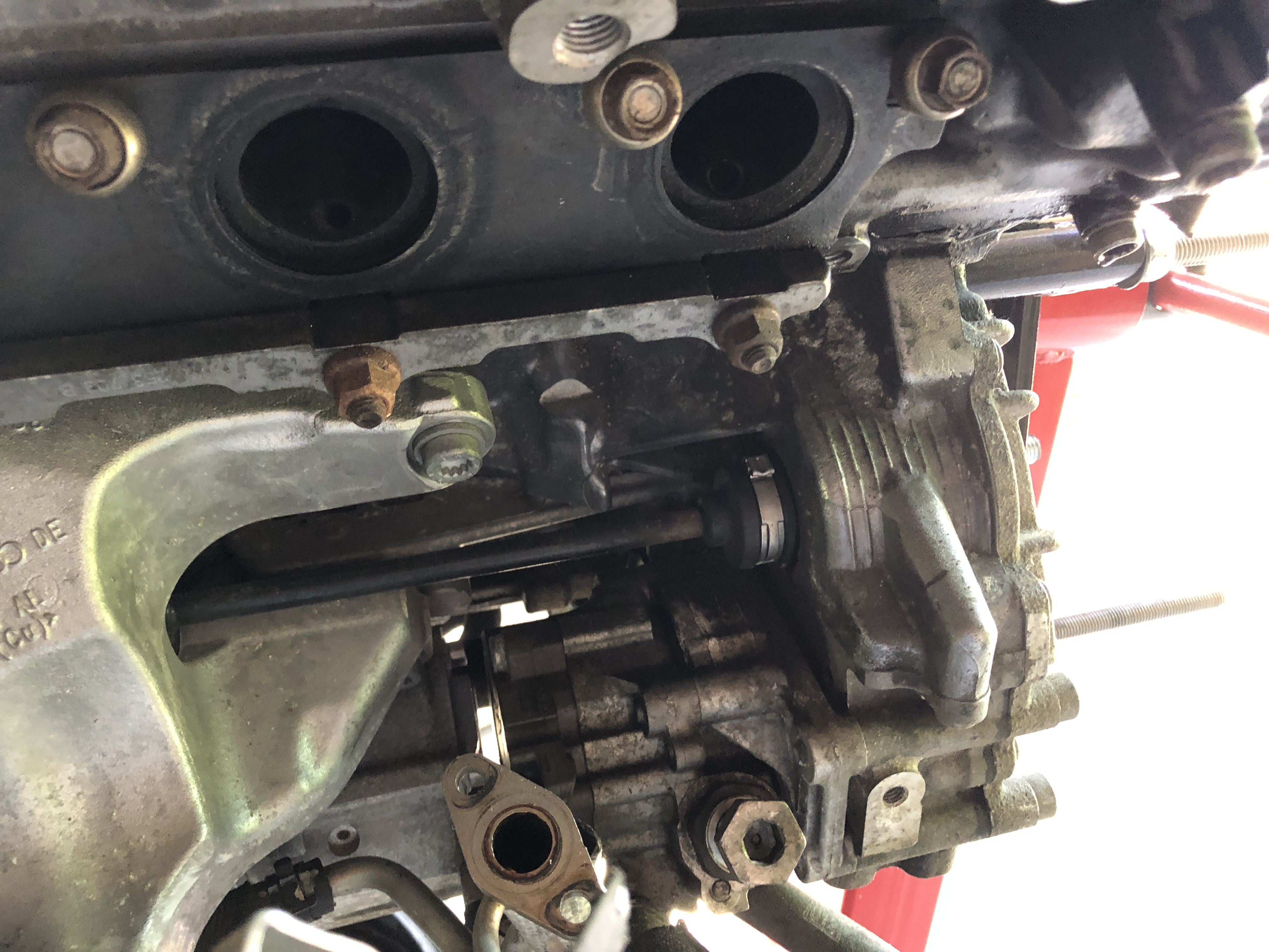

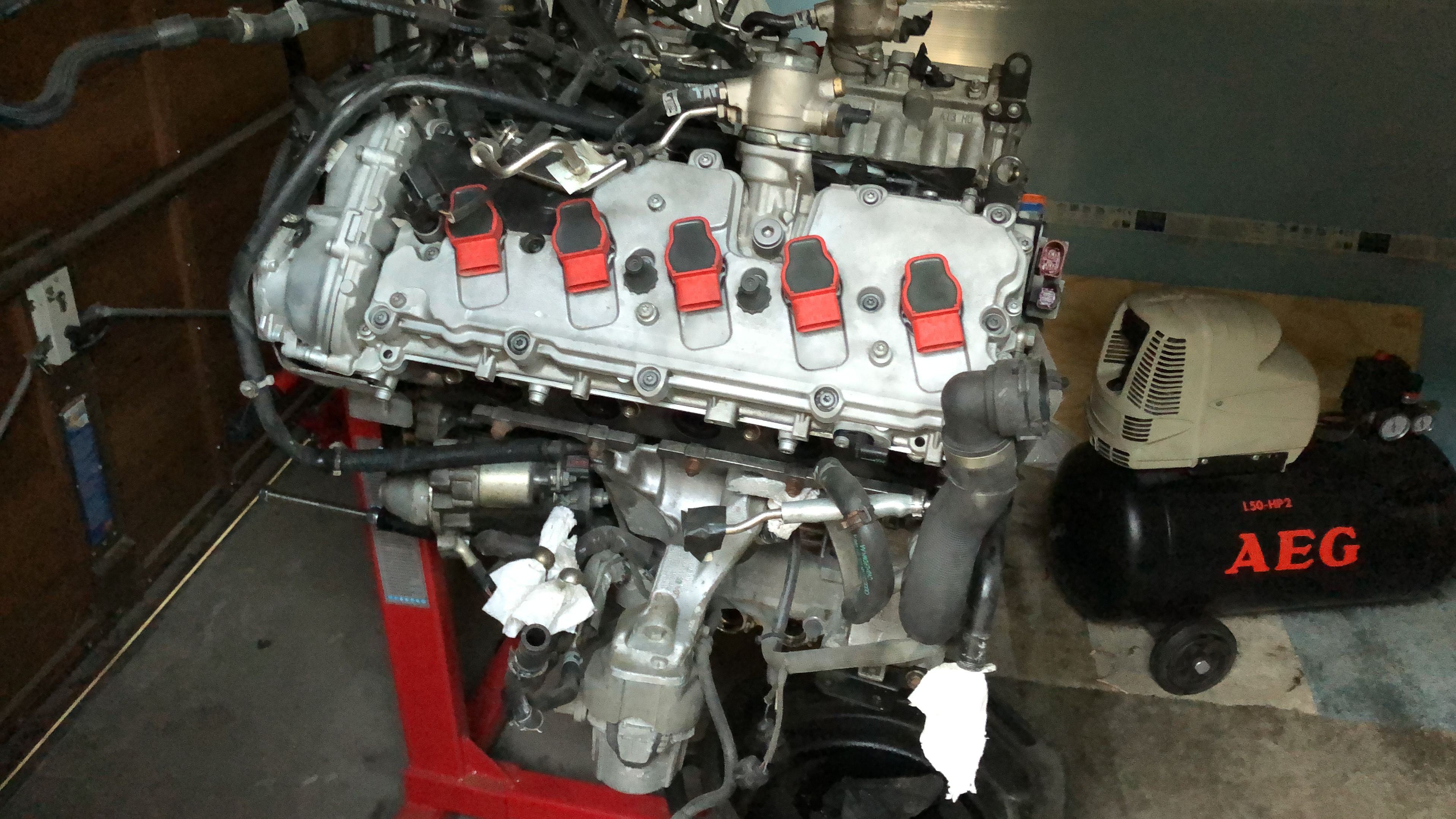

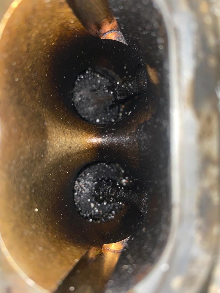

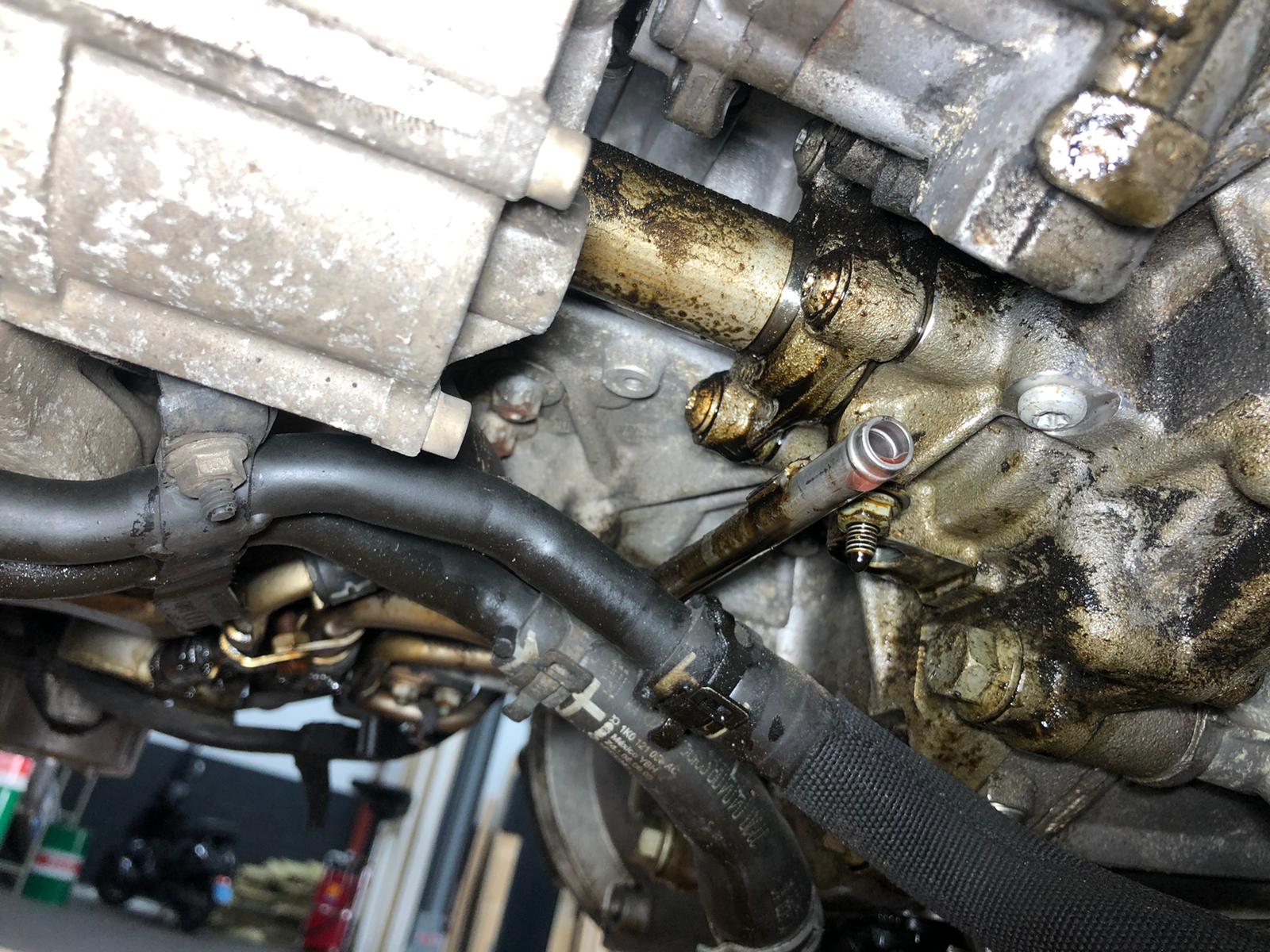

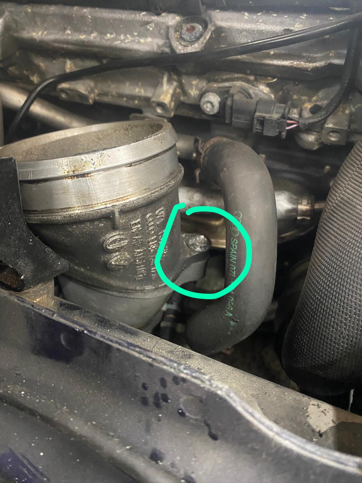

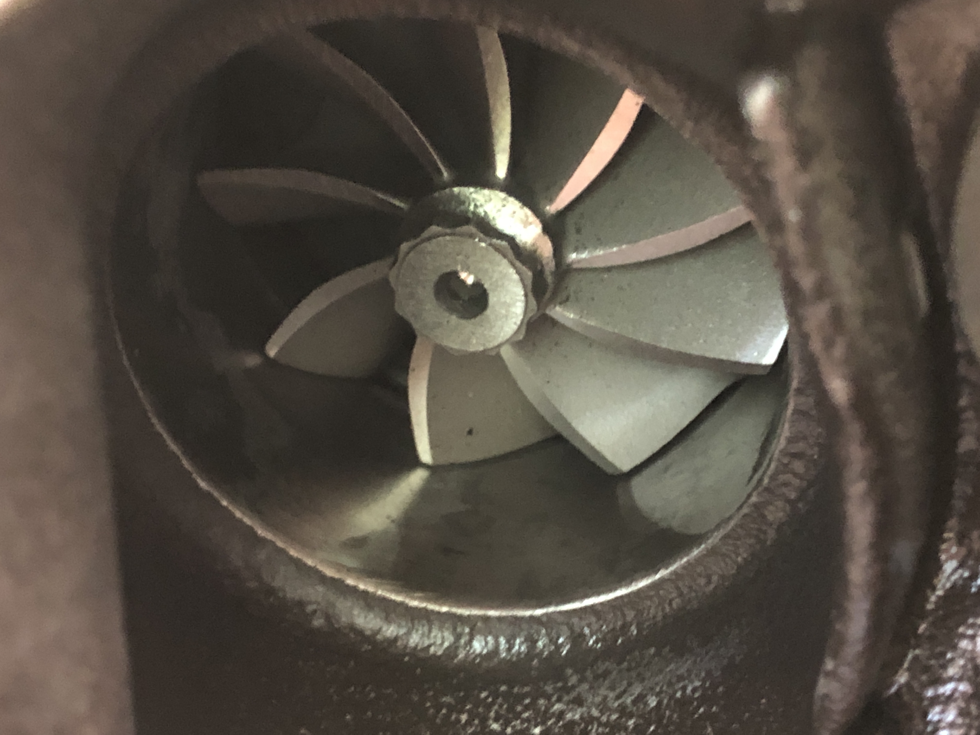

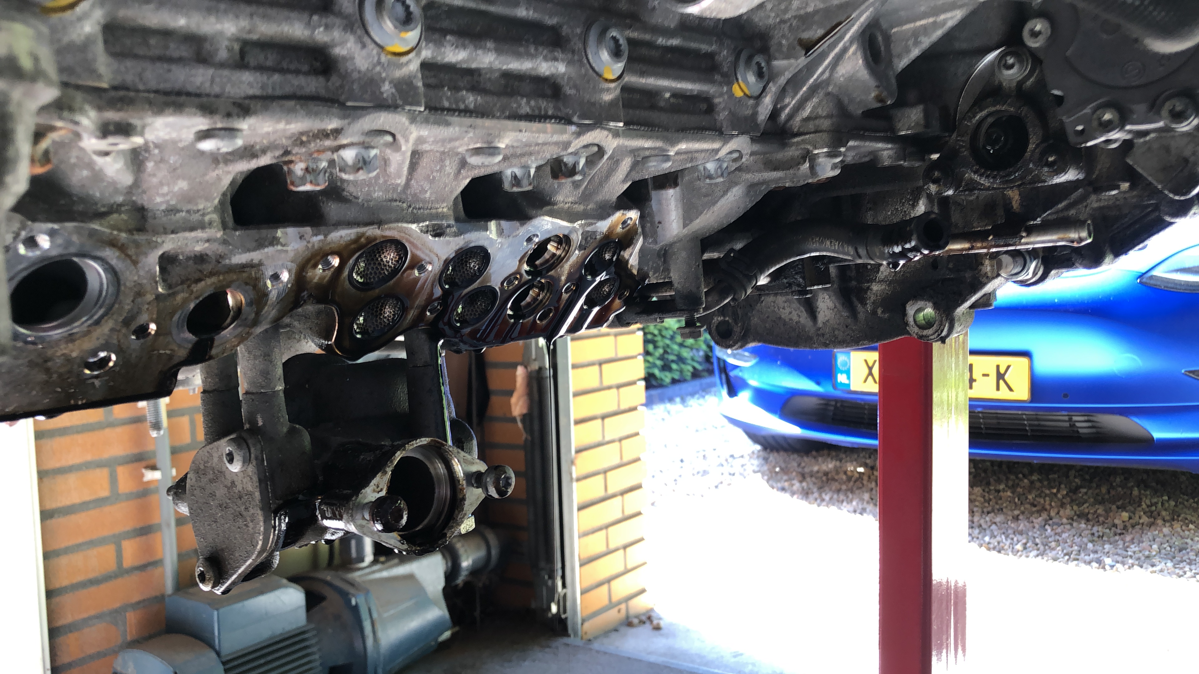

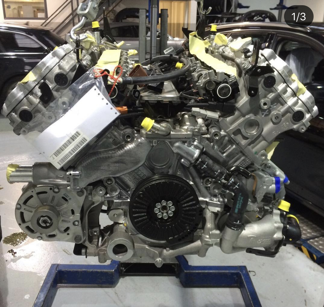

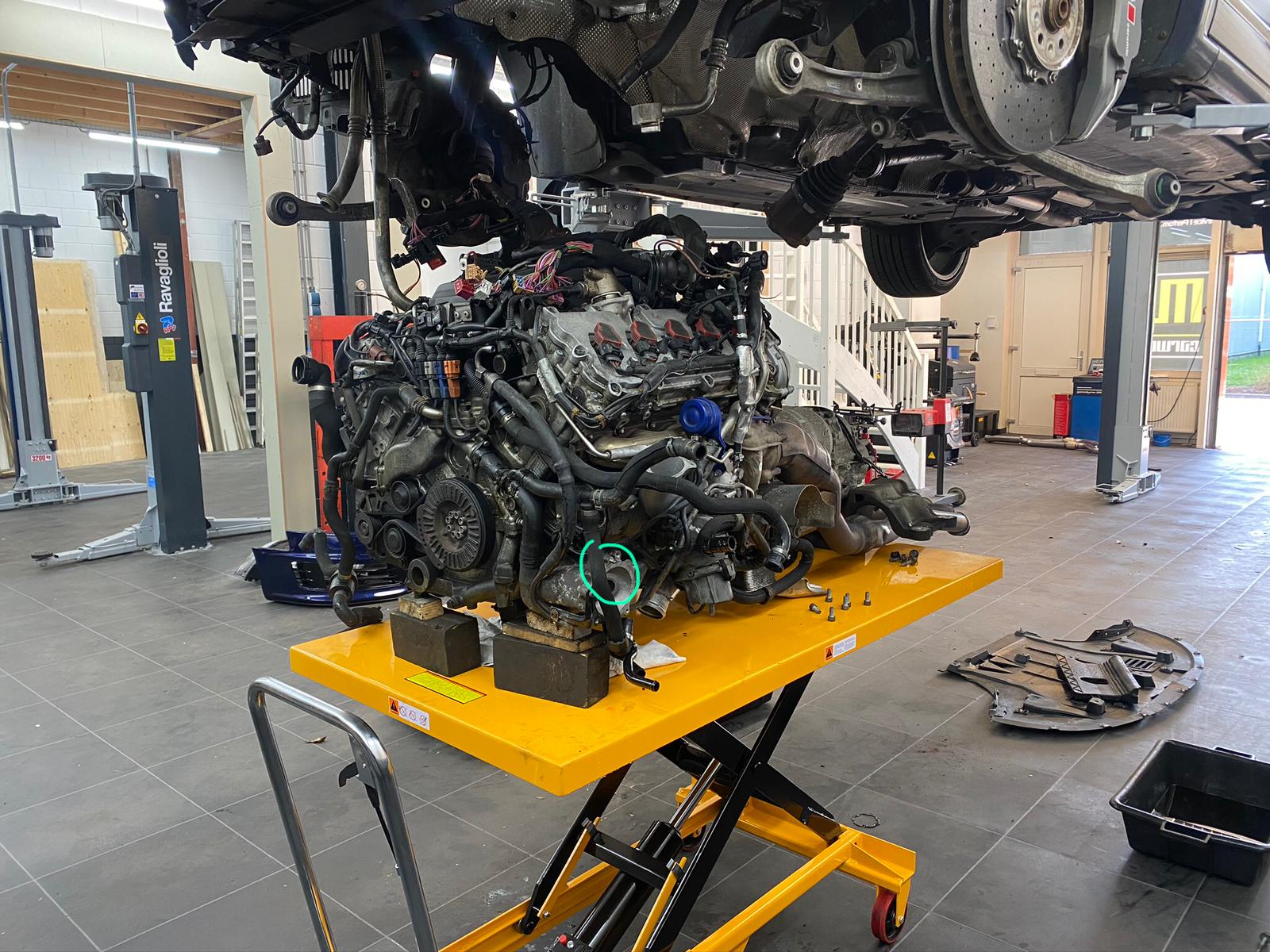

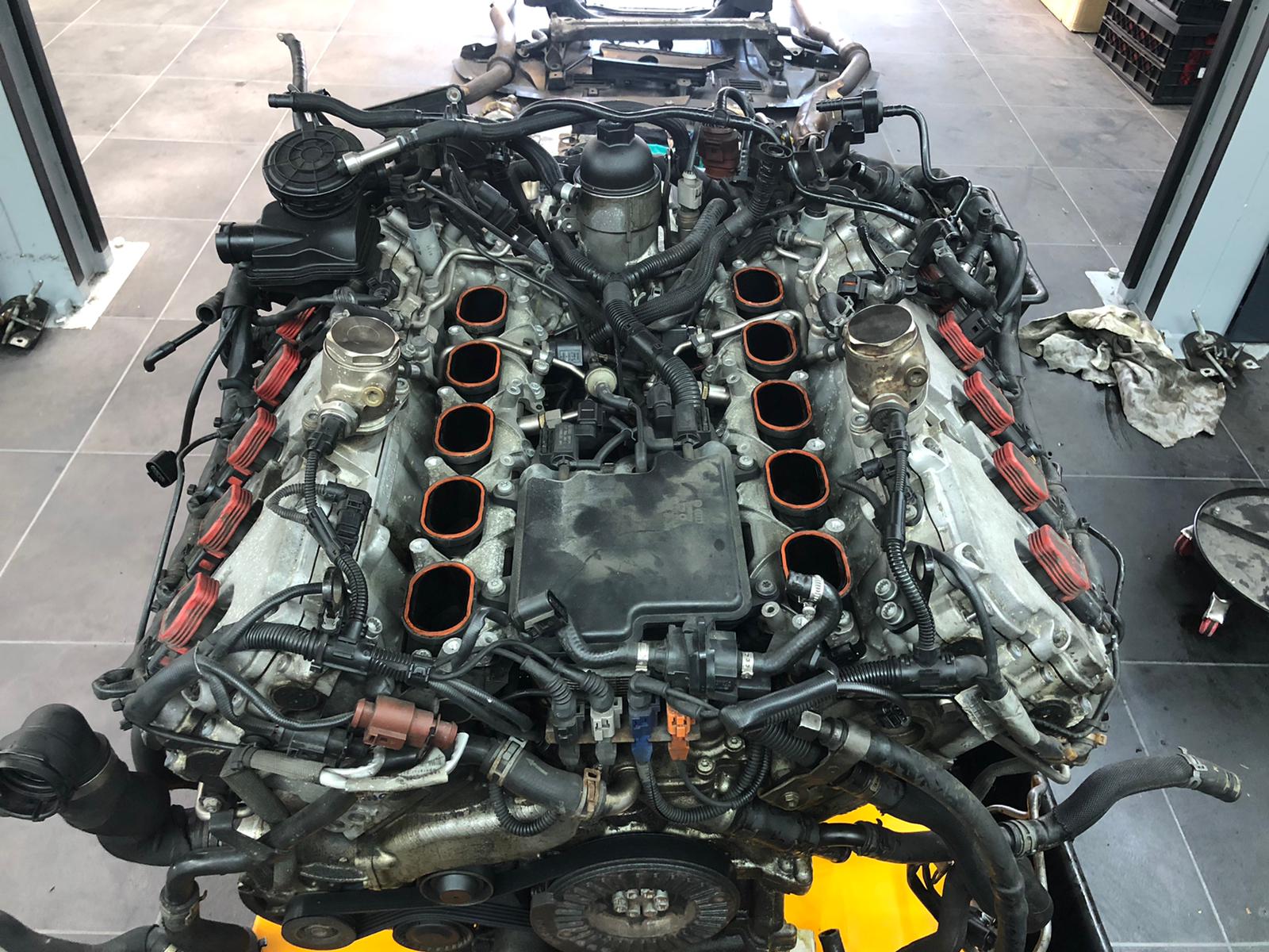

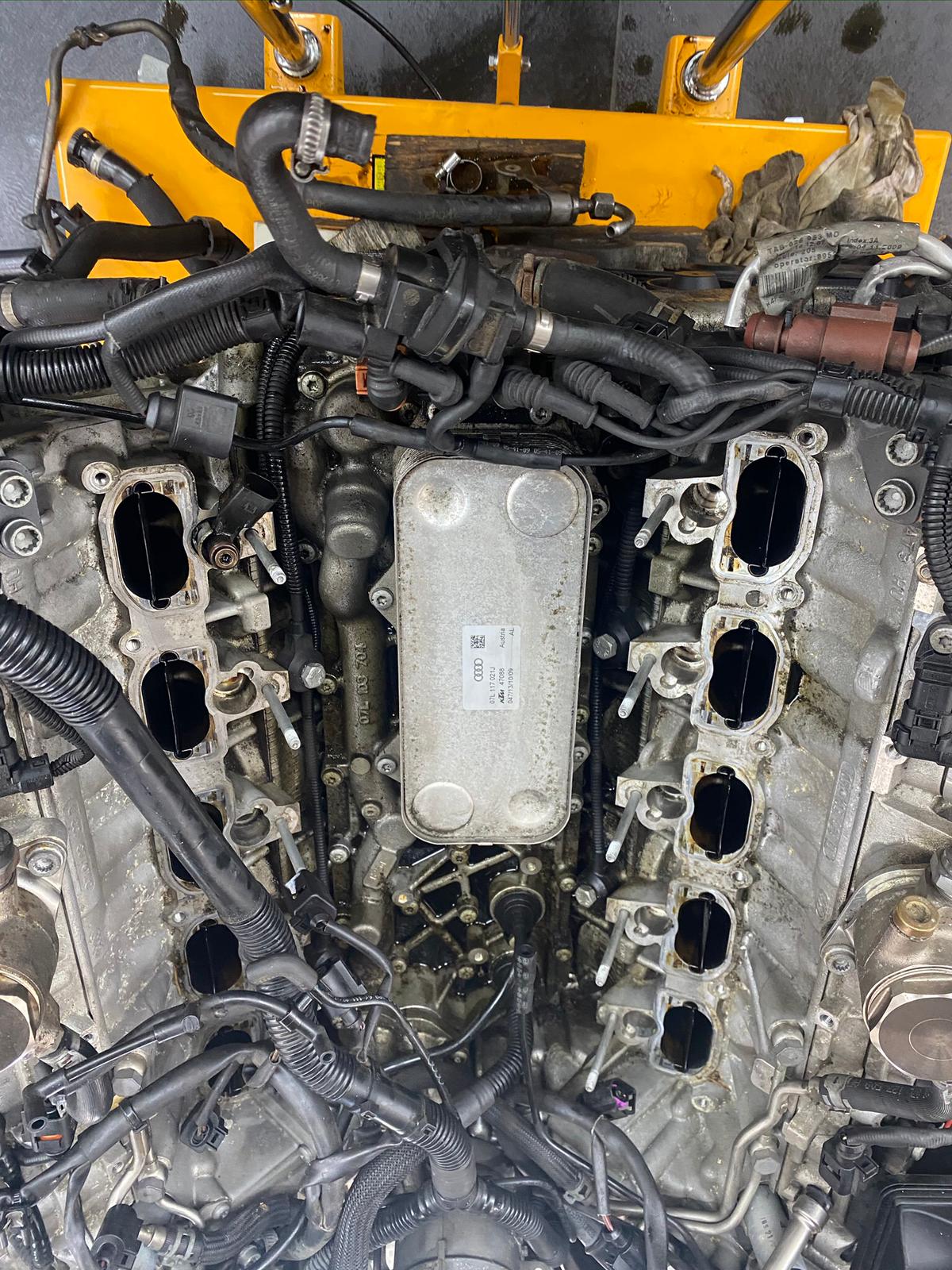

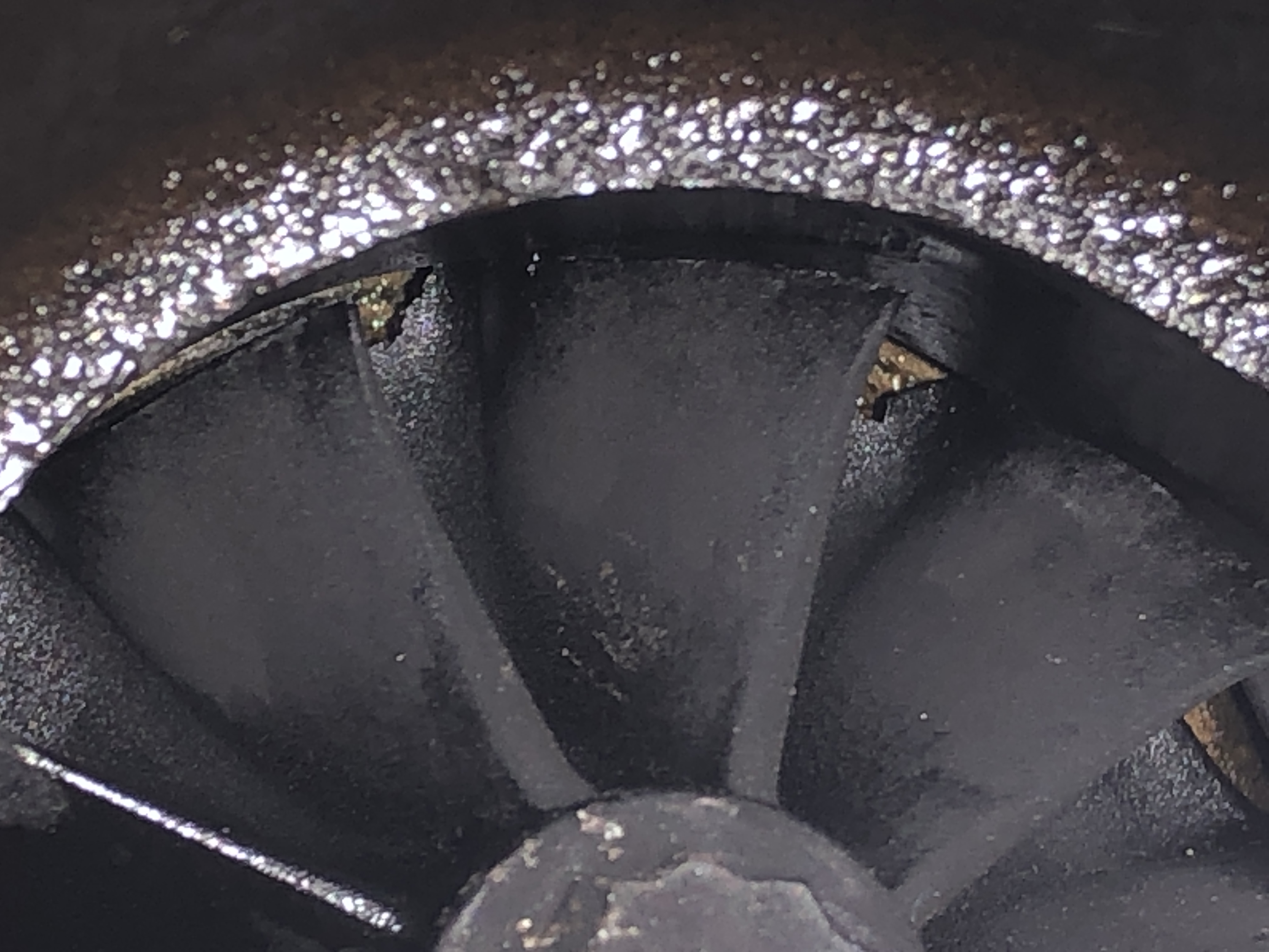

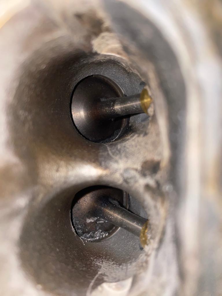

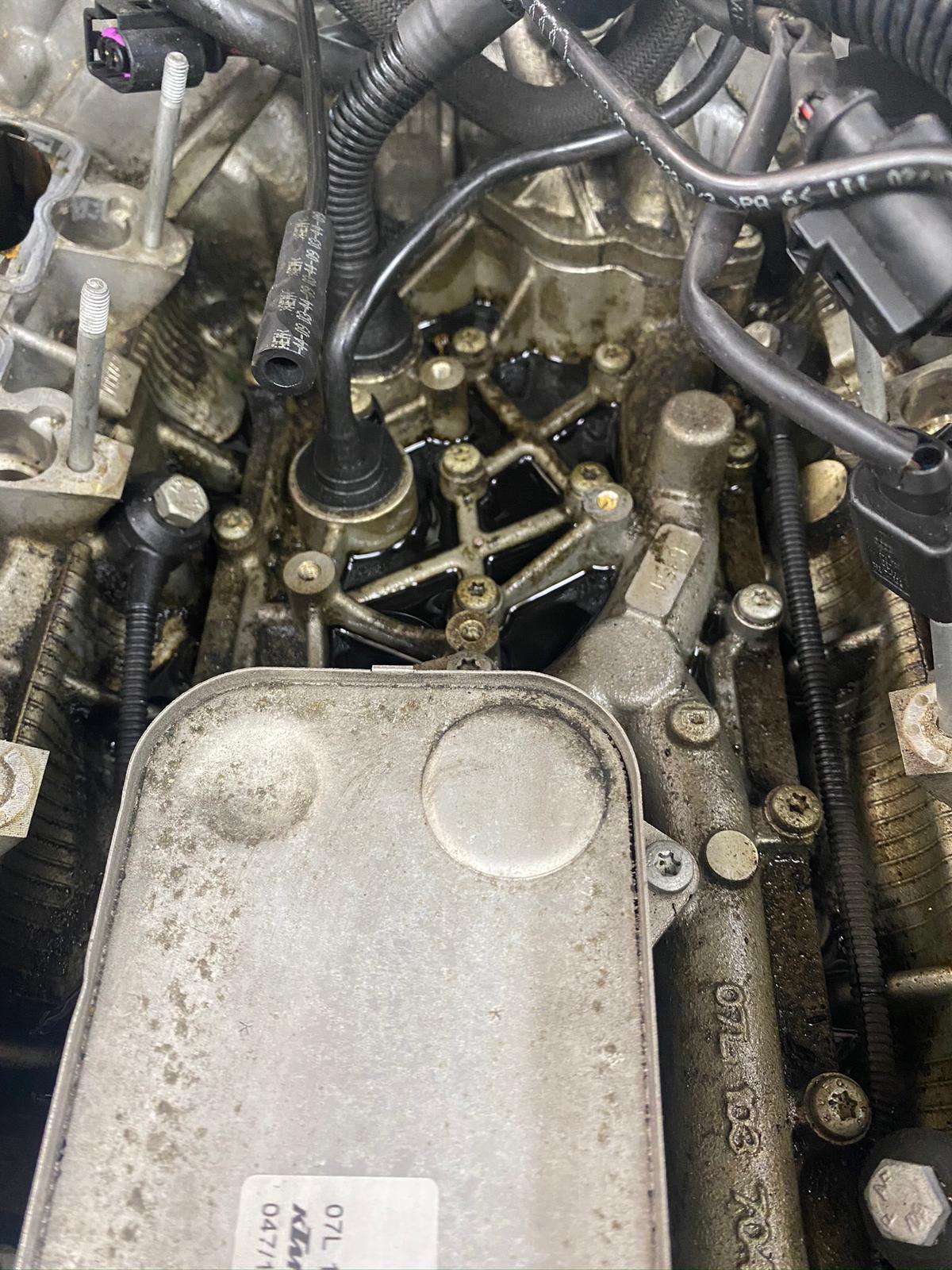

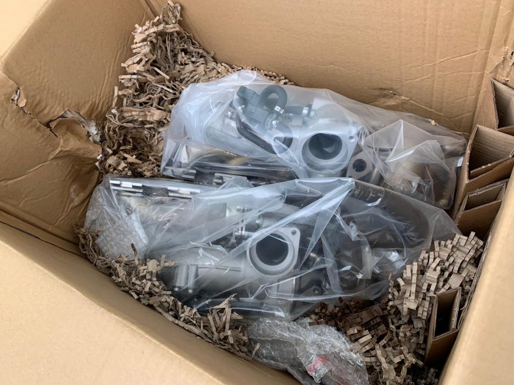

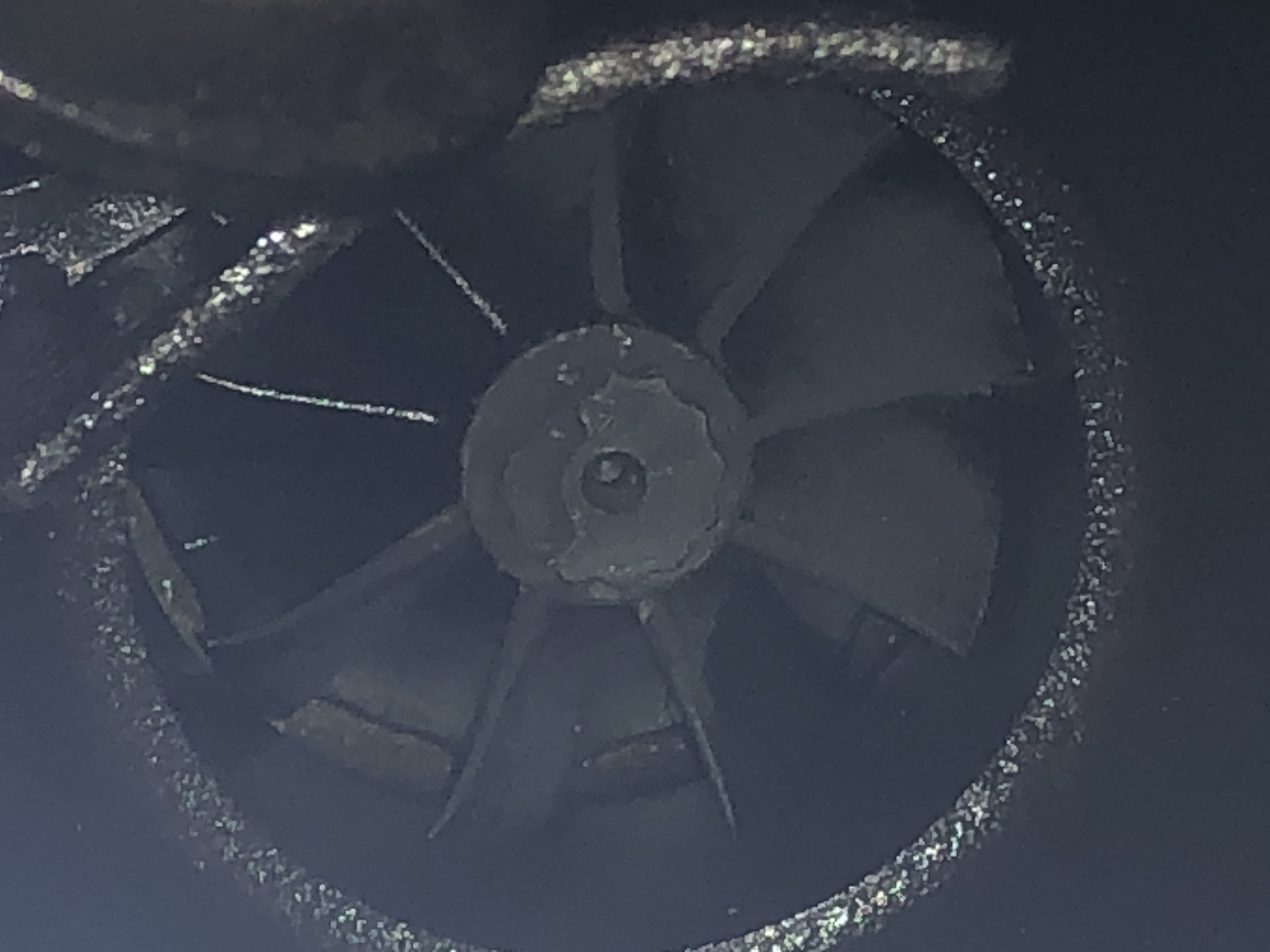

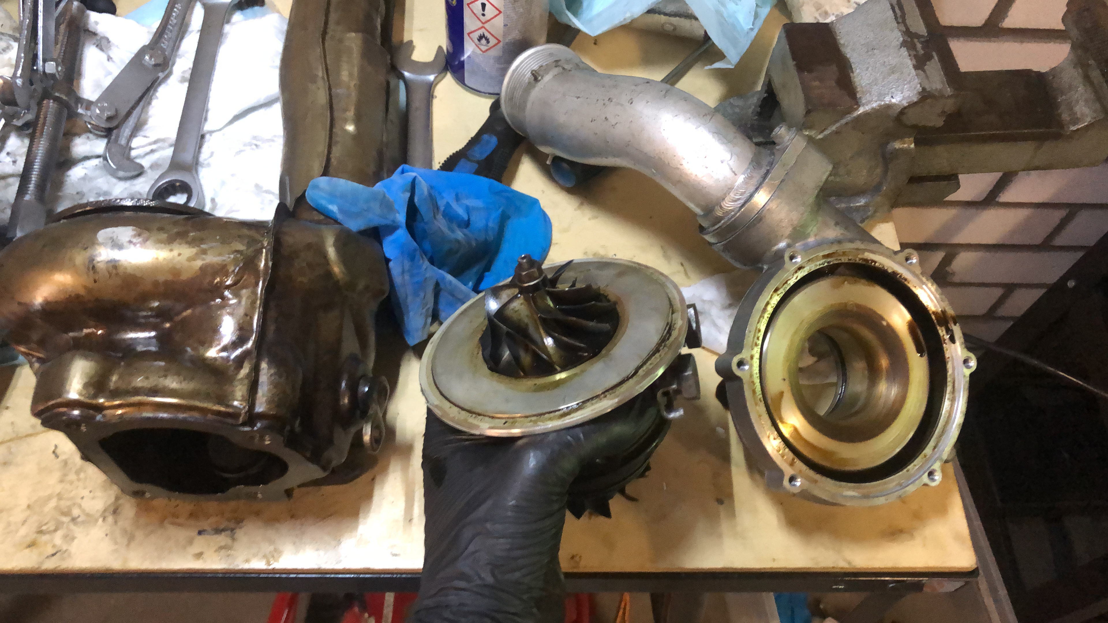

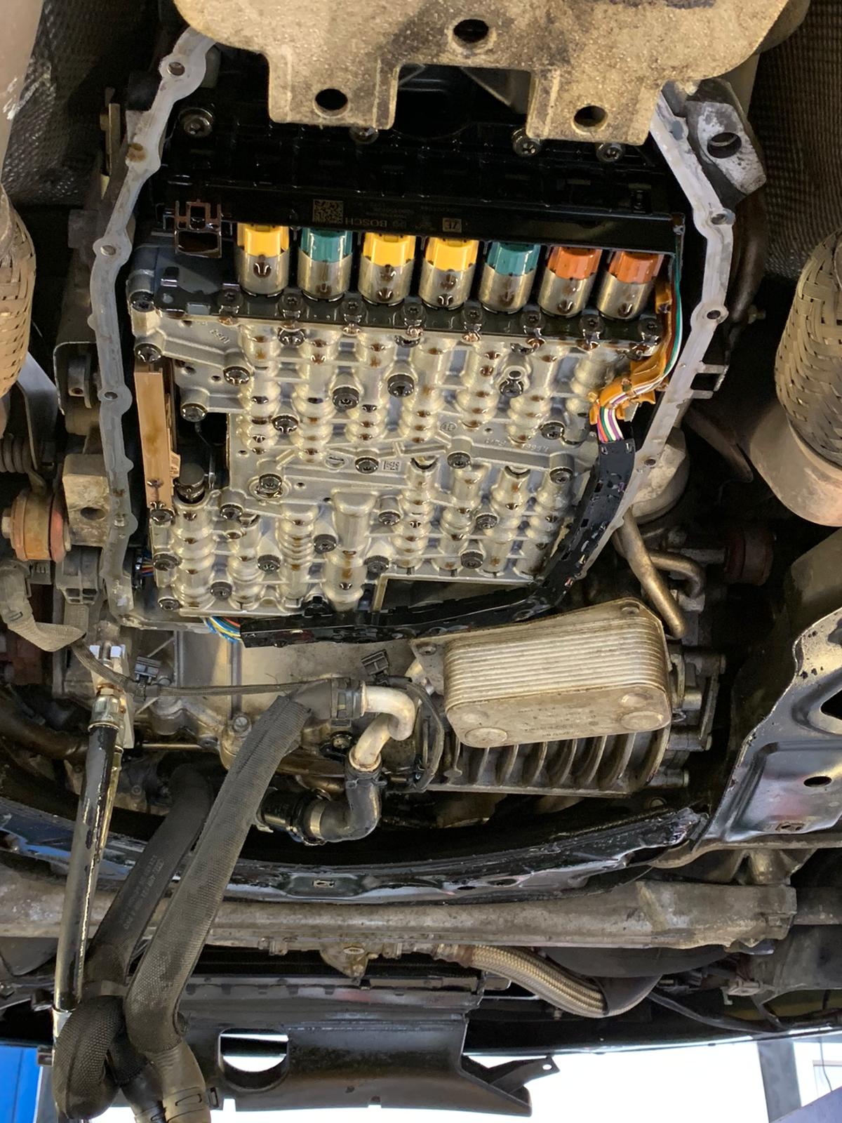

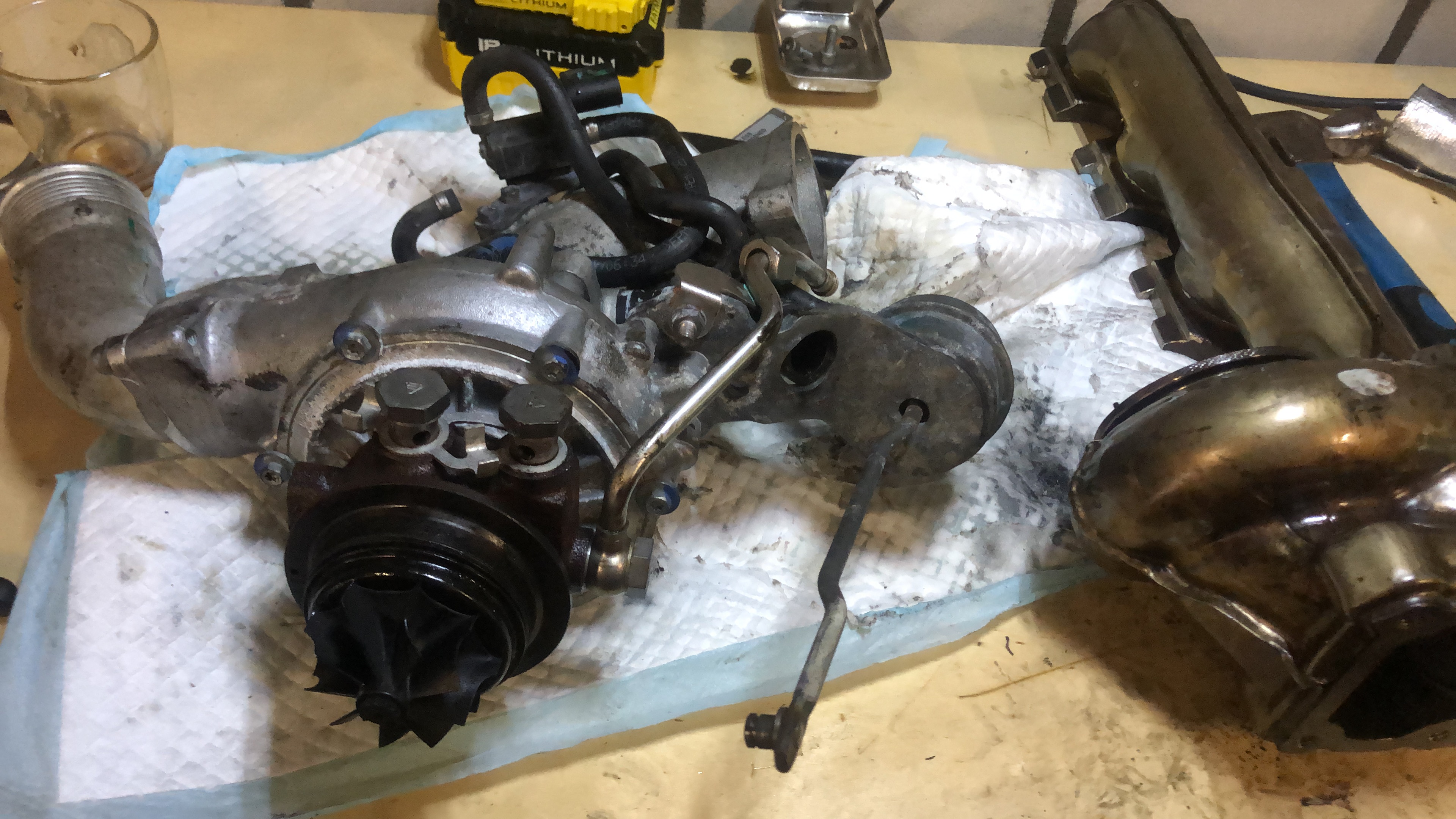

Hi and welcome to the C6 family! Compression test is a serious good idea, outer cilinders are fragile to overheating and cause piston ring/cilinder wall damage. Also check if the PCV is in 100% working order (some hoses can break or leak). I worked on one engine with a broken off PCV hose, just before the collector and this caused catastrophic failure since they just kept driving with it. If car has ceramics, check the ceramic wear indicators on the disks to see how far they have worn out. (Check google for images). Also just the pads - if ceramic will set your back 1100+ dollars for all 4 if they needs replacement original Audi.
Please also peek into the “V” of the 10 cilinder, between pipes of the air intake to see if there is oil on top there. Just like the o-ring, the head oil cooler also has rings that can dry out. I would recommend taking into consideration that almost all C6 need engine out jobs eventually, if this has not been done before with proof in form of pictures and invoices. Some have minor-minor leaks, some mayor - just like the dentist the chair is inevitable. Cheers from Holland! - oh and some pictures.

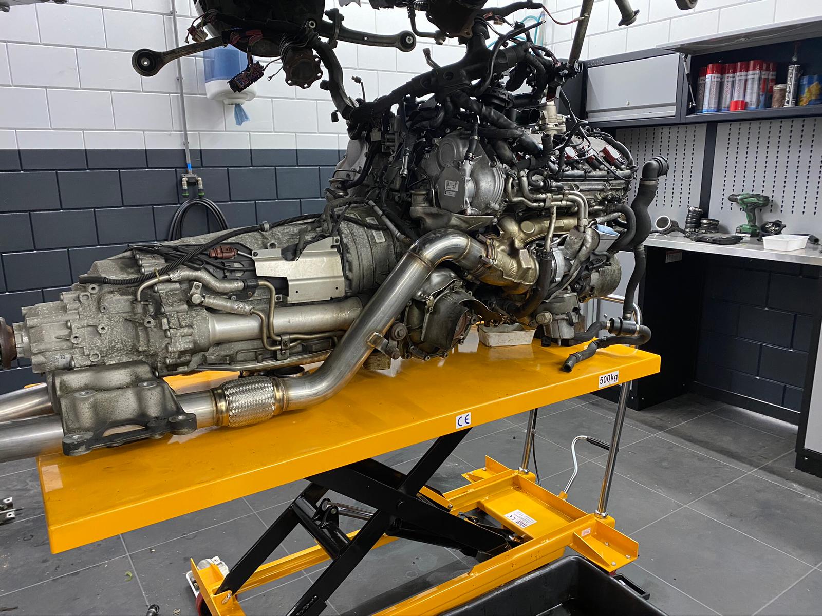

RS6EPE
Posts: 12
Joined: Thu Jul 08, 2021 9:30 am
Re: Shortly to be a new rs6 c6 owner
Post by RS6EPE » Mon Jul 26, 2021 6:01 pm
Some more (always fun to look at)
