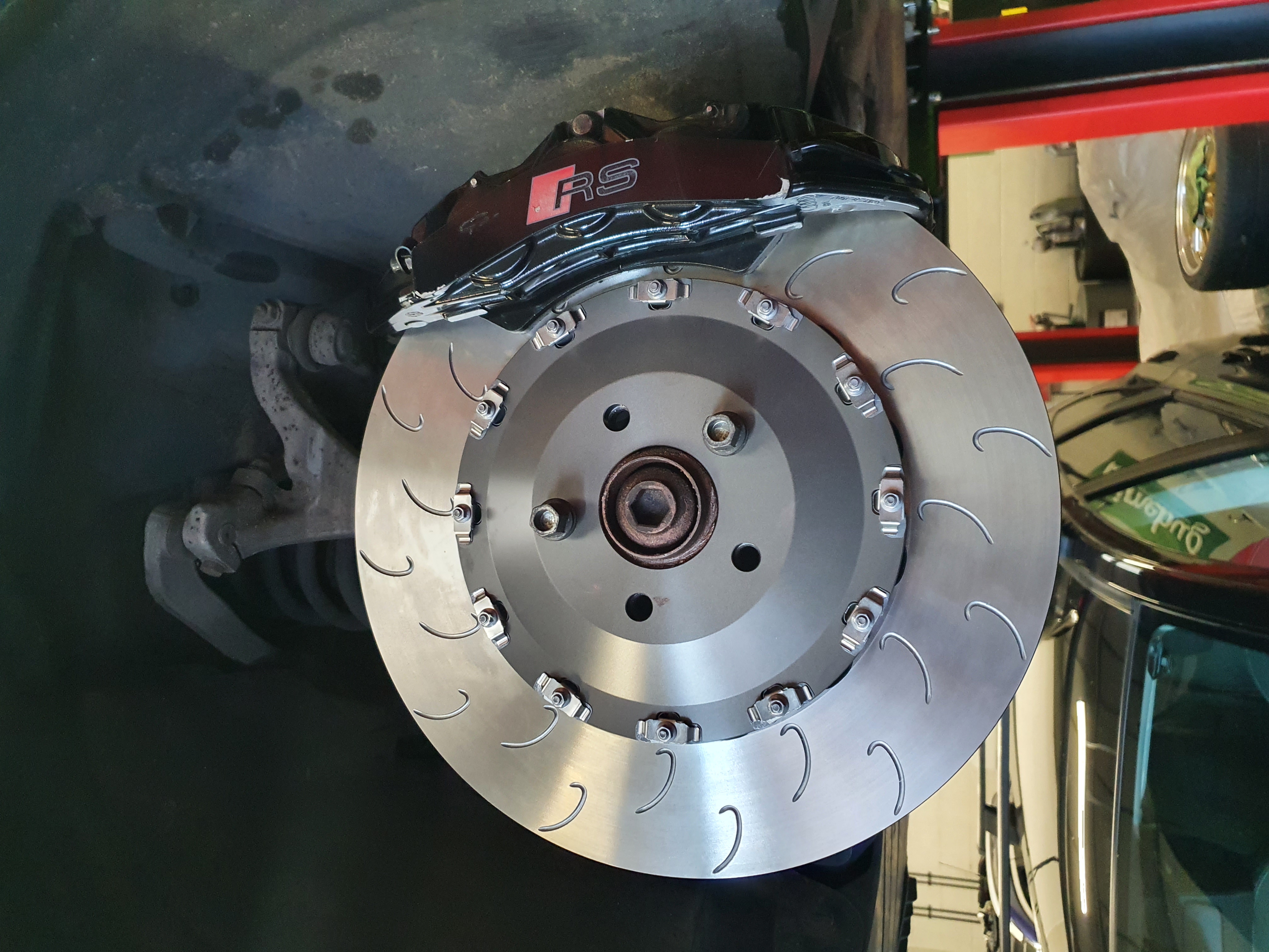

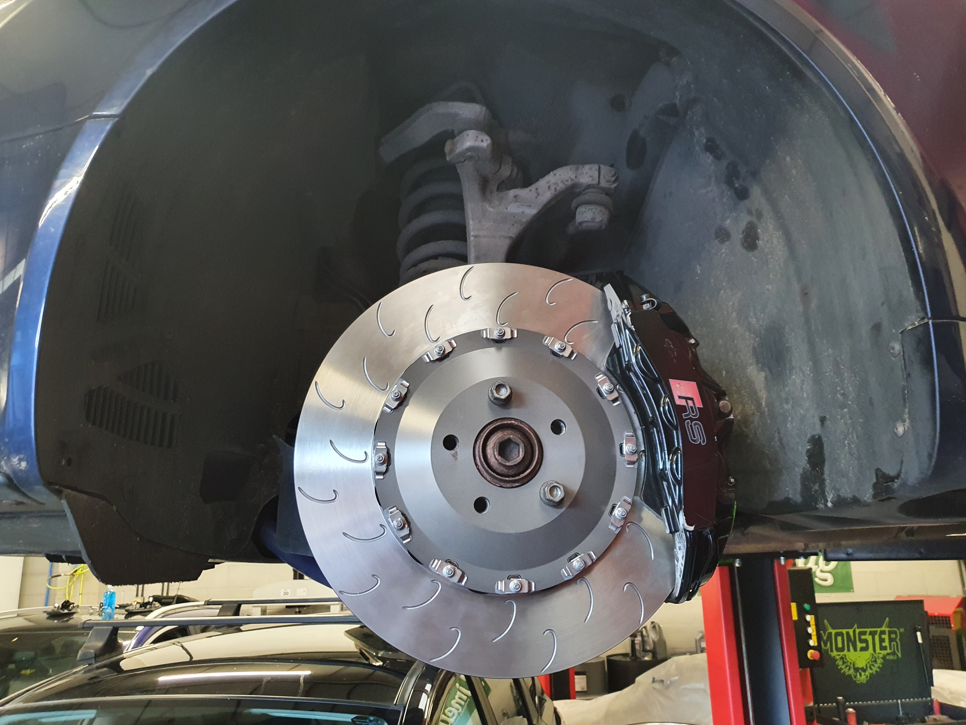

don0301 wrote:
What size are they ?
Sent from my SM-T580 using Tapatalk
don0301
Posts: 770
Joined: Wed Aug 13, 2014 3:39 pm
Re: New brakes
Post by don0301 » Sat Dec 05, 2020 7:04 pm

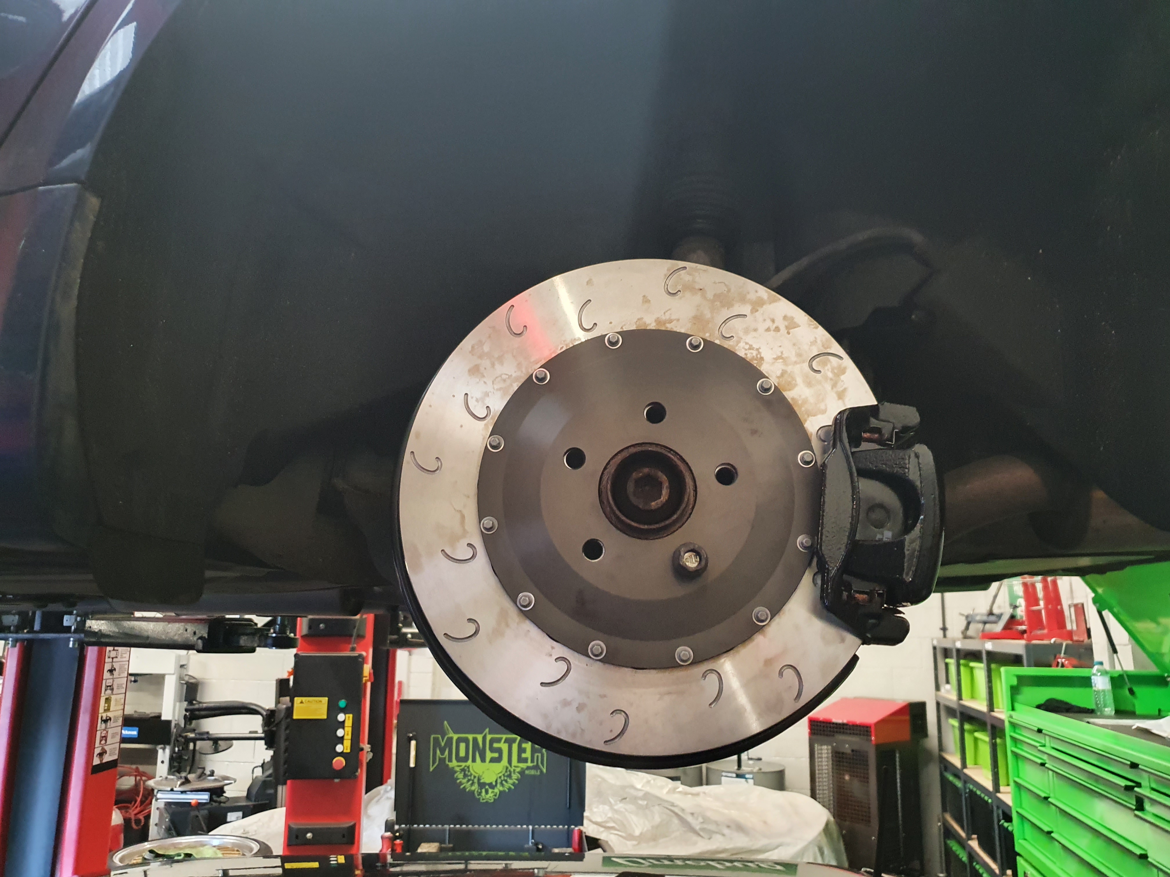

410 fronts, and OE size rears

don0301 wrote:410 fronts, and OE size rears
Do you get a bracket to move the caliper out with the kit ,or did you have to get that fabricated thanks Jon

Post by don0301 » Sat Dec 05, 2020 9:36 pm
all came as a kit, there are other threads about the kit, ianh755 made some threads.

Post by IanH755 » Sat Dec 05, 2020 10:12 pm
My thread used a different caliper by AP Racing so my particular bracket wouldn't fit the OEM caliper. However it's good to see that there's only a very small unswept area on the 410mm discs using the OEM caliper/pads, say 5mm at most, which means swapping from OEM isn't really necessary which is a bonus as the OEM Brembo calipers are bloody good!

Post by don0301 » Sat Dec 05, 2020 10:23 pm
yeah, mine's oem calipers and bracket, just slighter longer bolts in the kit.
pheaton mod back plate still fits, and no addition to my insurance.
well pleased.

I've just done almost exactly the same to mine;
410 front, 356 rear with brembo "H" floating discs, stock caliper but with spacers/longer bolts on the front to fit the 410mm discs
HEL lines,front and rear
Ferodo DS2500 pads
Phaeton mod
I noticed that your discs don't have a fixing screw to keep them attached to the hub, is this a pain when removing, refitting wheels

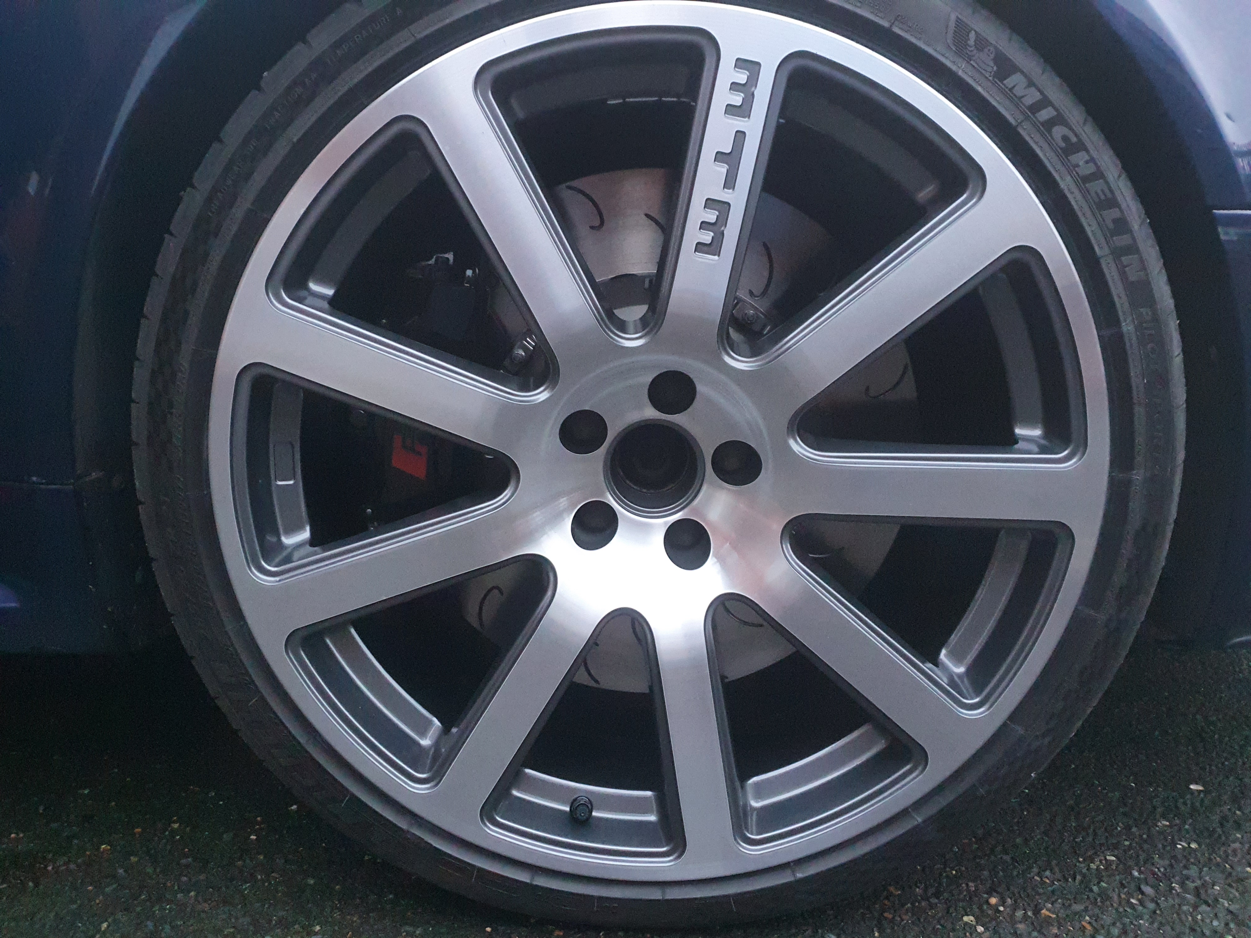

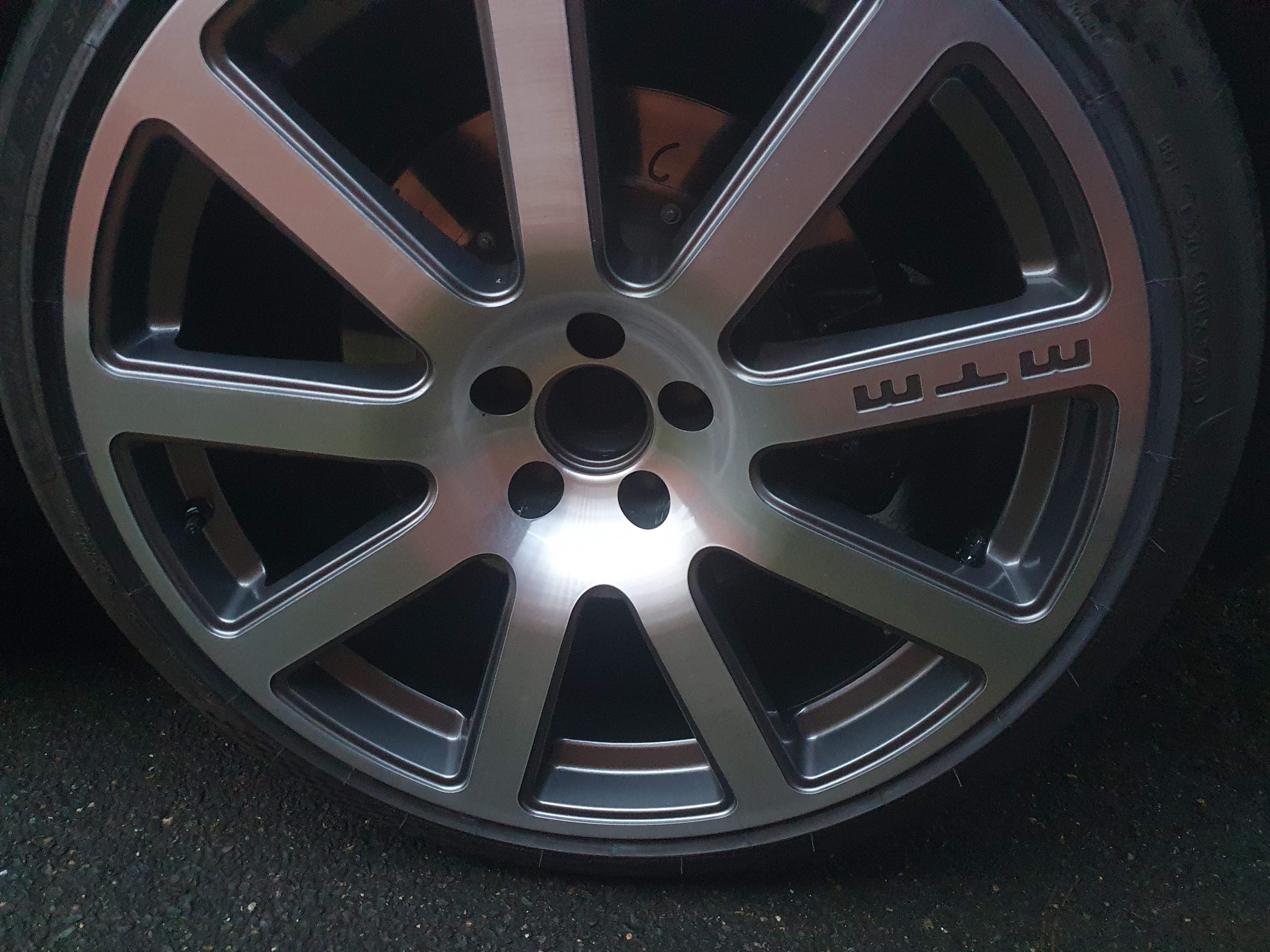

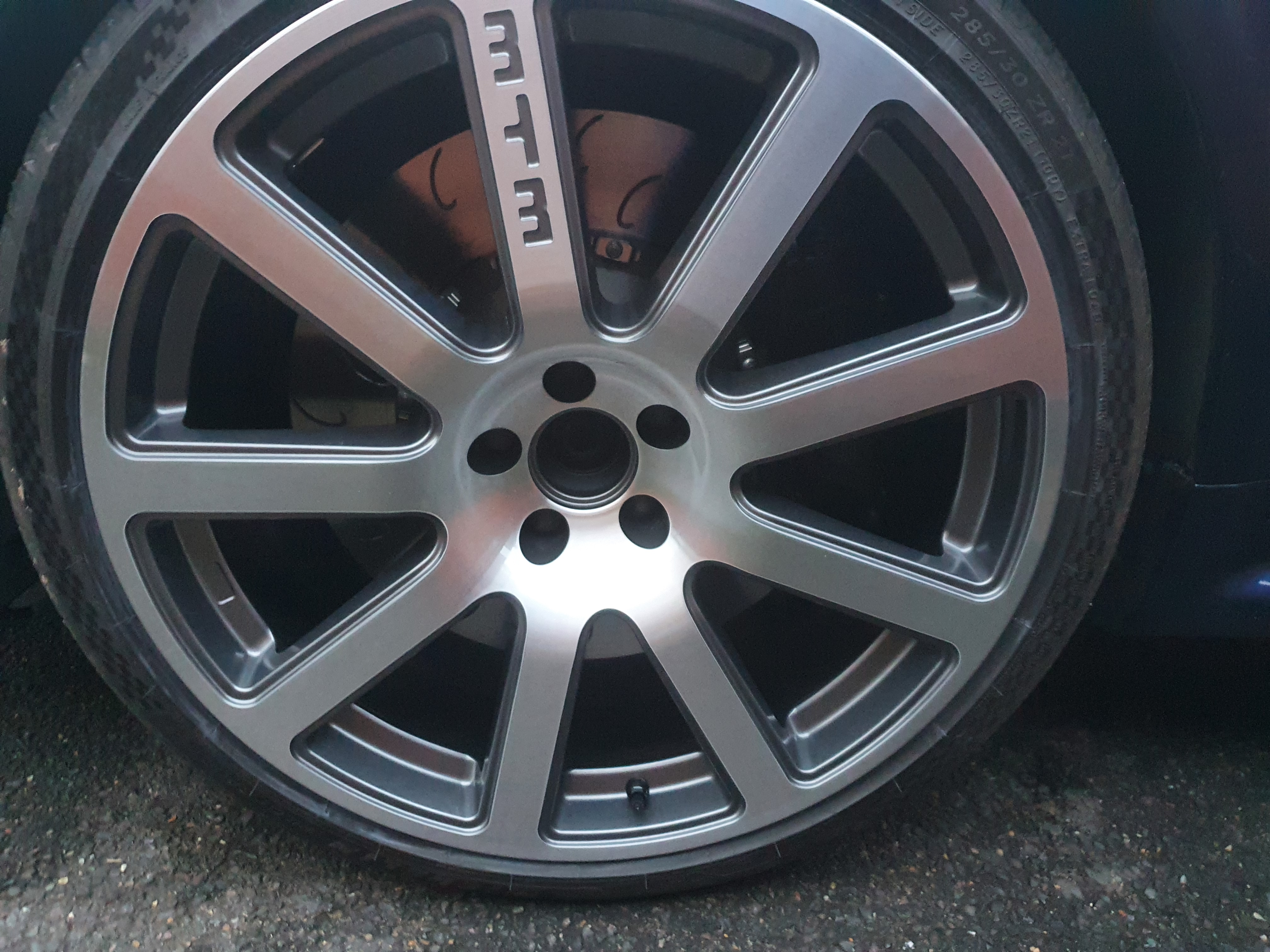

Post by don0301 » Thu Dec 10, 2020 5:23 pm

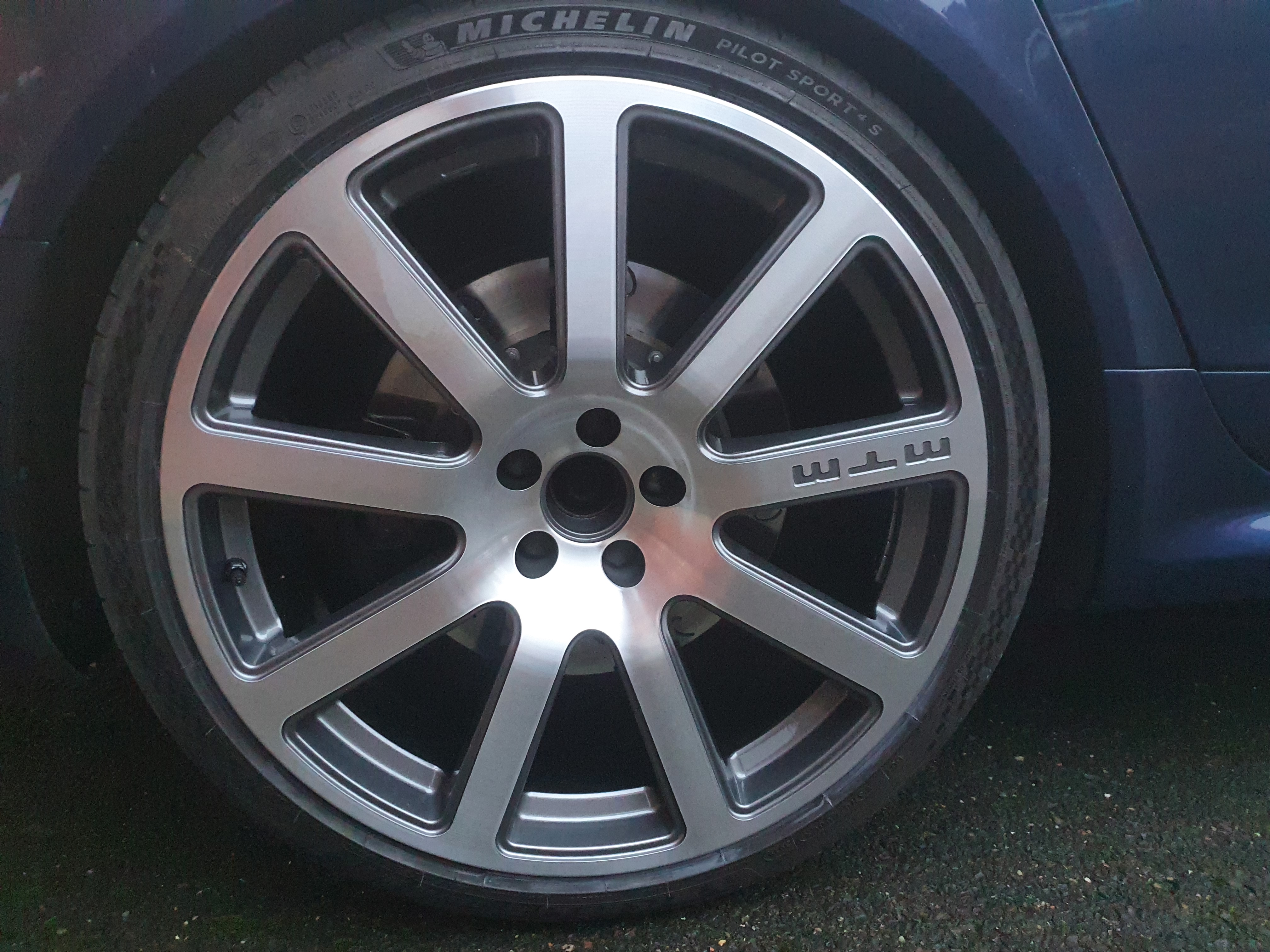

Car back, wheels done.
Just need new centre caps now

Post by IanH755 » Thu Dec 10, 2020 11:54 pm
Blimey, even 410mm discs look small behind those MTM alloys! :D
