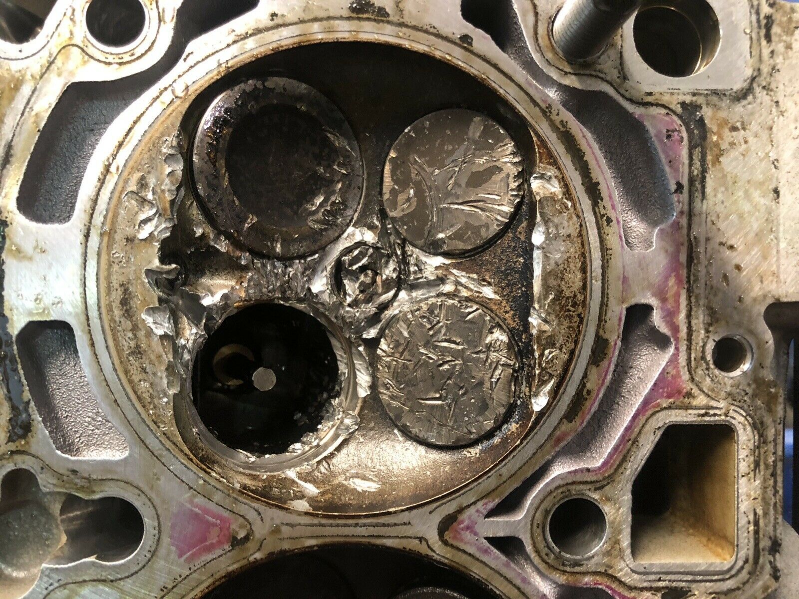

Re: How high can the V10 rev?
Until your valves bend
