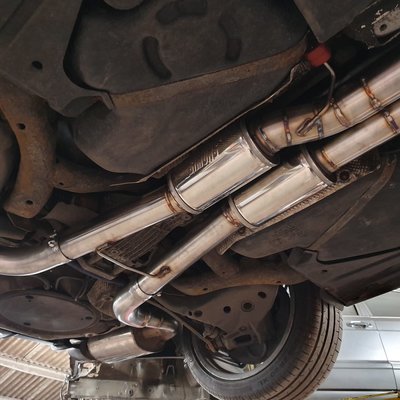

viewtopic.php?f=47&t=131533&start=15#p912321I should have results this week, unfortunately we had a hold up on the exhaust side of things.
I’ve went full 3.5” from the turbos back, I wanted to retain some level of quiet.
Opted for 5” silencers and the wrong size came, so we lost a couple of days waiting on new ones.
Exhaust is now finished and the car will be back at Mrc tomorrow for a week of testing and mapping.
As said TTEs rep suggests we should do 1000hp minimum especially with my spec.
My car ran 880ps and 1200nms on the 850’s on a mild map and 1008ps on race fuel. I’m hoping the new turbos do 1050+ps on 99 and upwards of 1150 on race.
I think the curve will move slightly to the right as it’s a bigger turbine wheel, I’m hoping we don’t lose too much spool as the 850’s were incredible in that sense.
Will post all findings good and bad throughout next week![]()

Cats are gone mate, dyno chart is on Mrc Facebook page I don’t have a copy on my phone. Car was stupidly fast on the 850’s, mid to top end was mind blowingly fast for such a big car
You won’t be able to release the full potential without doing the gearbox. Mrc are having a new dyno installed, dougs cleared a full two weeks to work on mines. The turbos aren’t doing what we expected hence there being delays with my figures, I’m also changing my exhaust spec to exactly what iainH has suggested. 3.5” into 3” with X pipe
