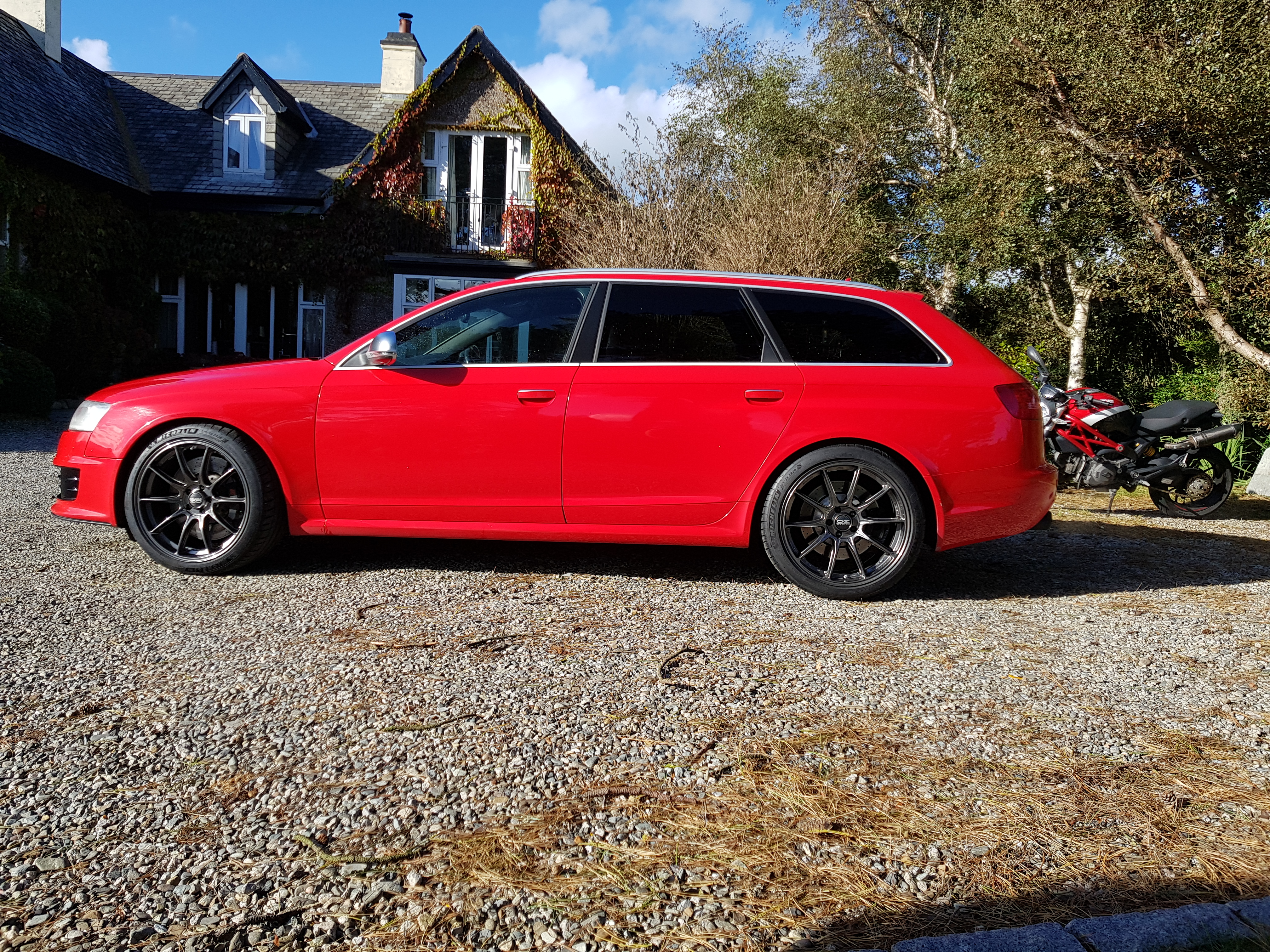

For 20 X 10 your ideal ET will be around 30-33, I think 42 will sit too far in the arch and possibly clip the strut
That's a set of 20x10 et32 with 275/35/20 Michelin, for whatever reason the tyres look bigger than the OEM tyres, but the wheels do look a little small, I'm happy with them though

Silver makes them pop, and that design the spokes meet the tyre were if you look at mine the lip which meets the tyre and the end of the spoke are a few mm apart giving the illusion they're smaller
They do look good on yours! How do you rate the Ultrac Vorti? I'm a huge fan of Vreds myself but wanted to see what Mich's were like
