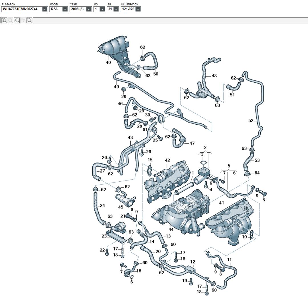

i'm in the process of setting up my mini to-do list as part of RS's overall maintenance. Something i'd like to get some indication is the cost of replacement parts / labour involved re coolant lines. Here is the image that I got from TPS and was wondering can you confirm which part/s will need replacing please?

If you mean THE coolant pipes (the ones under the wheel arch), they're parts 4F0121169 & 4F0819278A, which because the image isn't true to life are parts (I think) 46 (4F0121169) and 49 (4F0819278A). They cost approx £40 and £150 if I recall correctly.
Labour charges depend on who does the job, how they do the job and whether they've done it before.
The short pipe is easy(ish) and is pretty much a case of removing the wheel and arch liner then disconnecting two hose clips and a nut.
The long one is much more involved and 99% of the time the act of removing the short pipe will force replacement of the long one.

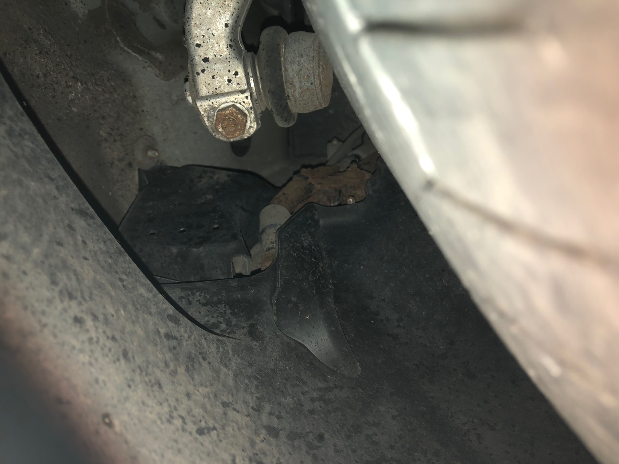

Only thing I can think of at the moment is a bit of housekeeping inside the body where the pipes and steering arms run. Mine had a concretion of gravel and road dust in there that was so deep that the brake lines in there were buried.
I took a close on a kg out of there when I cleaned both sides.

Post by Jim Haseltine » Mon Jun 25, 2018 6:49 pm
Mine were worse than that but didn't appear to be too bad at first sight then the act of removing the sight tank hoses caused both of them to split.
