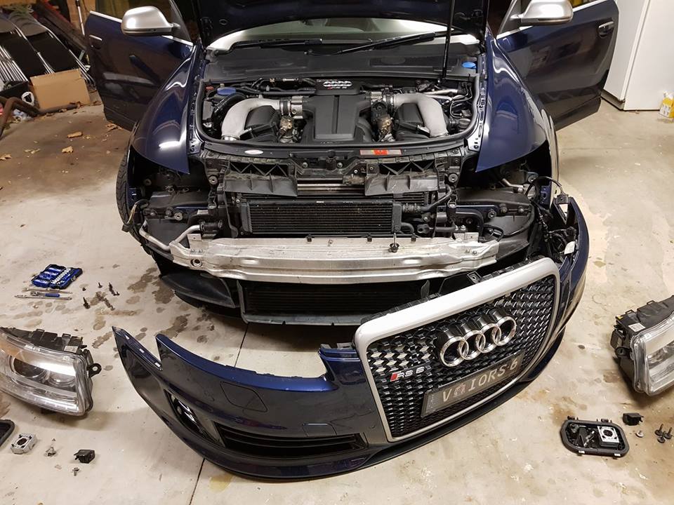

Re: RS6 Headlight bulbs / Dipped Headlight ?
Post by CHEQUERED » Tue May 08, 2018 4:09 am
Fun TImes, Definitely D2S not D3s lol
But not too bad in the end 35mins at home in the shed with limited tools.

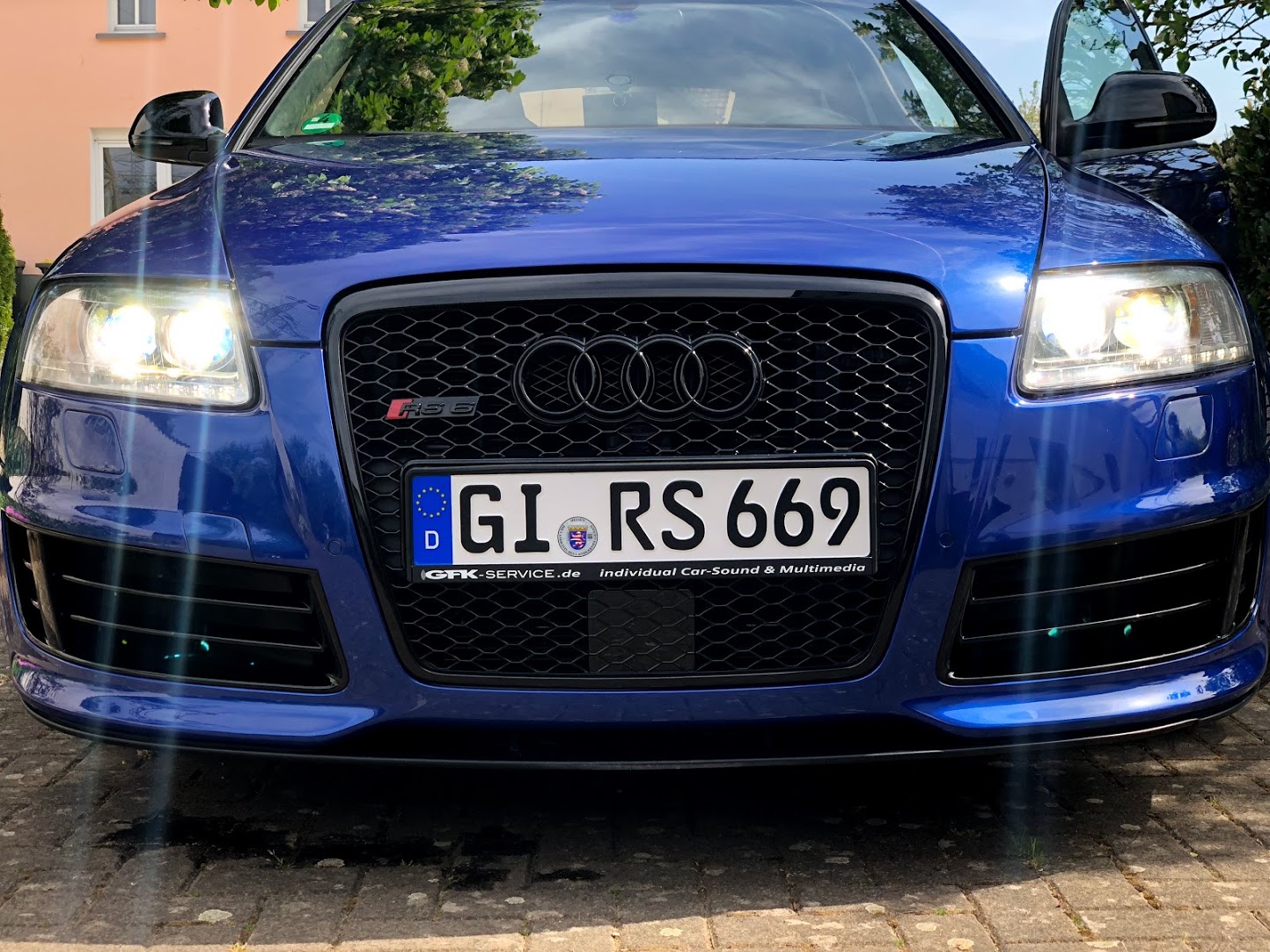

"Trups" is a member on this forum who has an automotive lighting company which custom makes extremely high quality interior and exterior lighting for the RS6.
His most popular creation is a set of uprated headlights which, having got a set, I can honestly say are amazing (if they were rubbish I'd be honest and say that) and the options he has for how customised you want your headlights to be are extremely wide and varied. For example, I wanted mine to look virtually OEM but converted to Quad Xenon so you have 4 lights instead of 2. I had the current inner set of "fog lights" removed and a custom set of xenon lights added (original headlights vs Trups headlights) while others have gone to the other extreme and had black internal backgrounds, RS6 etched into the lens and "sweeping" indicators added etc.

Agree with Ian, the Trups headlight conversion is well worth doing, especially if doing a lot of night driving, makes a hell of a difference. Great work, professionally done and can be catered to budget too.
