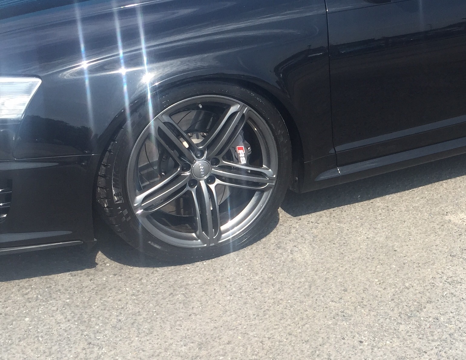

A20LEE
Posts: 931
Location: Leeds
Re: Replacement brake discs
Post by A20LEE » Thu Jul 06, 2017 1:47 pm
My fronts

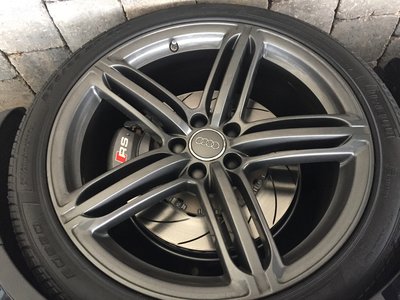

A20LEE
Posts: 931
Location: Leeds
Post by A20LEE » Thu Jul 06, 2017 1:50 pm
Rears

A20LEE wrote:My fronts
What wheel colour is that? Looks ace!
2007 RS4 B7 Avant
A20LEE
Posts: 931
Location: Leeds
Post by A20LEE » Sat Aug 05, 2017 6:43 pm
FaisalJ wrote:
Sat Aug 05, 2017 12:36 pm
Audi Graphite, not sure of the code off the top of my head but i found it via a google search.
