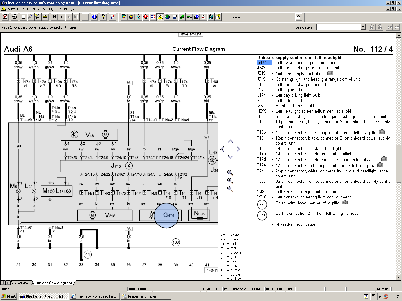

Unless the motor has a potentiometer like device inside it which varies resistance as it rotates, and could therefore tell the car what angle the light is facing. This could be compared with the steering angle sensor and could show up a fault that way if it isn't corresponding correctly. Do you know how many connections the motor has?
Re: Adaptive Light Defective - error
After having a quick look at ELSAWin (picture attached) it looks like it does have a position sensor (G474, which is highlighted in blue) for the swivel motor (V318), therefore the resistor method is unlikely to solve the problem as this sensor will need to correlate with other values (most likely the steering angle sensor). It seems that the only way to fix it is to get the motor working again whether that is by replacing the motor (which I think is only possible by having the headlight cluster apart) or most likely by replacing or repairing the wires that are almost definitely broken or by replacing the control module (J745) if it has failed.
