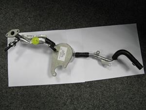

Audi South Africa told be it was the Oil Collector Part No. 07L 145 232 A
Oil collector.jpg (14.48 KiB) Viewed 2489 times
As the car only puffs blue smoke under initial throttle and then blows clean, and uses about 500ml of oil every 4,000km (2,500miles)
