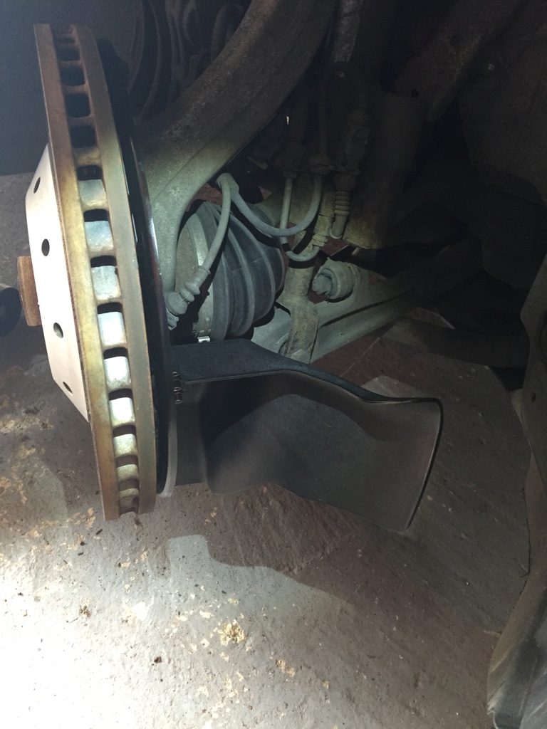

So I was looking at the phaeton brake duct mod for the rs4 back when I had the b7.
After cooking this brand new set of brakes at the ring a few weeks back I bought I'd look at the idea again - I couldn't see anyone who'd done it on the c6 so figured I'd just buy the bits and see what happens. :)

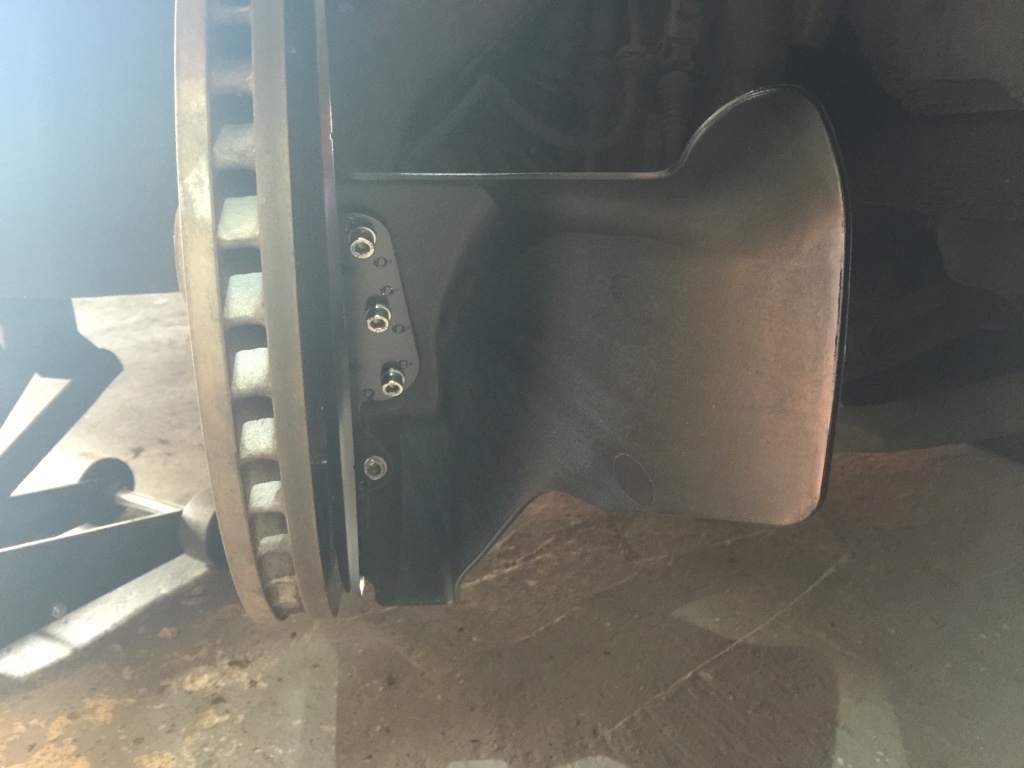

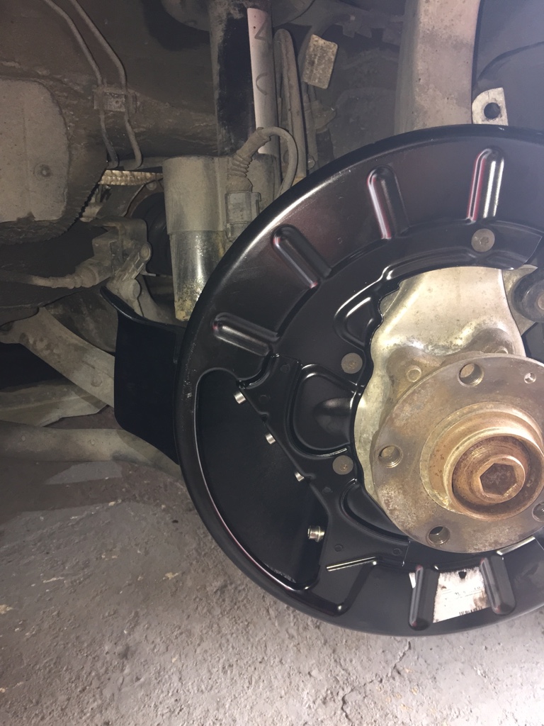

Turns out, not that big a deal. The back plates are a little smaller than the disc but there's no contact and the exposed bit of the disc is maybe 3-5mm at most so I'm really not bothered. The duct works as hoped and doesn't foul anything so a worthy improvement imo.
Job jobbed.

Good work Ross. Was it a straight bolt on affair?

Yeah. Unlike the rs4 which requires modding, these bolt on exactly as is, no modification required :) easy peasy.

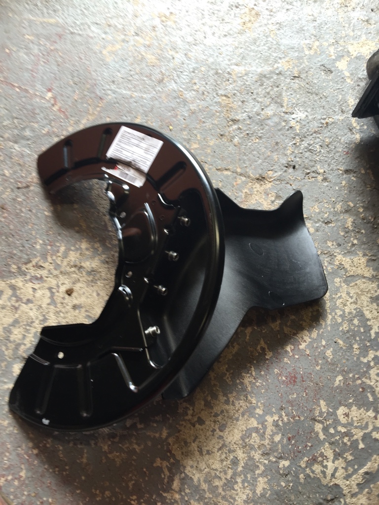

Sure. Prices are from my TPS account so may not be the same for everyone.
3D0 615 447 G
3D0 615 448 G
3D0 615 311 C
3D0 615 312 C
Edited to remove prices as parts price now MUCH higher from TPS :( It's now £115+vat to source these unfortunately.

Thanks - I didn't really do a proper write-up as it's honestly not a big job - if you're capable of taking a set of discs off, you can do this. They're a straight fit. I was expecting to need to modify them like you need to on the B7 but was pleasantly surprised :)
