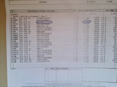

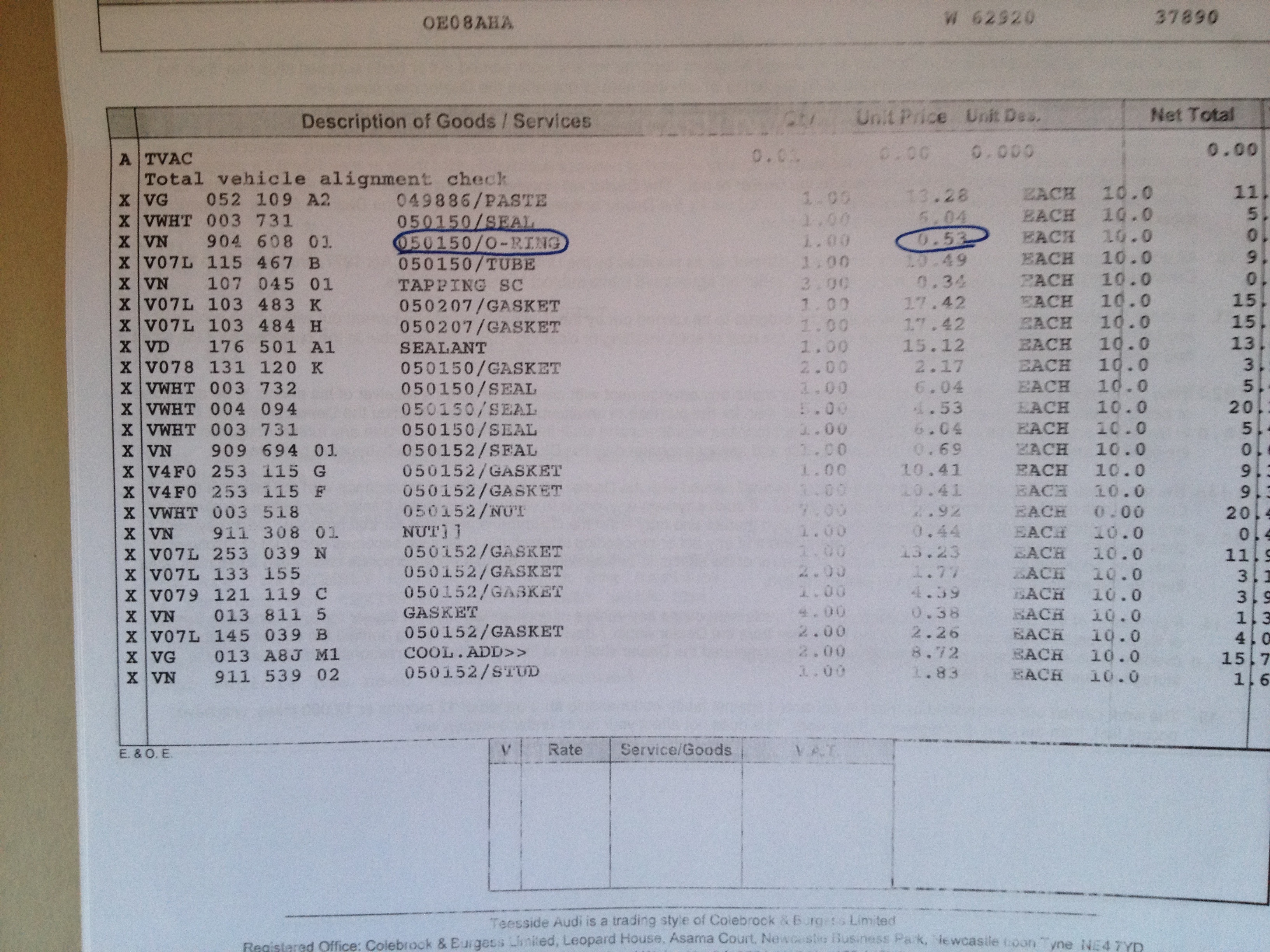

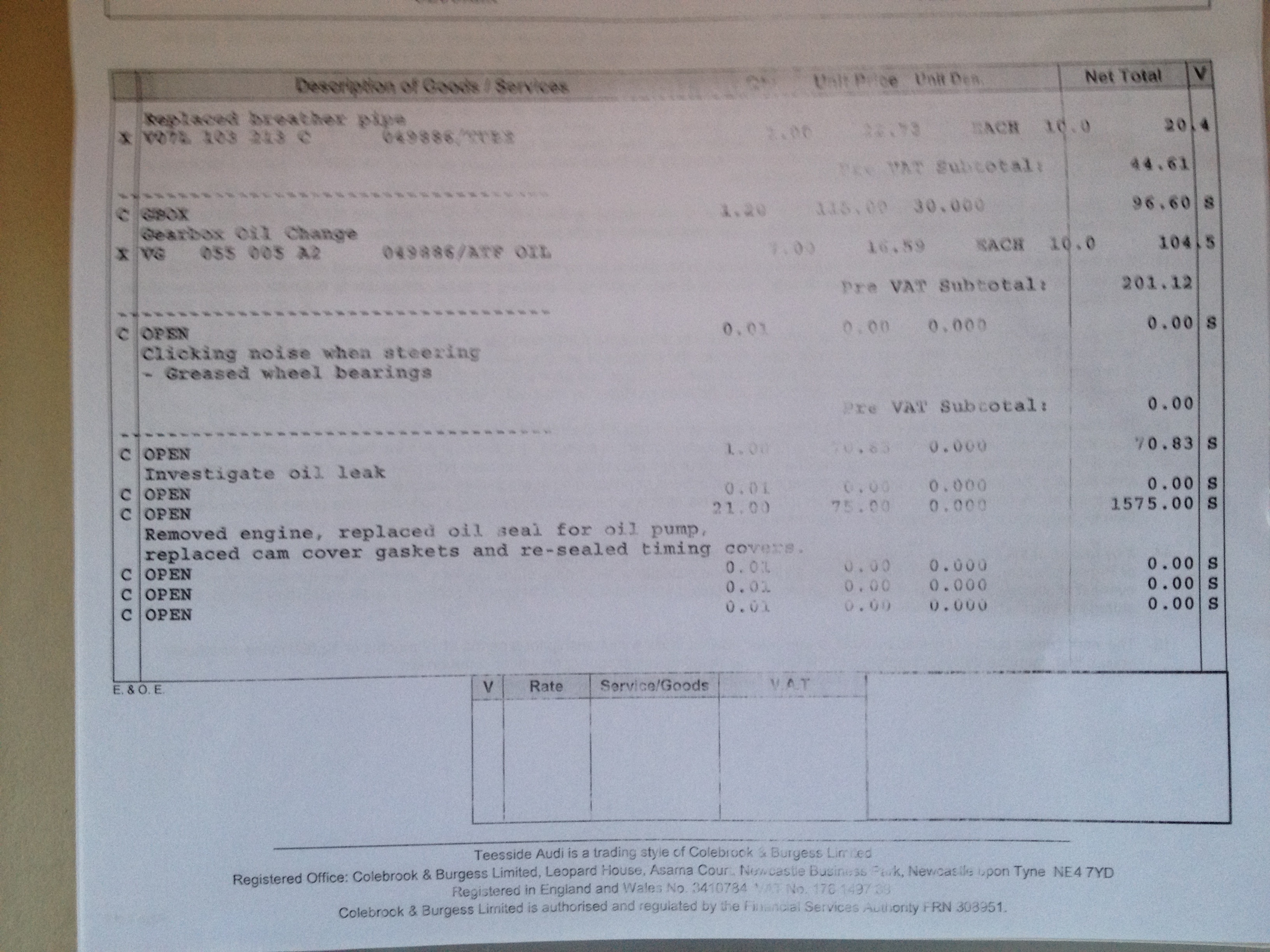

Well guys finally!!!
Car back over the moon.
Final work done as follows...
40k service
Spark plugs
ITG filters fitted(two days before service!)
Pollen filter etc etc
Gearbox oil changed
New front discs and pads
Also my issues as follows.....
Oil pump 0 ring replaced(engine out)
Both rocker cover gaskets changed
Timing chain gasket changed
As a bonus if you can call it a bonus...
4 wheel alignment done due to engine out.
New coolant in cooling system.
Air con recharged
(All down to engine being out)
Various clips and small pipes renewed as part of the job(free!)
Car running like a dream now...recommend gear box oil change shifts feel very smooth now.
Anyway my RS6 adventure continues!!! Still love the car to bits.
Sounds even better now too with filters in!!!
And my the way guess how much the 0 ring was that caused all this heartache??....
I've circled it on my pics!!!
Tech says old 0 ring was perished and had gone hard?...maybe an issue of the tremendous heat engine generates? Who knows?
Any questions just ask!!

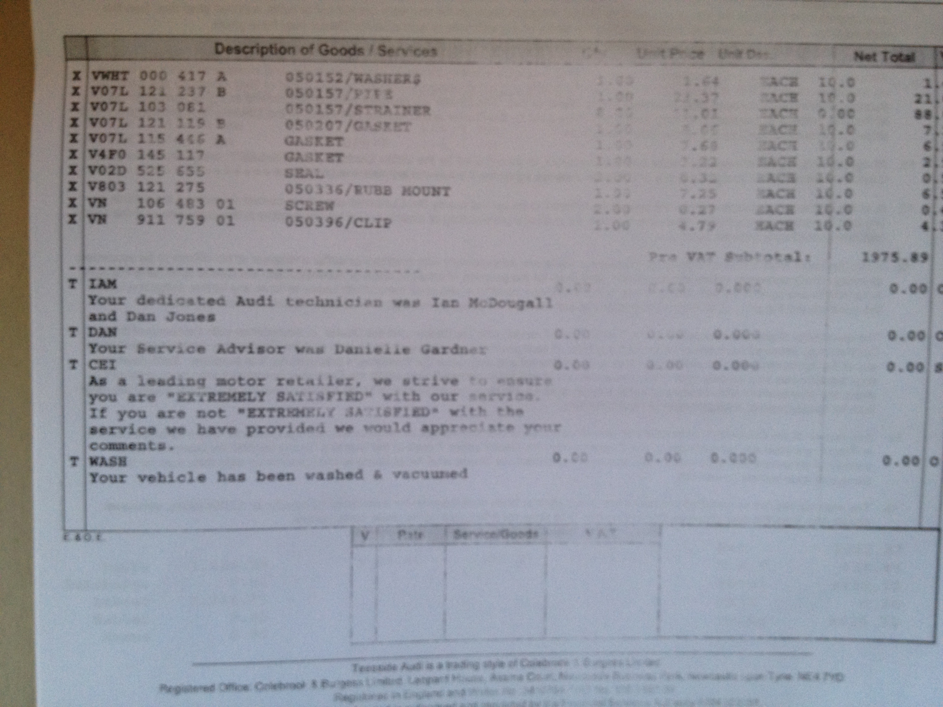

Re: 40k service items?(UPDATE NOT GOOD!)
Guess the cost of all this trouble!!

One more.
almost forgot....
They applied the special grease to my wheel bearings they "forgot" to apply last year when they replaced them!!!...
53p!!! LOL.
So what's the total cost, dare I ask.
