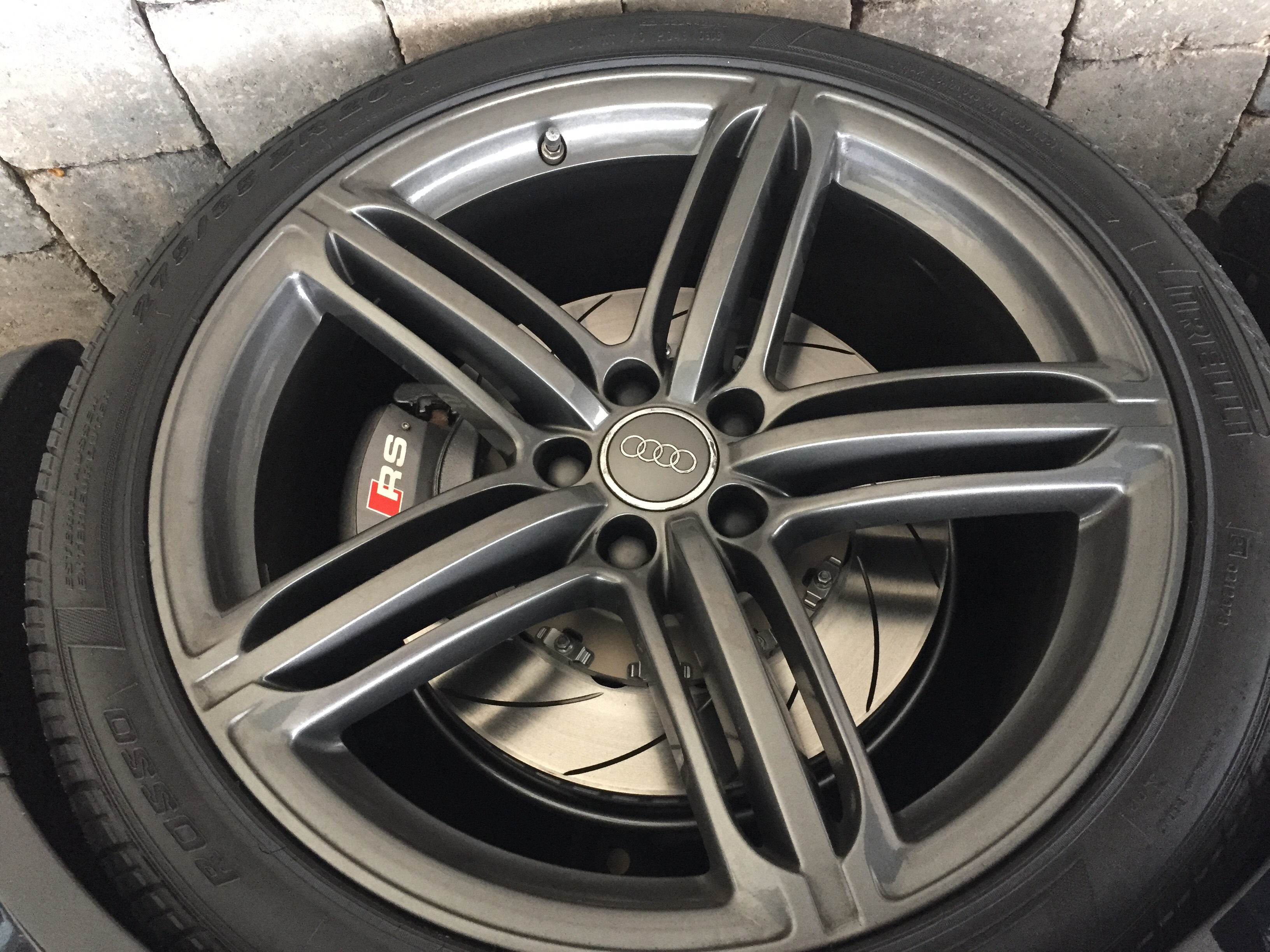

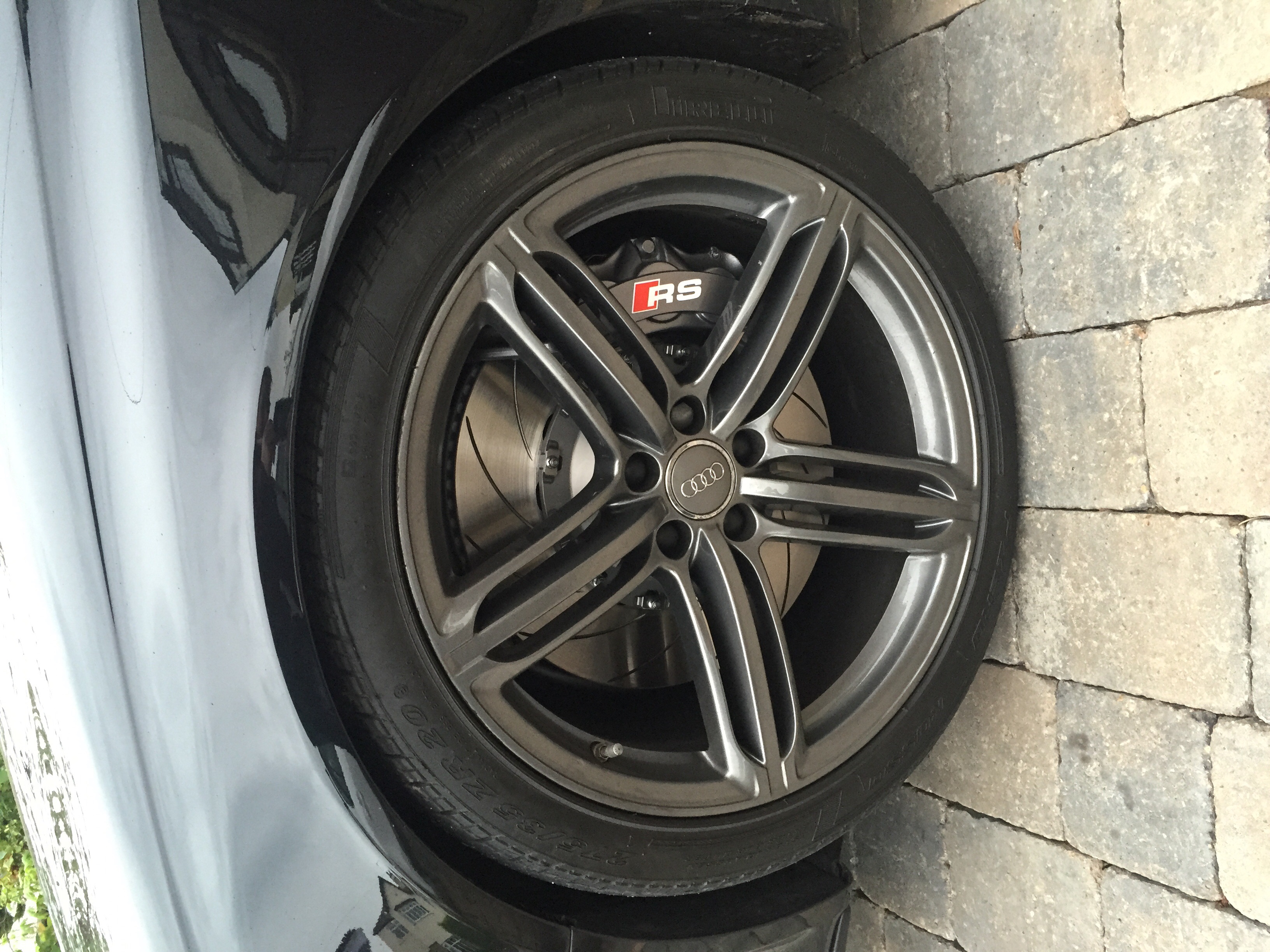

My AP Discs are on, slight issue with the rear which seem to be sticking a bit as they are getting hotter than the fronts. Hopefully that will be sorted tomorrow. HEL hoses, DS2500 pads and new colour coded back plates fitted too.

Hoses i'd say yes, the old ones are going to be in a bad way and the HEL look like they are designed with that in mind. Brake fluid was done last year at Unit20 so i'll replace it again with upgraded fluid next year. I also fitted the RS7 caliper plates at the rear, didnt use the factory fitting kit that requires drilling a 10mm hole, imdidn't feel comfortable with it and its effect on the strength of the caliper. The garage felt the same way also so i used stainless cap heads and a 3mm taped hole instead.
